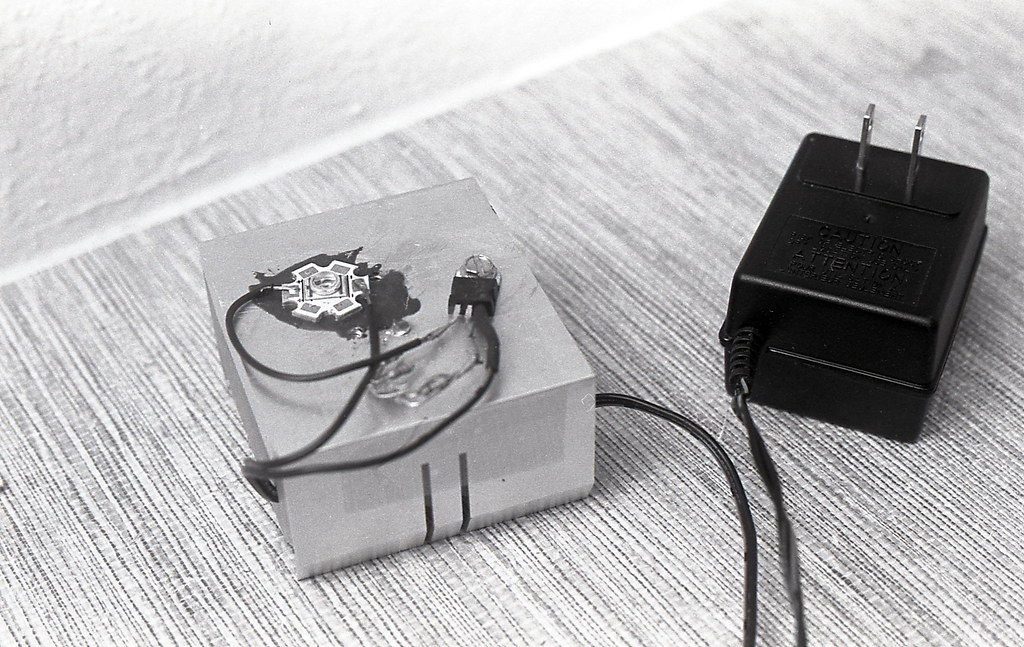

I may be repeating myself but I'm really love with LEDs and with a reason :D. They really don't practically produce wavelengths that would need to be filtered out. They are not perfect at all but every time I've tested leds with BW paper, I get much lower fog than with any commercial darkroom light I've tried. This may be because of filter fade present in the old units.

Make your own from red leds. They don't in practice produce wavelenghts shorter than yellow at all, so you are safe even without any filters. Filters can always fade etc.
If you want to be on super-safe side, use red leds with safelight filter :D.
This way you can use HUGE safelight levels, probably more than you even want.
I tested 625 nm 1-watt red leds (these: http://cgi.ebay.com/10-PC-1W-StrawH...emQQptZLH_DefaultDomain_0?hash=item3a4d73a9f1 ) adjusted to a level that gives an enormous light level never normally needed in darkroom, and still I needed at least 5-10 minutes to show any fog at all. One of these leds is enough for even a larger darkroom, or you can use multiple in many places dimmed down to safe levels. If you don't like wires, you can use them battery-operated since they draw so low current. You won't probably use the whole 1-watt power. I used 600 mW in my test and it was more than ever needed.

See, this is where people are missing the point of LEDs. They do not have and do not require a filter; because of the nature of how they work, they produce a very very narrow spectrum. An incandescent bulb is the opposite, in that it produces broad-spectrum (black-body) radiation, which includes significant components at higher frequencies that must be filtered, and no filtering is perfect. Filters also typically degrade when they're absorbing photons, hence their replacement schedule. Without a filter, the LED will keep working (and not fogging paper) practically forever - their half-brightness lifetime is often on the order of 50,000 hours (they will be half as bright after 6 years of 24x7 use).
An LED works by exciting atoms in a semiconductor (raising an electron to a higher energy level) and then when the electron falls back down to its default level, a photon is emitted. The wavelength of a photon is defined by the energy that went into it, therefore specifying what the LED is made of (specifically, the differences between energy levels in the material) will specify the wavelength(s) produced.
It takes a certain minimum amount of energy in one photon to activate a silver halide molecule and form a latent image - any photon of insufficient energy (too red) will just get absorbed as heat or be reflected. It's practically the same process as what happens in an LED but in reverse.
Your garden-variety red LED has a particular band-gap between its electron energy levels. This energy is smaller than the activation energy of a silver halide molecule in photographic paper[1], therefore none of the photons from a red LED can fog the paper. You could leave the LED on in your paper safe for a week and the paper wouldn't fog.
If you filter an incandescent light, you might lose 50% of the red photons and get rid of 99.9% of the blue/green/UV ones. But that just means that fogging is 1000x slower than it would be with an unexposed bulb, which is still not particularly slow.
In terms of a solution for a non-electronics-nerd, a $20 off-the-shelf LED safelight is an easy and reliable option. It will probably never wear out in your lifetime. I also like the bike-light idea - they're cheap and ubiquitous, though buying a new set of AAs every 30 hours will add up - nothing like paper costs, but certainly more than $20 for the mains-powered one over the years.

I use a 1W red Cree LED at about 200mA for a small darkroom. Brightness can be very good with no fogging at all. The proper way to drive an LED is with a constant current source; using resistors is rather crude.
http://www.dealextreme.com/details.dx/sku.1776
making a constant current source
