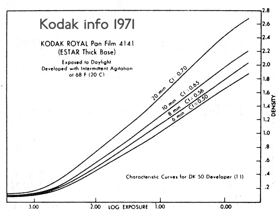

Sandy: sorry I haven't read your review. Does it print Palladium OK ?
For Trivia buffs, here's a 1971 curve of good old Royal Pan.
