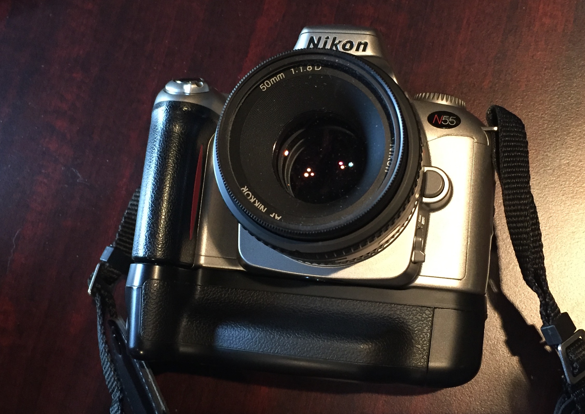

The Nikon N55.
These cameras can be had for very little money. I got one for $7 from KEH and another for very little (shout out to user "multivoiced" as an excellent and safe seller!!)
The N55 was the bottom of the line for Nikon's F-mount AF cameras.
So...how bad is it...

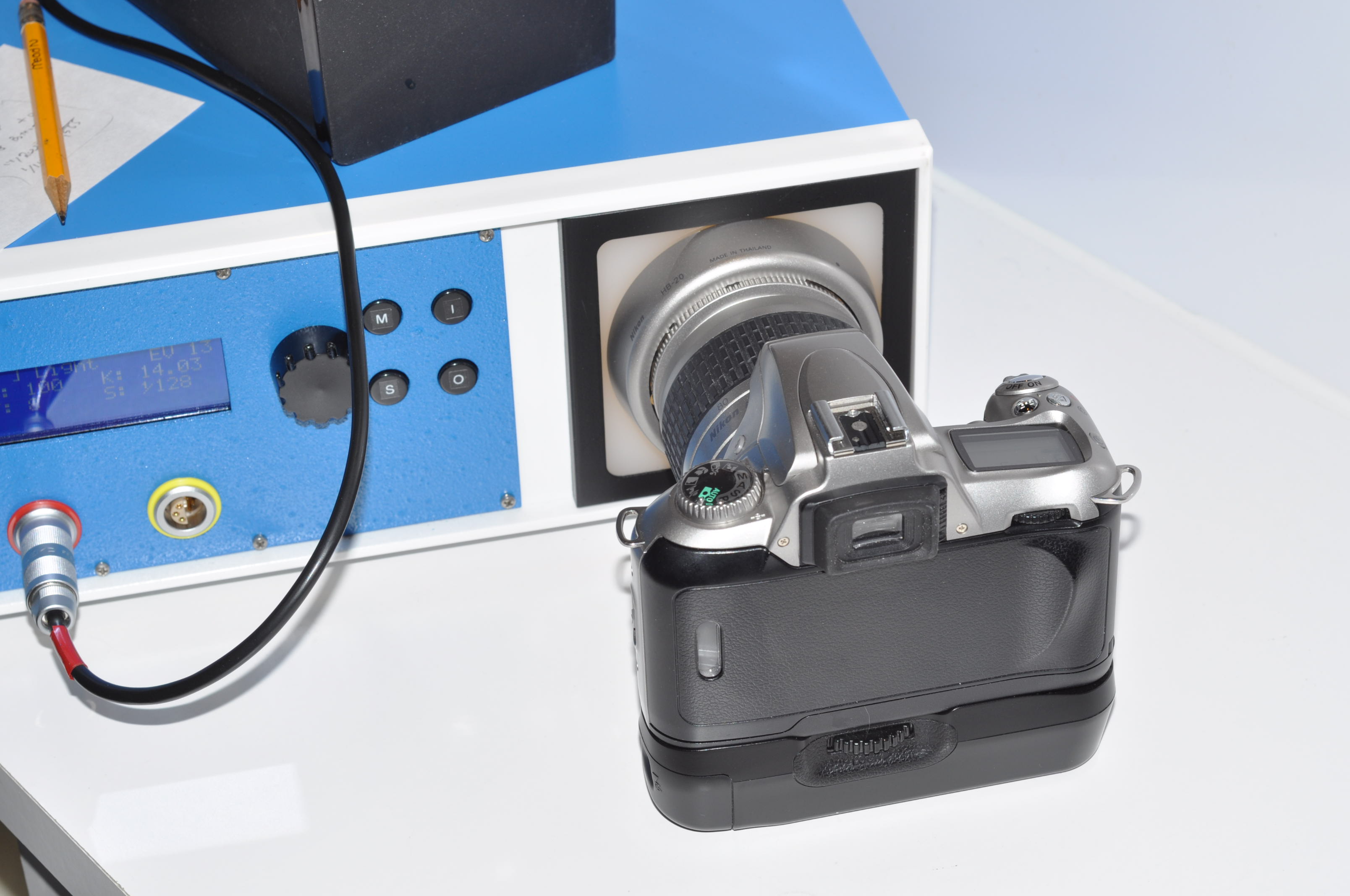

First a test of the meter. Using a calibrated light source.
The indicator in the viewfinder is in one-half stops.
So, within a half-stop, every EV from 6 to 14 measured exact by the viewfinder display.

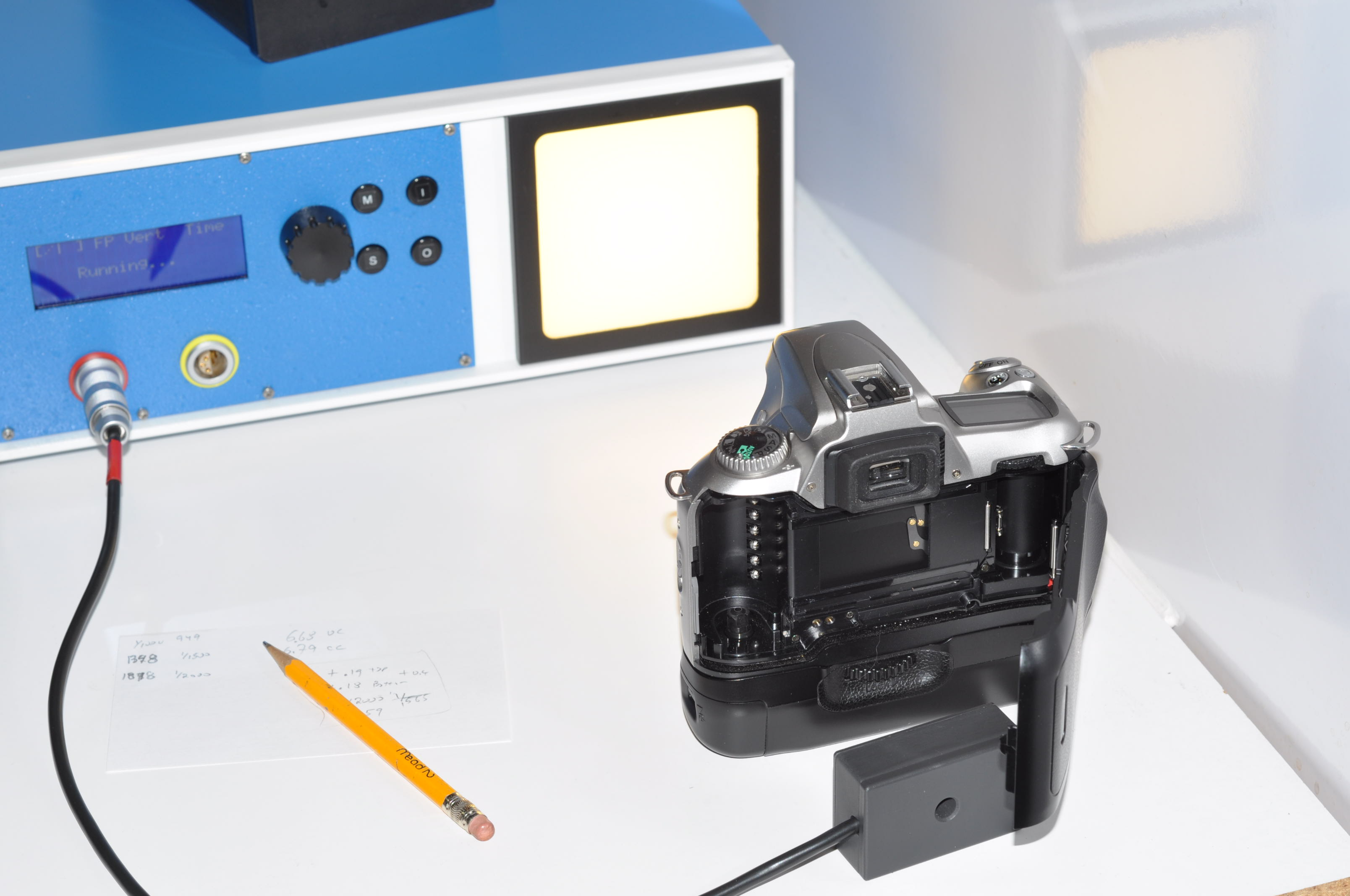

Shutter Test:
Nominal : Measured : EV Error
1/2048 = 1/1955 = +0.1
1/1024 = 1/979 = +0.1
1/512 = 1/507 = 0
1/254 = 1/260 = 0
1/128 = 1/129 = 0
1/64 = 1/65 = 0
1/32 = 1/32 = 0
1/16 = 1/16 = 0
1/8 = 1/8.1 = 0
1/4 = 1/4.1 = 0
1/2 = 1/2 = 0
1 = 0.99 = 0
All I can say is "Wow!"

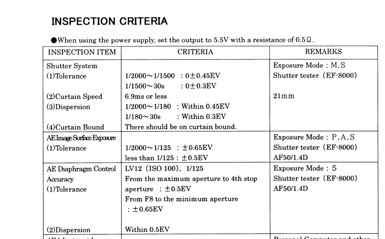

Do you know how to adjust this vertical focal plane shutter? Can this still be done by yourself?
All adjustments are done through software with a special computer interface. Nothing that can be done with a little screwdriver.
There is an adjustment (in the software) for:
1) Auto Exposure
2) Aperture
3) 1/2000 shutter speed
4) TTL flash adjustment
5) Battery check adjustment
From what I can tell, the camera checks the shutter speed itself and adjusts accordingly as you use it.
I suspect people that have the software and interface are still actively repairing cameras to make a living, so I'll just let it be at that. None of the software is available to the hobbyist at this time that I know of.

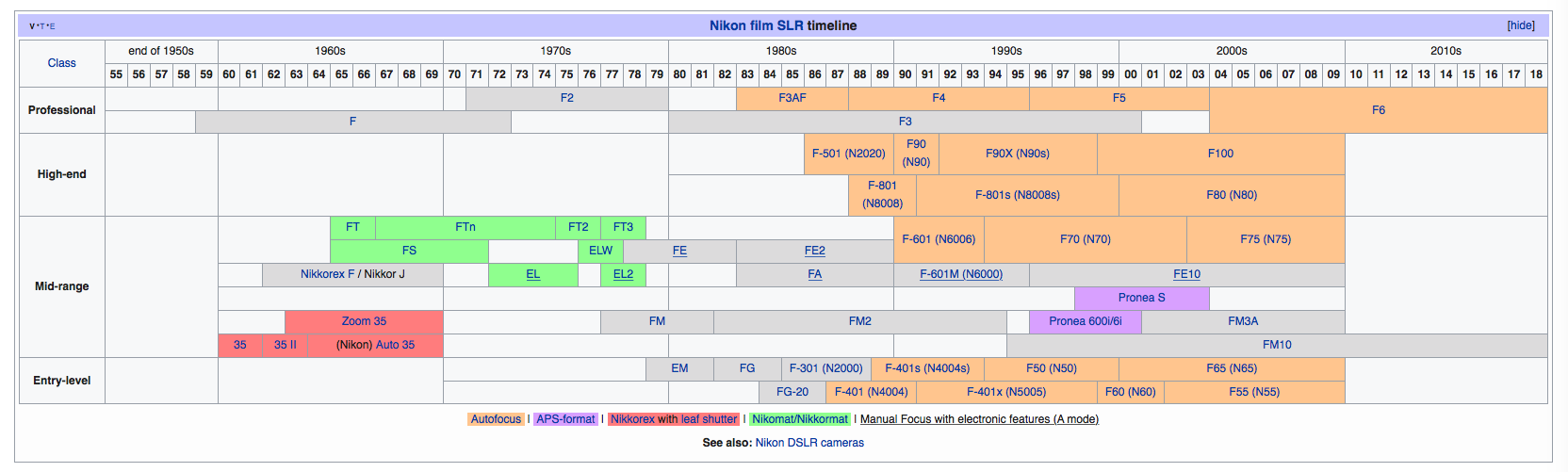

What Nikon did for the N55 to lower the price was to use a plastic lens mount and remove add-on TTL flash function and other things like that. The meter, shutter mechanism, AF etc. function as well as the best of Nikons other cameras.
According to this diagram from Wiki, the N55 was introuduced around 2002, with the only AF Nikon cameras newer than that being the N75 and F6.
It is not documented anywhere that I can find in Nikon literature, but the AA battery pack for the N75, is backward compatible with the N55.
