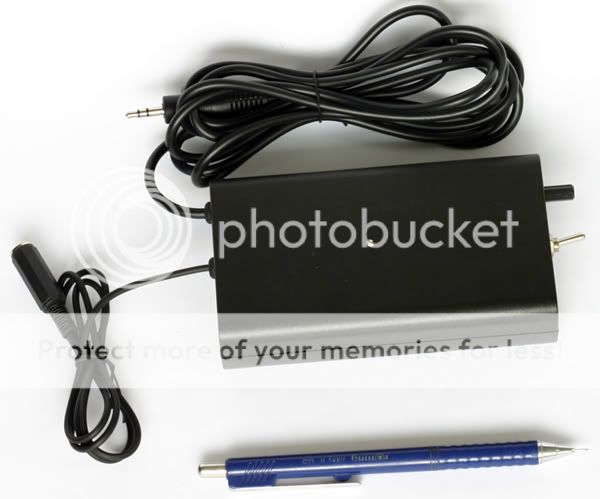

Hello,
The shutter testers are built by me. Every shutter tester will be tested before shipping.
1. The 1/1000th of a second box shutter tester:
- You will receive an Audacity file containing a test done at 1/1000th of a second with the actual shutter you bought.
- No loose wires. Everything is soldered onto a board.
- The cable is plug and play to allow you to extend it as much as you want and to prevent accidents in case someone trips over it.
- No battery and no maintenance needed! The tester works just like an electret microphone (a microphone that does not need a power supply). Works on all PCs. Will not work on some Apple computers like the Mac Book Pro.
- Detailed 12 page PDF english manual.
- Very small and easy to use.
- Needs a computer with a sound card and an audio editor for recording. I recommend Audacity because it's free, portable and easy to use. Also, this is the software used in the manual.
- Link with a screen shot of a 1/1000th of a second test in Audacity. (click here)

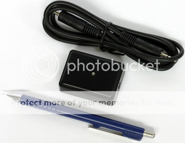

2. The 1/1000th of a second cable shutter tester:
- You will receive an email with an Audacity file containing a test done at 1/1000th of a second with the actual shutter tester that you bought.
- No loose wires.
- 2.5 meter cable.
- The cable is plug and play. You can extend it as much as you want with an extension cord.
- No battery and no maintenance needed! The tester works just like an electret microphone (a microphone that does not need a power supply). Will not work on some Apple computers like the Mac Book Pro.
- Excellent for cameras with bellows, TLRs and other cameras that have the shutter far from the edge of the back of the camera. By using a small tube you can place the tester as close to the shutter as you want.

4. The 1/2000th of a second LCD tester:
- The tester will do at least 1/2000th of a second. It was designed to perform at 1/8000th of a second but I have no means of testing over 1/2000th of a second. I have no doubt that it can measure well speeds above 1/2000th of a second.
- No need for a computer. It has a microchip that does all the measurements.
- The LCD has a back light that helps reading the values.
- Has an on/off and a reset button.
- Needs a 9 volt battery (included).
- Can be provided with the receiver mounted on the box instead of the cable.

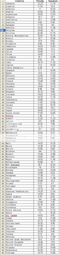

Shipping rates:
- All the prices are in euros. Because there is a character limit to a post I can't add a normal table so I added a photo. The host website reduced the size of the image. If you can't read it, PM me.
- If your country is not on the list, PM me.

I've had an inquiry trough the PM about the shipping prices and I realized that I completely forgot this part.
Shipping is calculated in 1kg increments. That means that if I ship 10 grams or 1000 grams, the price is the same.
I can send the receipts to show that I am not inflating the prices.
Sadly there is nothing I can do about this. I have no control over the postal service.
I try to minimize the costs by giving accurate shipping for every country instead of slapping a flat fee that would cover the highest price and take some extra cash form the lower prices.
There are 2 good news about this sad and expensive situation:
- You get a tracking code for either shipping option you choose.
- If you plan a group buy with some friends shipping will remain the same. The 1/1000 testers weigh about 100 grams. That means you can get up to 10 and pay no extra shipping cost. The 1/2000th tester weighs under 300 grams and the LCD one weighs around 400 grams (batteries included).
Sending it trough post as a letter in an envelope is not possible. The postal service rules state that anything else except paper is considered a parcel. All envelopes are checked by the postal clerks.
This is the cheapest option by far. DHL wanted 120 euros to ship a tester to Sweden. :smile:

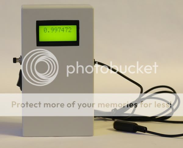

How do you know what tolerance in percentage of the marked speeds + or - is within tolerance ?, what is the acceptable margin of error, because unless you know this my training as a test engineer tells me that the digital readout is just numbers, so if the the marked speed is 1/500sec and the tester reads 1/410 sec is it within tolerance ?
I don't think I understood your question right so if my answer is different please ask again.
If the tolerance you are talking about is the shutter tolerance than this depends on the shutter type and manufacturer. Some old Compur shutters have a tolerance of 30% (given by the manufacturer). This means that if you take a photo with an exposure of 1 second, everything between 0.7 and 1.3 seconds is within spec. To find the tolerance you need a service manual for the shutter.
The LCD tester in the photo displays only a number. That's the time in seconds the shutter is open. In that photo a 1 second test was done.
So in the 0.997472 test the shutter is 0.002528 seconds faster than the 1 second desired time.
Now let's say you do a test at 1/1000th of a second and you get a reading of 0.001173. This means your tester is running at a speed of 1/852. Now depending on your shutter you might have to fix it or not. If you get a reading of 0.000972 your shutter is running at a speed of 1/1028. If you get a reading of 0.001 than your shutter is running at 1/1000th of a second.
The tester in the photo does not display the 1/852 speed but I plan to change this and have the time on the first row and the camera time in the 1/value format on the second row.
A display of "+17%" or "-17%" that displays the error in percentage is a tricky thing to do because the tester does not know you want to do a test at a speed of 1/125 and after that you want to do a test at 1/500. To do this you have to tell the tester the theoretical speed you are testing your camera at so the tester can calculate an error with your theoretical speed as a reference point. This would require major changes in the code and circuit board of the tester. It would also require multiple buttons that would allow the user to insert the theoretical value.
An easier way would be to have a rotating dial with speeds like 1/60, 1/90, 1/125, 1/250, 1/500 or whatever values you desire but in this case your error display in percentage would be limited to those values.
I could do this but I don't have the time to do it and I doubt many people would be willing to pay the extra price.

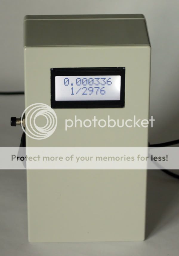

Hello,
I've made an upgrade to the LCD tester. It can measure speeds up to 1/4000th of a second and the shutter speed is now displayed in camera speed, too.
The pic below is with a test done at 1/3000th of a second with an electronically controlled focal plane shutter.
I've had the #4. The 1/2000th of a second LCD tester, for a bit over a year, and have been using it on most of my shutters during that time.
It's really quite simple: set the camera up in your darkroom or studio, on a tripod.
Opposite the camera, set up a light ( I use a portable light table, about 10" X 12"). I set it up at a distance of about eight (8) feet, but use your own judgement.
Focus the lens at infinity, directly and square to the light source.
Eliminate extraneous light; I use a big changing bag: I peek the lens through one of the sleeves, and wrap the bag around the camera, then enter through the unzipped bottom.
For a focal plane shutter, I use a small, light tripod behind the camera and with masking tape and a small stick ( I use tongue depressors) set the receptor at the centre of the shutter, about 1cm from the curtains.
Zip the changing bag up most of the way, leaving the wire to the "unit" run through the small opening.
Turn off all the lights in the room, except for the light source directly in front of the lens.
Set the shutter at 1/30, turn on the tester, and fire the shutter. Record the readings. Repeat three (3) times.
Set the shutter at 1/60, turn on the tester, and fire the shutter. Record the readings. Repeat three (3) times.
Set the shutter at 1/125, turn on the tester, and fire the shutter. Record the readings. Repeat three (3) times.
etc until the top speed has been tested.
Then, repeat the procedure, from the top speed ( repeating each test 3 times) until the bottom speed is reached (usually 1 sec.)
Then, repeat the procedure, from the bottom speed ( repeating each test 3 times) until the top speed is reached .
This will give you a good idea of the precision of the shutter, and a good judgement of how to adapt exposure at each shutter setting.
The test system is accurate. The test unit is accurate. :smile:
