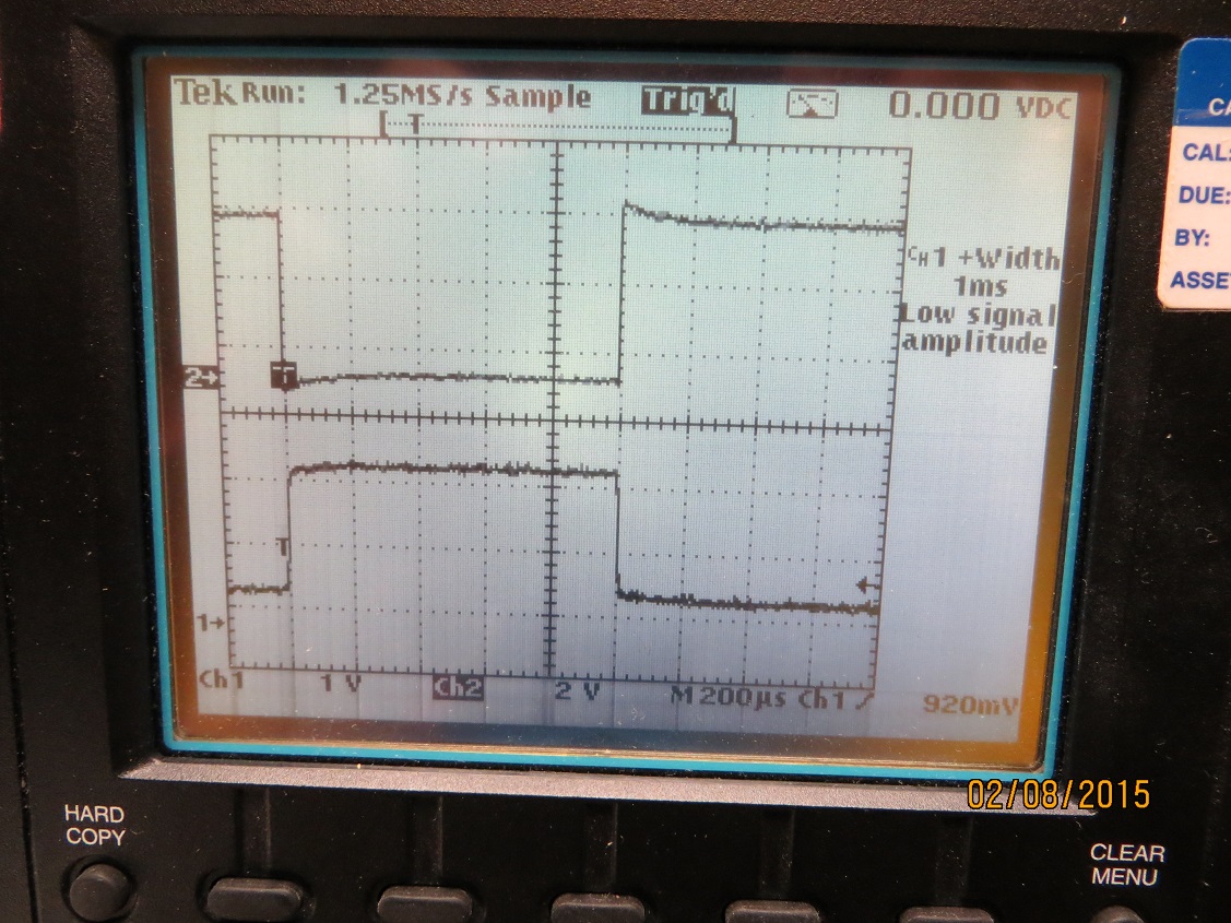

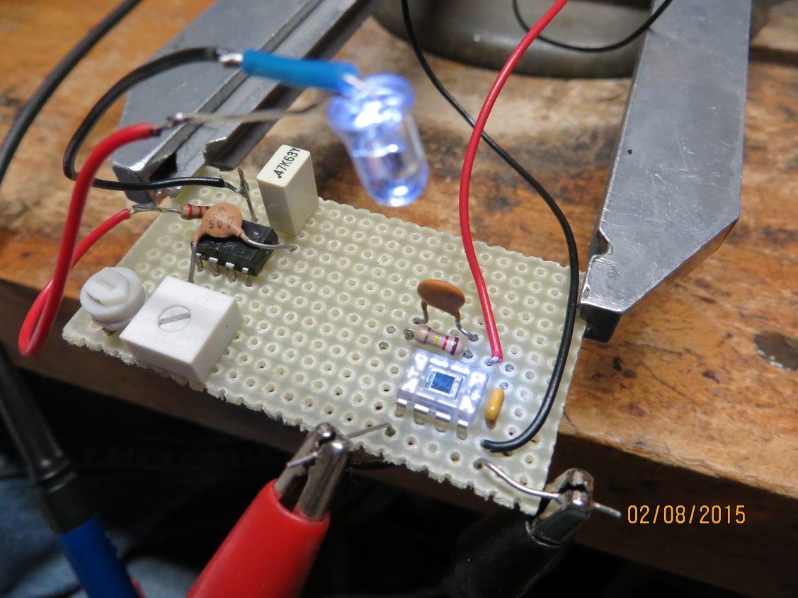

You can see the LED hovering over the detector in the lower right corner of the board. I set the LED to pulse at 1ms, which is 1/1000 sec. Here is an oscilloscope plot of the signals going in and coming out:
attachment.php
Explanation: the upper waveform shows the voltage driving the LED (light source) and the lower waveform shows the output of the detector. If you're not a techhie, I apologize, but this is how we electrically check the capability of the detector. You can see that the two waveforms are the same width, even though one is inverted. I ran a few more tests at higher speed and found that the detector follows the LED signal to within 5 microseconds, which is better than I thought it would be. It means that the detector has an error of 5/100,000 of a second. Great. I found out also that if the detector is blasted with a lot of light and it 'saturates'. the error grows to over 20 microseconds, but if the device is kept within its 'linear region.

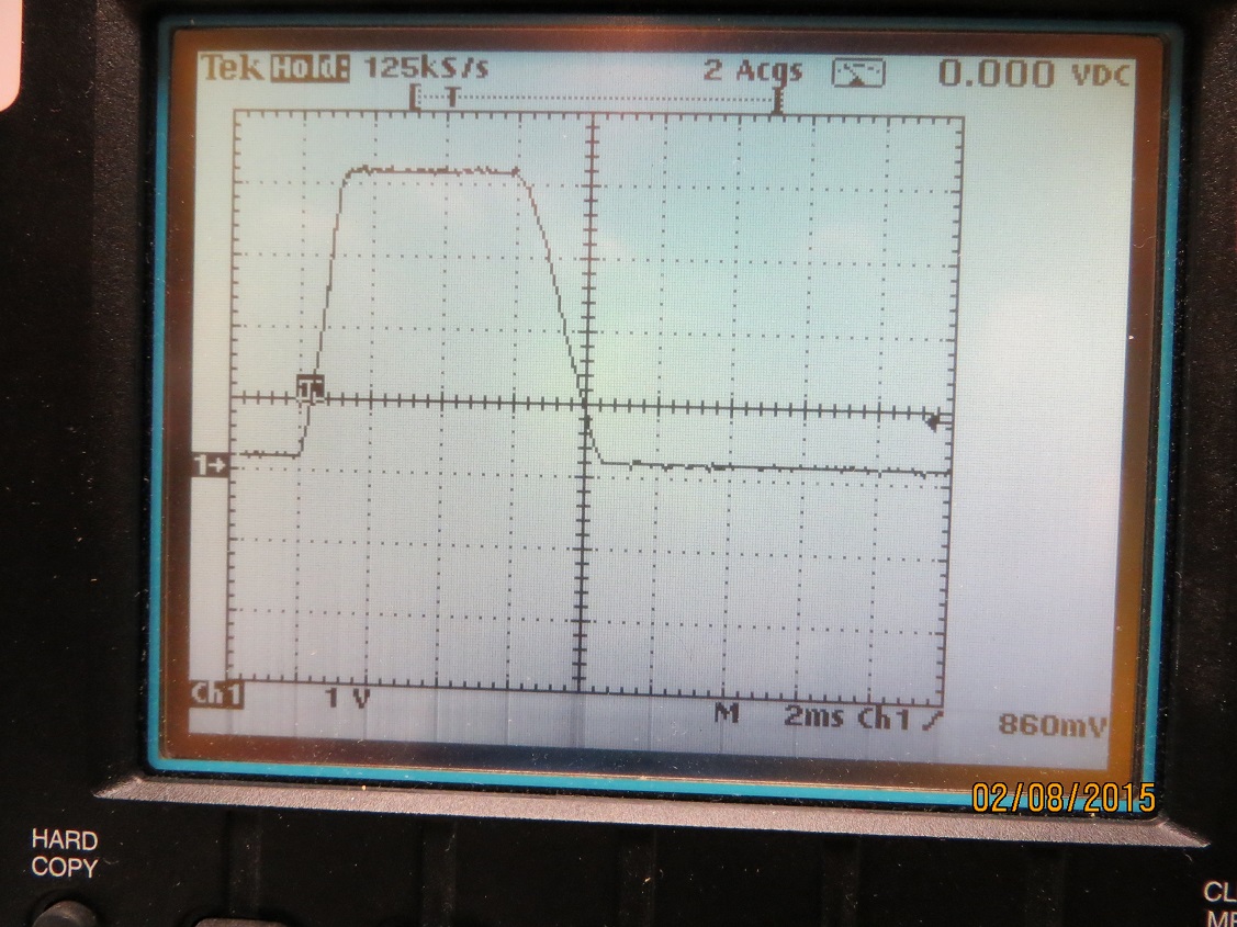

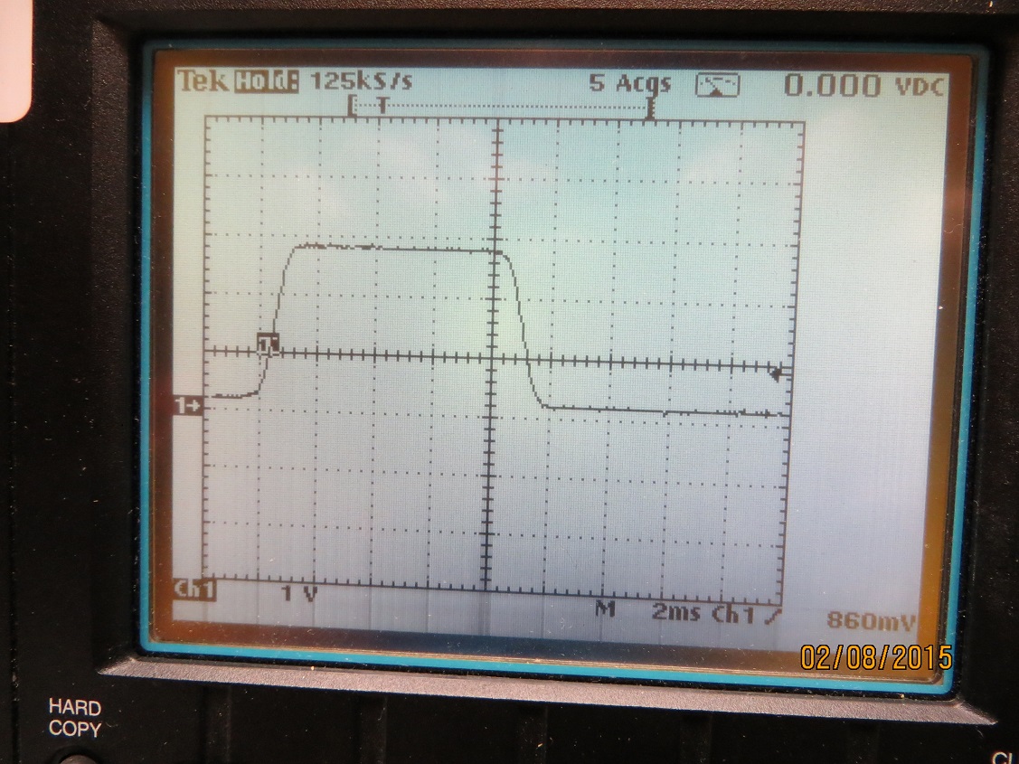

I set up my light source (an LED flashlight) in front of my Nikon FM and the detector right behind the shutter curtain. I set the speed to 1/125 sec and here's the waveform of the light coming through:
attachment.php
If you notice, the scale of the waveform is 2 milliseconds per division. 1/125 is 8 milliseconds. The width of this pulse is approximately 8 ms. If you look at the point where the waveform starts and stops, it is 9ms. If you look at the top portion of the waveform it measures a true 8 milliseconds.
The slope of the rising edge and of the falling is is pretty pronounced. It's nearly a millisecond. I feel this is probably due to the 'prenumbra' effect of the shutter. One would expect a sharp rise and fall time, but because this effect, there is a shadowing effect of light that gets around the shutter as it moves.

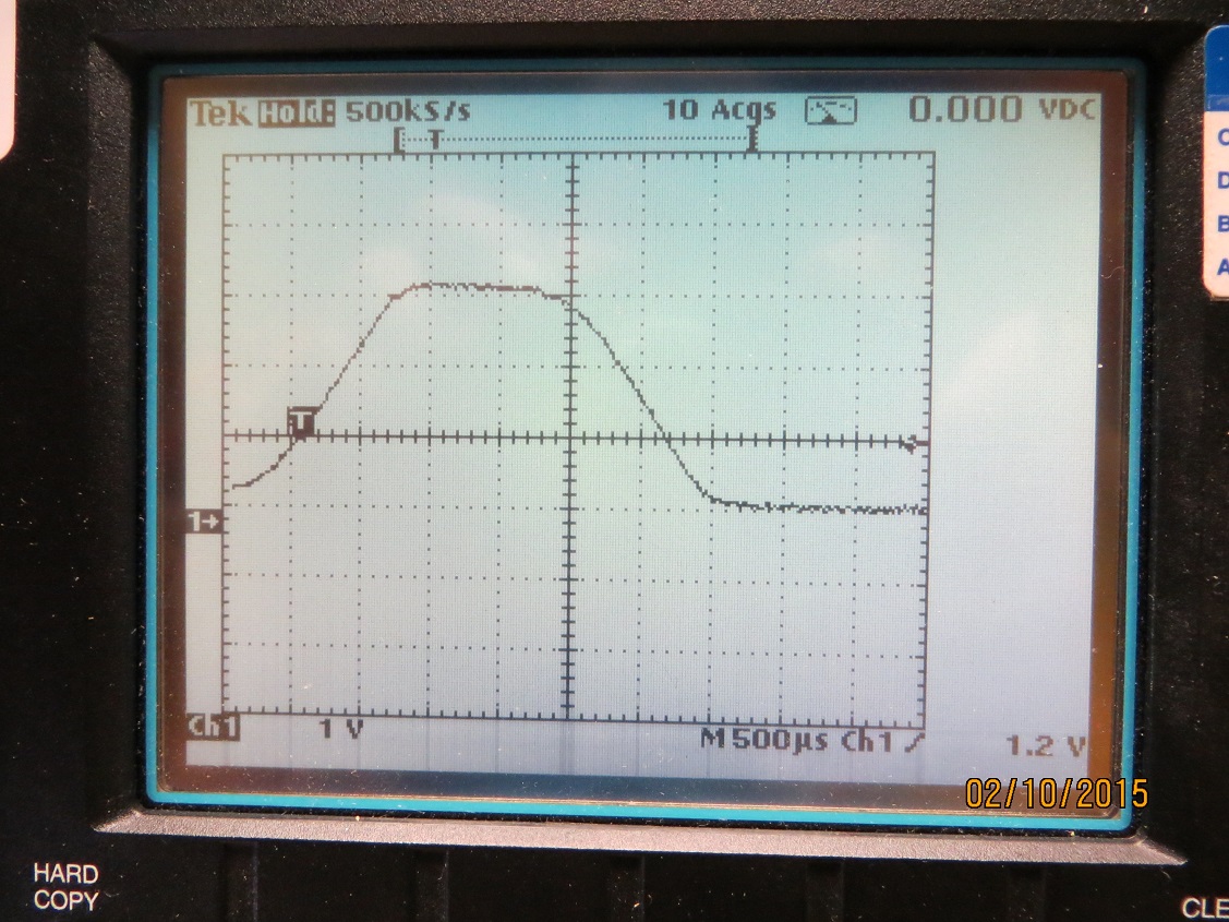

This effect starts to get more of an issue with higher shutter speeds. Here's a plot of a 1/500th shutter setting on the Nikon. I took the lens off to see if it made any difference, and it didn't:
attachment.php
1/500 sec should measure out to 2 milliseconds. Looking at the waveform, note that the scale is now 500 microseconds per division. The measurement at the lowest part of waveform is 4 milliseconds wide, and about 1 1/2 millseconds wide at the top. So my question is....

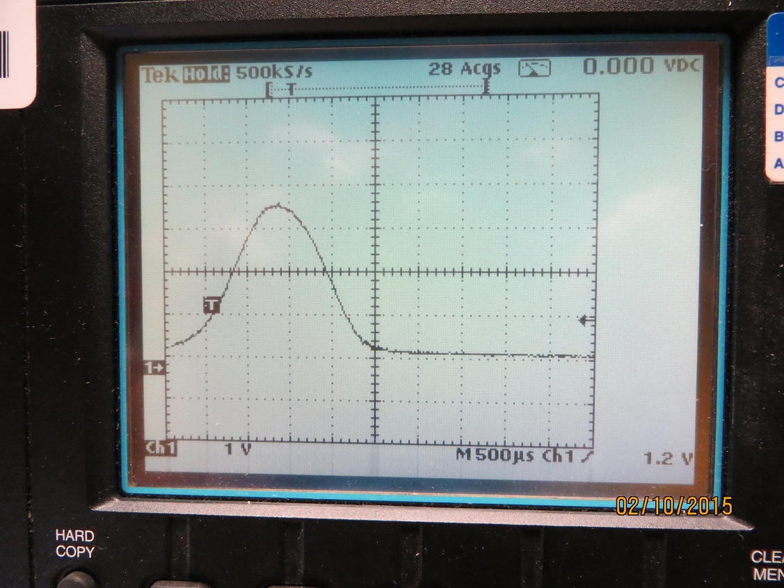

Thanks Sparky, that helps. This is a very simple system using a gated counter. The top two ICs are LED display drivers, the two ICs under them are 3 digit BCD (binary coded decimal) counters probably set as up counters. The main IC that does the detection is an LM339 quad comparator. I'm sure they use 1/4 of it to create a threshold for the counter to start, then another section set up as a free running oscillator to make pulses to count, and the last stage as some kind of gate to let pulses through to the counter. My guess is that they are running the oscillator to generate pulses at 1 microsecond rate, and then when the voltage from the photo-detector reaches a set threshold it starts the counter. Once the signal comes back down , it stops the counter.
This technique is pretty straightforward and simple. The key to it's accuracy is how they picked that threshold. This goes back to my original quest.... how do you interpret the waveform...
Here's the waveform of the Nikon FM set to 1/1000. You can see it never really tops out... it doesn't achieve a flat top.
attachment.php
1/1000 should have a duration of 1 millisecond, or two divisions of the display above. The lower part of the waveform is about 3 1/2 divisions. Two divisions occurs at about 2/3 up the waveform. It kind of goes back to the average area under this curve. Since I'm already getting overly technical... I starting to wonder if taking the RMS (root mean square) value of this waveform would derive the proper 'threshold' or timing points.
As jim Jones said previously, sometimes simple is best. The circuit used in 480sparky's northeast tester is as simple as it gets and depending on how they set the threshold, may be pretty accurate. for shutter speeds lower than say 1/250 it is probably dead on.

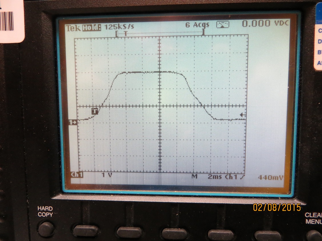

Here's another camera.. a 30's Voightlander Bessa folder. The shutter was set to 1/100. Look at how slow the shutter closes. It takes nearly 2 milliseconds to close. (2 milliseconds per every division) Again, determining the actual shutter speed is a matter of interpretation of this waveform.
attachment.php
attachment.php

Concerning the FM, the first thing thatcame to my mind is that the measurement gets some parasit light, as for speeds above the sync speed, the shutter opening is a slit. SO I guess for these shutters, I think you need to make your detection more "directional" so that the light does not reach the sensor when the slit is not rightin front of it.
It may even be that the detector is too large, no ?

You would need a sensor which has much narrower angle of acceptance. The trapezoid that you see because when the shutter partly cover the sensor it still has output. However if you could build a tester like the Kyoritsu EF-8000 and selling it for about $1000 I would be interested.

Chan Tran, I'm glad you brought this up. If you want to precisely measure the speed of the curtains, you need to have a pinpoint sensor. But film in the camera is not a pinpoint. I would think in all reality, you'd want a sensor as big as the film to get a true average of the light hitting the film. But this is not practical. So the expensive device will give an absolute precise time that the curtain is open, but is that a true representation of the light hitting the film? I would think for it to work properly, the sensor must be almost touching the shutter. Do you agree?

. . . I would think in all reality, you'd want a sensor as big as the film to get a true average of the light hitting the film.
My gut feeling on this is no; the sensor needs to be equal or smaller than the narrowest slit in a focal plane. A film sized sensor would show some average value during the whole motion of the slit which would not be the average exposure. Of course, I suppose one could go to some analog process and evaluate the area under an analog curve and .... [oh no-o-o, I'm supposed to be working on an art club newsletter that's already late ..... :w00t:]
This is correct. I made a widget using a photodiode, it connects to an oscilloscope and I use it to time shutters. I don't use exactly a pinpoint, but a short tube with a tiny inner diameter, maybe .015. A simple circuit with a 1.5v battery, a 5k pot, and a small value capacitor, maybe 150pf across the output. The light makes the diode conduct and the voltage drop across a 5k pot is your pulse, the level is adjustable as the wiper arm is the output. Needs a bright lightsource, but it's dirt simple and works well

Laurent, I may be coming around to your thinking. A very tiny detector would be similar to the grains of silver salt in the film. After all, that is what builds the image. One tradeoff with making the detector smaller and smaller is that it's sensitivity goes way down. The bigger the slice of silicon, the more sensitive it is, but the slower it is.
From a previous thread, I saw that someone put the photodiode back in a small tube, with a narrow aperature. Maybe that is a solution. A bigger photodiode for the sensitivity, but a narrow aperture to make it very directional.
That will be my next test tonight. I will post the results tomorrow.
For fun, here's what an argus "brick" C3 looks like at 1/100:
attachment.php
Very slow opening and closing. It is a continuously variable shutter speed, and the dial is pretty touchy. It also doesn't seem to have consistent results... each time it was slightly different, but not enough to have to change an F stop to compensate.
