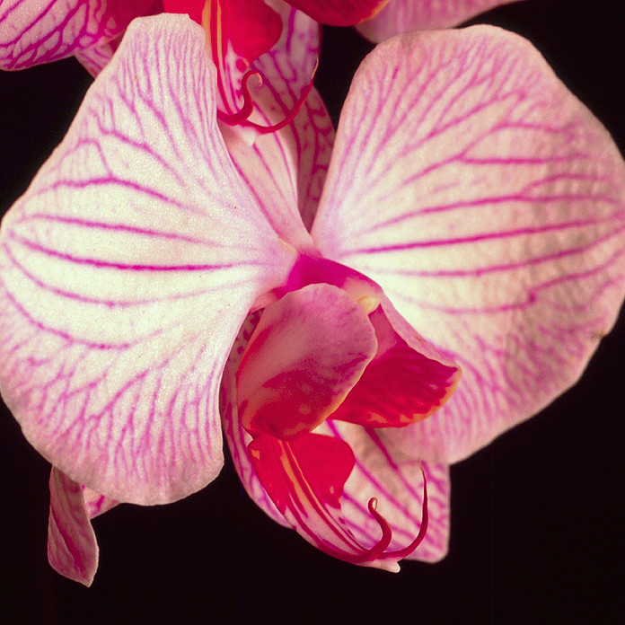

(Shot on a Crown Graphic, 150mm lens, 6x9 back, tripod mounted in studio, with flash, maybe around half-size on the film, heavily cropped scan).
