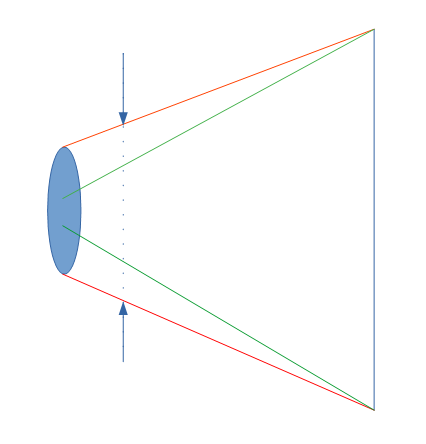

Here's a simple illustration. Please correct me if I'm wrong. Blue ellipsoid is the exit pupil, blue line is the image diagonal, red and green lines the exit rays for respectively the full pupil and stopped-down pupil, and the arrows represent the rear shutter.
If the shutter obstructs the exit rays, you get vignetting. Along the dotted line you can have a smaller shutter which doubles as an aperture stop. Or you can use a big shutter + variable aperture.

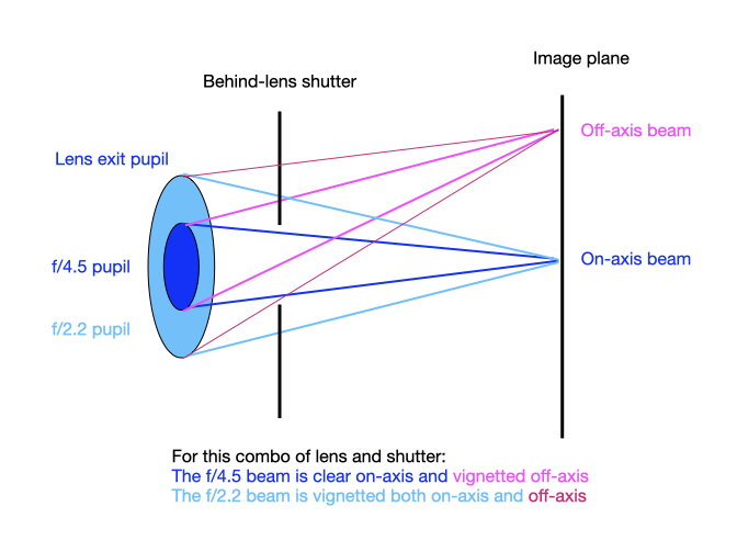

Sort of, but I would draw it differently to illustrate the beam emerging from the exit pupil and how it can be partially obstructed. Here's an example, excuse the slightly clunky Keynote graphics, where the light blue and dark blue ovals are apertures to-scale for an f/2.2 and f/4.5 beam. The lightblue/darkblue and red/magenta ray bundles are the on-axis and off-axis beams emerging from the pupils. For a shutter opening as drawn here (black line), it would vignette the on-axis beam at f/2.2, but not on-axis when stopped down to f/4.5. However, it will vignette either if sufficiently far off-axis (which limits the angle of coverage).
This is just an example, although the beam opening angles are correct for f/2.2 and 4.5, the shutter opening and distance behind the lens are merely something I drew, not taken from any real shutter.

An image forming beam can be partially obstructed at the outskirts (vignetted) and still form the image, and this can happen for an on-axis beam, as in the light blue cone of rays for the f/2.2 example in my above drawing. We often use "vignetted" to mean light falloff in the image towards the edge, but the beam itself can be vignetted.

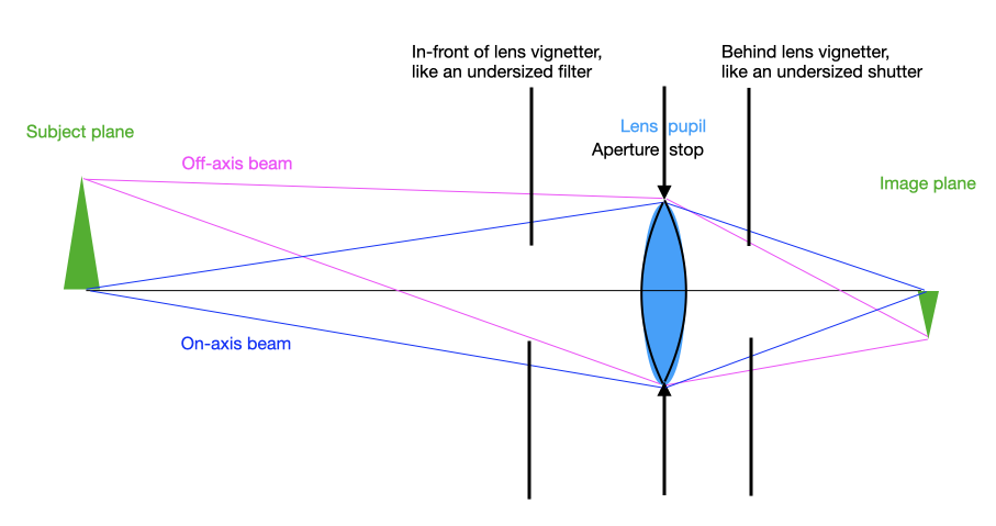

I'm not sure what the issue is. Perhaps it is that I said the on-axis "beam" is vignetted ? The beam is different from the on-axis ray. The on-axis ray is a single ray of light, but the beam refers to the entire cone of light from a point on the subject to a point on the image. (This beam vs. ray is standard optics terminology.) Vignetting refers to partial obstruction of the light path, typically at the edges. Here's another drawing:
Here I drew the full light beam from the bottom of the green tree to its image, on-axis: the chief ray is the black line, and the beam is the two blue lines (encompassing the rays in between). The off-axis beam from the top of the tree is the magenta lines.
If we interpose a too much under-sized aperture behind or in front of the lens (the vertical black lines), the on-axis chief ray goes straight through, but the aperture will partially obstruct the outskirts of the on-axis beam (the blue lines). This is vignetting the beam. It will form an image of the bottom of the tree, but slightly dimmed. It will vignette the off-axis beam more, of course, so the top of the tree will suffer more light loss.
I am not an optical designer, but I talk to optics people frequently (I'm an astronomer) and this usage of "vignette" is common.
As the diagram suggests, the size of the obstructing aperture or baffle (like a rear shutter) that you may be able to get away with really depends on the angle of view and the geometry of the situation, there's not a simple rule of thumb for it.
