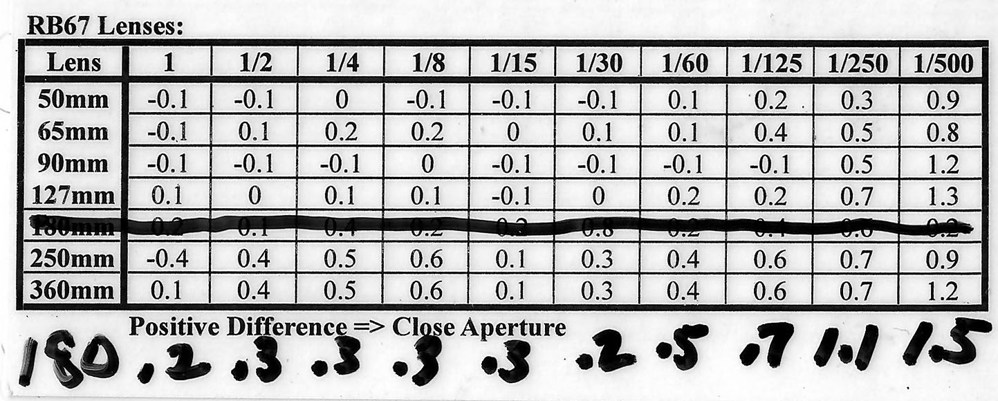

I have a shutter tester I purchased from Calumet Photographic and determine shutter speeds for each speed on each lens tested. While it involves logs, it's a relatively simple calculation to determine aperture corrections for each shutter speed. I did this for all my RB67 lenses. I've long since sold my RB gear, but here's a table I made with those corrections. They're given to the nearest tenth stop.
Many of the speeds were remarkably close.
