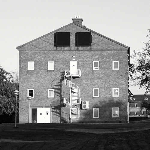

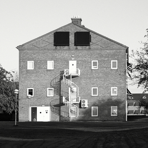

I have done a small test by editing a photo from DNG to JPG and PNG, to see if there are visible differences when shown in a browser side by side (Firefox, Microsoft Edge).
The original DNG is converted to BW with Channel Mixer and then saved as JPG and PNG, both 24 bit (8 bits/channel, sRGB). After that the JPG and PNG are processed independently but identical: correction of perspective, cropping, contrast, resized to 500x500 px, sharpened. The JPG is compressed only 2% to keep the quality high, the PNG has an internal compression (don't know how much).
JPG
PNG
File size is 183 kB for the JPG, and 320 kB for the PNG.
Theoretical the files might be rendered differently in a browser because PNG is especially designed for web use, but in practice I don't see any differences. I also don't see differences in the editor on pixel level for that matter.
Of course the JPG would show up more fuzzy and with artefacts when compressed more (the PNG is lossless), but this test was about rendering by a browser so compression is kept low.
Is there anyone who always edit their photo's as PNG instead of JPG and for what reason?

Is it just me, or is the JPG ever so slightly sharper than your PNG? Considering the JPG is half the size of the PNG, I don't see any reason to consider the PNG as an alternative.
What image editor are you using? If it is a non-destructive editor - and if the only thing you want to test is JPG vs PNG - then the test would be better controlled if all edits were done to the DNG - and conversion to JPG and PNG were saved until the last step (Export As).
Is your only goal to output the highest quality - or is keeping the file size small also a major consideration?

My image editor was Paint Shop Pro X7 and intermediate JPG files were saved as lossless, so there was no loss of quality during processing.
Both file types were edited as 24 bit (8 bits/channel). I admit that is not ideal but at this moment I refuse to work with the huge 48 bit files, so it is a compromise between quality and size.
Moreover, I don't print, all my photo's are small and shown in a browser, so I don't think it makes a big difference.

My suggestion to edit the original file first, then convert it, was not aimed at preventing loss of quality while editing. Rather, my concern was that editing each file separately might introduce more variability in the results that could be misinterpreted as due to differences in the file format.
Ah yes, you are right.
I also fear that's the reason some people are preferring the JPG. Looking at the twigs left and right perhaps the JPG is a teeny-weeny bit sharper. But it's not logical and perhaps a side effect of the post-processing, because the clean bitmap from PNG is directly rendered to the browser and it should be sharper. More tests needed.
