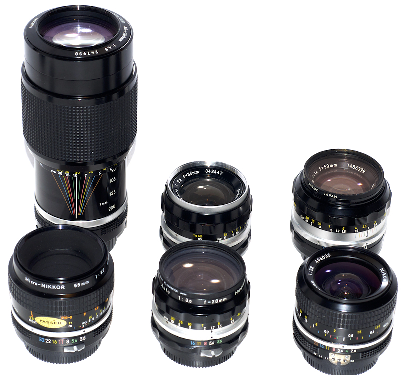

I have been collecting some of those long focus throw pre-AI lenses for my F and F2. They are harder to use, but have excellent build quality, good optics, easy to repair. They are usually inexpensive because they don't work on digital cameras.
This is what I have picked up so far and they are all fantastic. These are all "Pre-AI" design and construction but I did put AI aperture rings on some of them.
80-200/f4
35/f2.8
50/f1.4
28/f3.5
24/f2.8
55/f3.5 Micro
