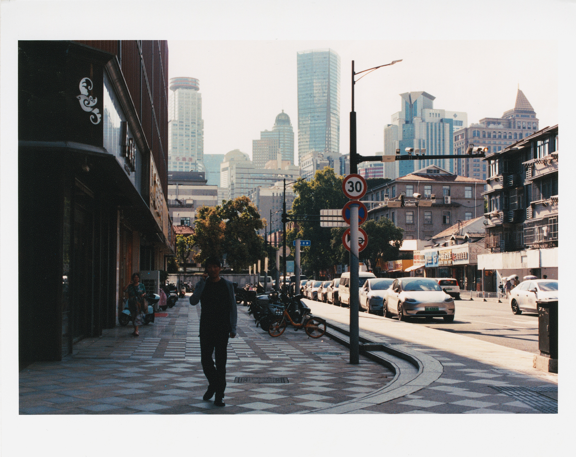

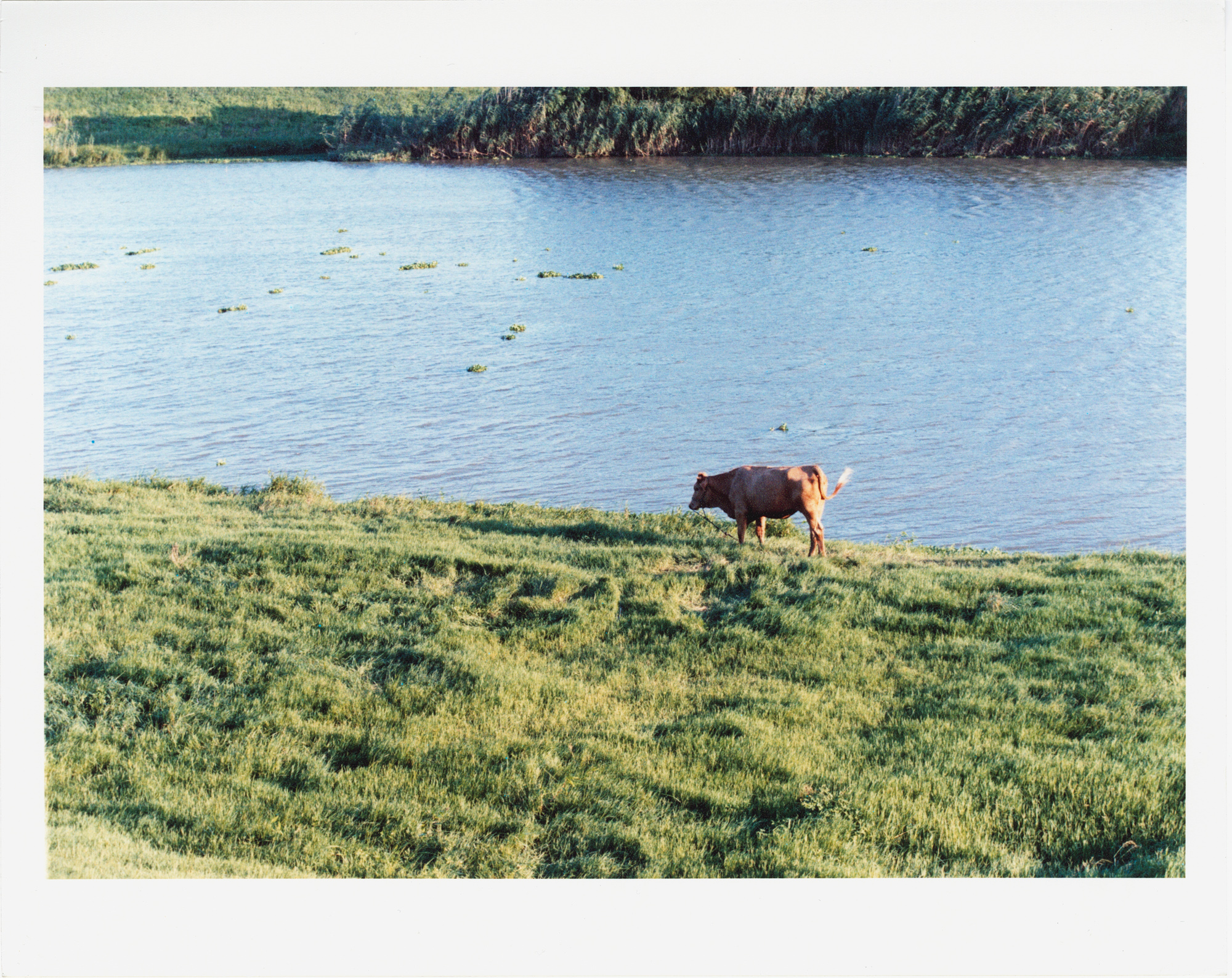

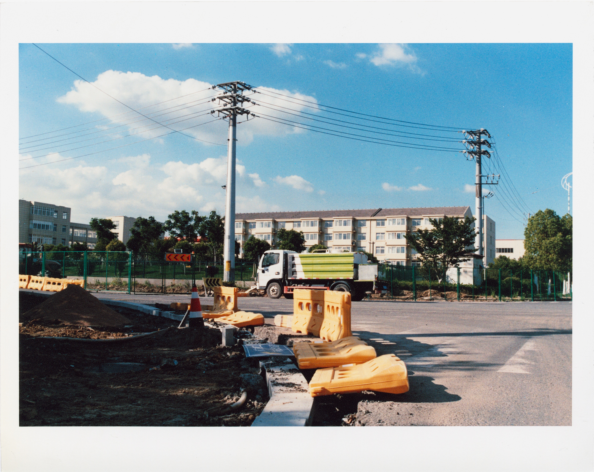

Due to insufficient production capacity and supply, I was very "lucky" to get a roll of the newly released Lucky Color Film. Now, I'm sharing some of the photos I took, hoping to see what everyone thinks.
I only work in the darkroom, so I don't scan the negative film. These photos were enlarged using Kodak Premier Digital Paper and scanned and uploaded using an Epson scanner calibrated with IT8.
I think this is a roll of film with very "normal" color (compared to ORWO/phoenix), at least, it can be used for daily use! Although it has some problems, the contrast is high, the highlights are a little red (I used Pre-Flash to correct it when enlarging, and by the way, the contrast is not so strong)

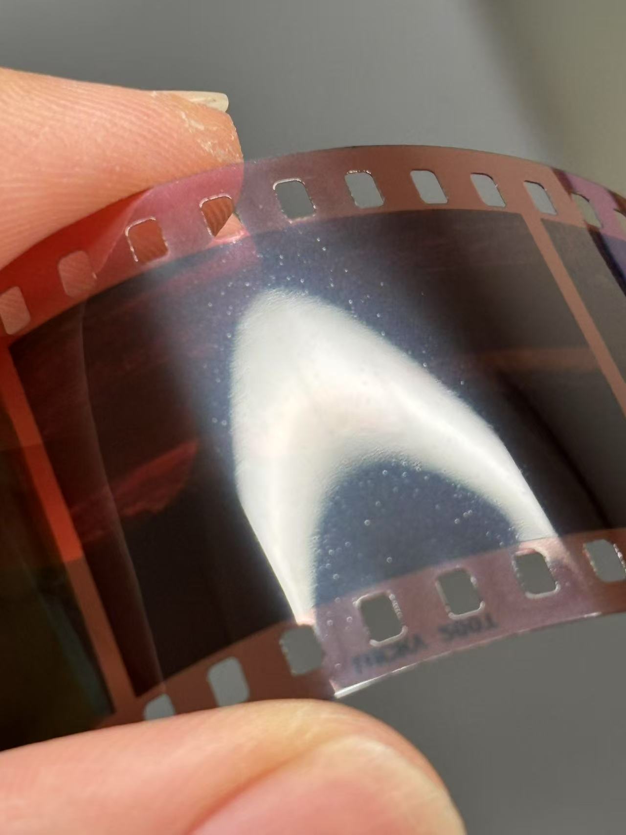

The emulsion defects are all over the film, and dense dot marks can be seen everywhere. I really want to know what caused it, maybe the debubbling was not done well when the emulsion was coated?

Thank you for sharing your real world experience.
Absolutely, totally great @LomoSnap ! Thanks so much for sharing these. Congrats on the prints; they look very good to me. Well done indeed. This looks like a pretty mature CN film, quite similar to consumer CN film that was sold by the thousands in drugstores and convenience stores in the 1990s.
Yet, your prints look relatively clean. I see some small spots here and there - is that what you're referring to? The photo of the curved negative shows what looks like some debris; usually this is the result of particles clinging to the film during fixing, washing or drying.
The only clear defects I can see that are really inherent to the film are these little colored spots:
I would explain these as minor problems in emulsification and/or filtration. Color emulsions are a bit tricky in that the color couplers are oil-like and the gelatin emulsion is water-based, so making an emulsion like this one much like mixing oil and water. We saw similar things in Harman Phoenix.

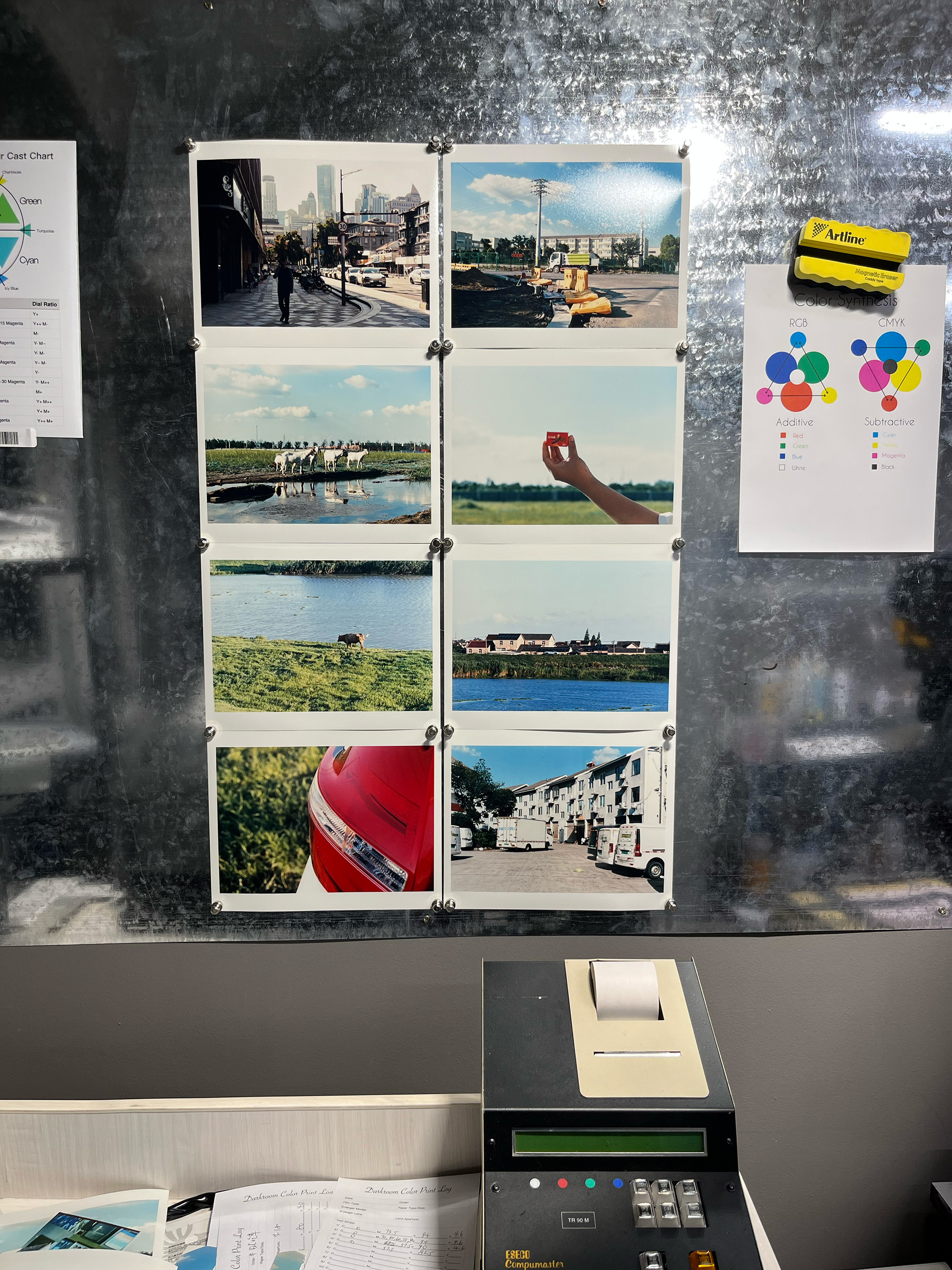

I like that detail; I used to have something like that in my previous darkroom. It becomes second nature at some point, but it's still nice to have a reference like this. And it works well for you, too, judging by the pleasing color balance you realized on those prints.
I have this color wheel because I still have a Philips PCS 2000 additive color enlarger in my darkroom and I need to remind myself of the additive/subtractive color process.
Yes, I blew it up to 8x10" and it's hard to see the emulsion spots without looking closely. But it's definitely in the emulsion, not the process or drying process, I can see the same spots on the unprocessed film.

I make contect sheet prints of the negative film, and then I selected the photos and enlarged them individually. The enlarged paper I used was called "Kodak Premier Digital paper".
Finally, I used Epson 10000xl to scan these papers for sharing on the Internet.
