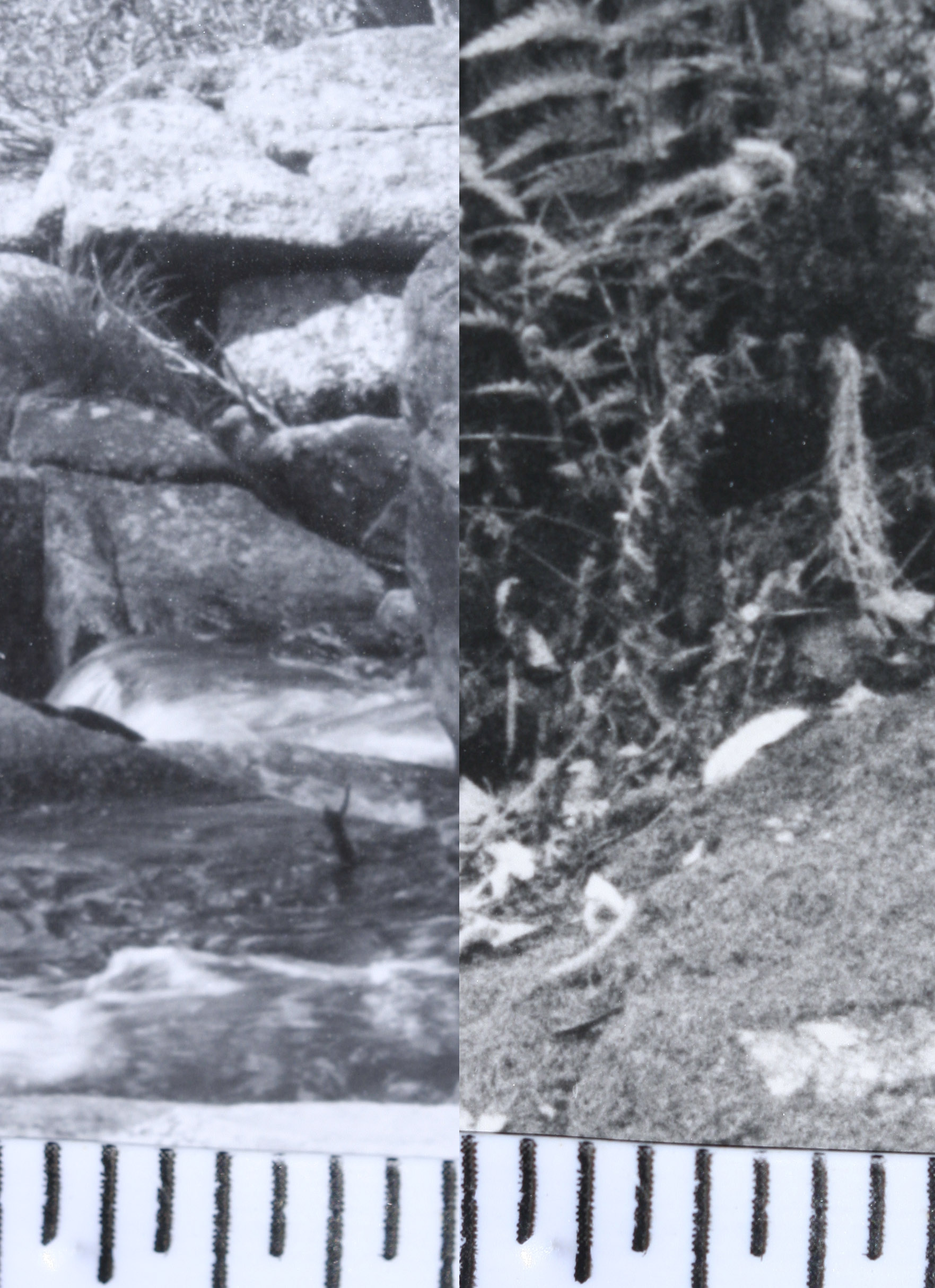

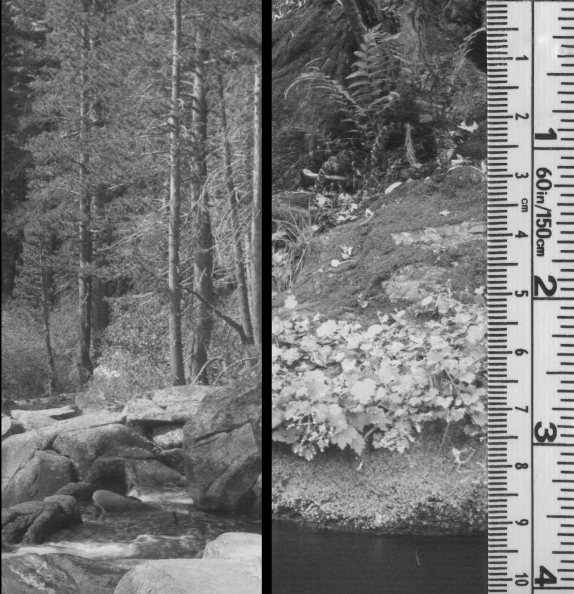

TMY2 4x5 (left) vs Panatomic-X 35mm
When 35mm is printed 11x14, Panatomic-X vintage negatives exposed and developed when fresh match expired Panatomic-X with fresh exposure and development. TMAX100 is a fair replacement. I prefer Panatomic-X, but will use TMAX100 interchangeably.
TMY2 is grainier. It’s a wonderful film but it has visible graininess with 35mm at 11x14.
Grain of TMY2 4x5 is as fine as 35mm Panatomic-X printed to 11x14. These are benchmarks of what I want from my nature photography.
