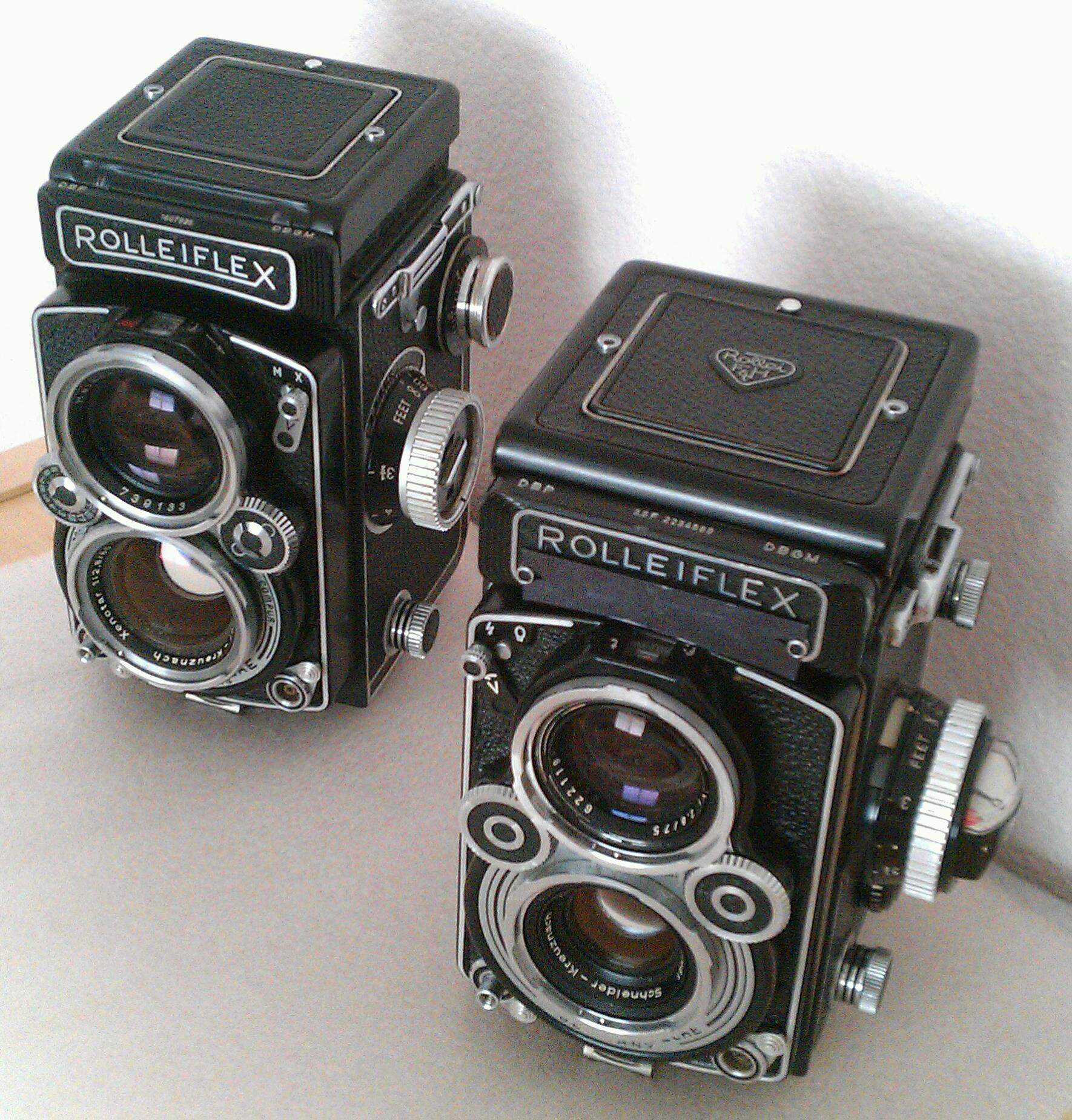

... I really have to recommend the MX-EVS - I think Rollei really hit its peak here.
Is the MX-EVS a K4B? Rollei model numbers are so confusing. How does an MX-EVS compare to the D models (K7D)?
> selenium meters on the newer cameras are mostly a waste of weight these days.
I have a 3,5F an the meter still works. After more than 50 years!
As you can see, I've amateurishly covered the meter on my 3.5F to block light from it while it's not in use. The meter does work and is reasonably accurate. I just want to preserve it.
Also, the addition of the meter and its linkage greatly complicates any repair that's needed. I much prefer meterless Rolleis.

I believe the MX-EVS is often referred to as the "3.5B". I have also seen it labelled as k4b, although I have also seen non-EVS MX-synchs described as k4b's. The MX-EVS is very much like a 3.5 version of the 2.8D. If you are ever looking to sell your 2.8D, I have been looking for one... :wink:
