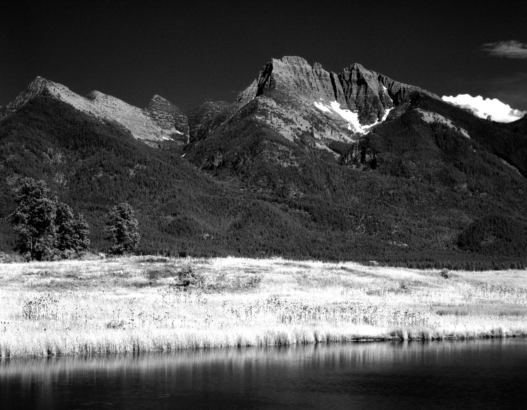

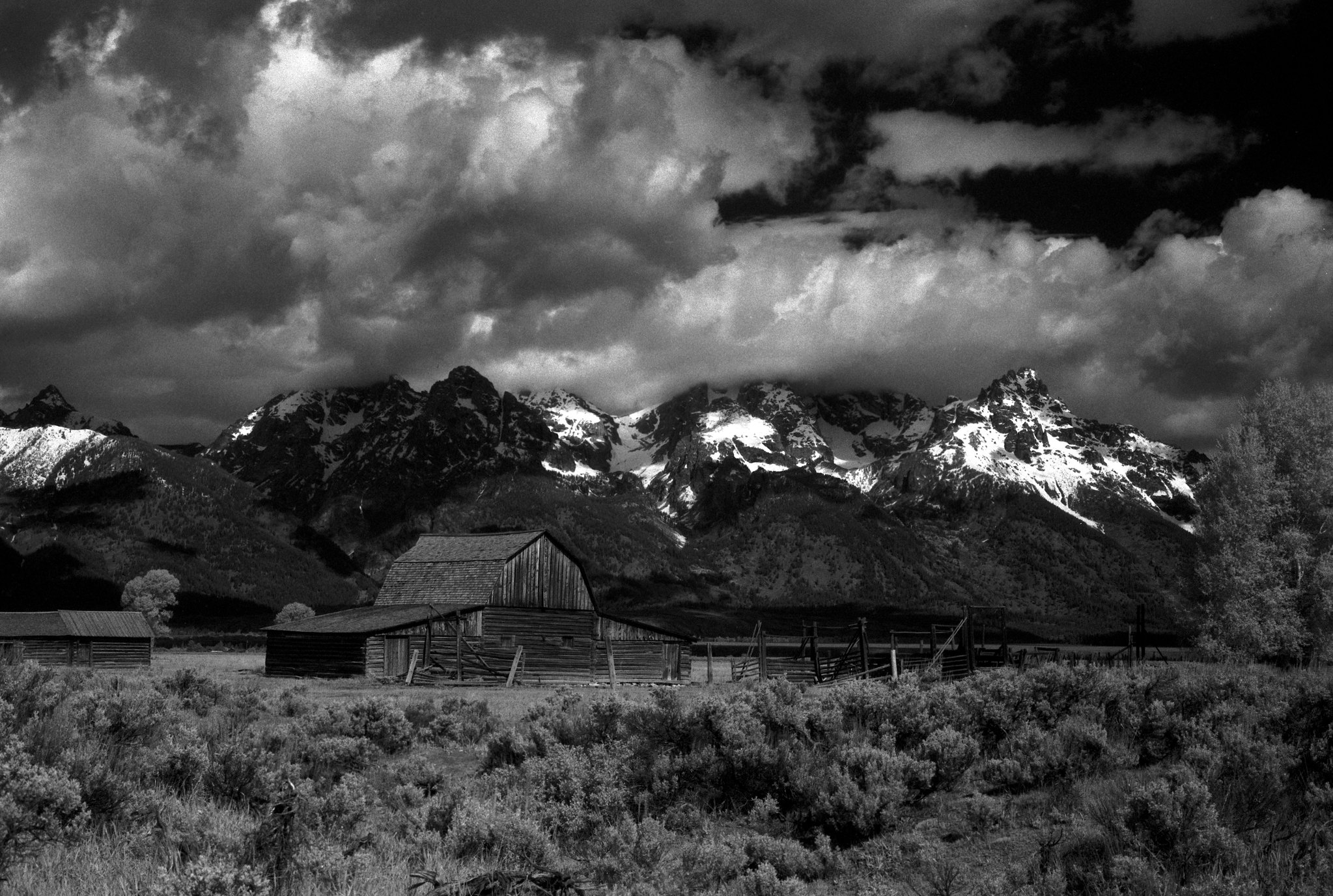

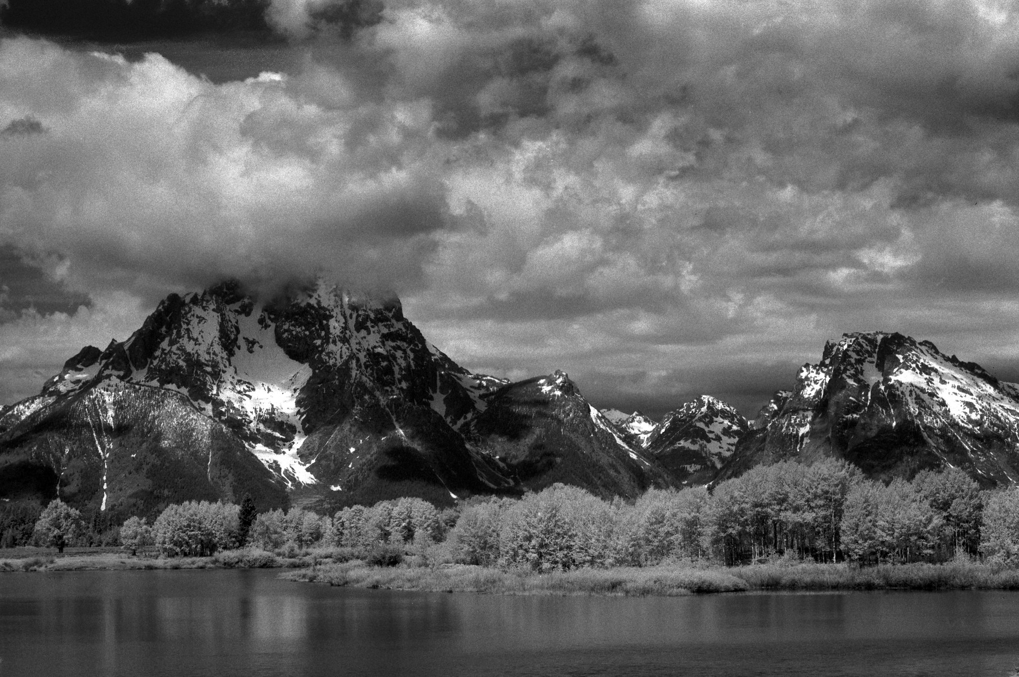

Yup, as noted above, no need for focus compensation. I use a Cokin 007 filter when I shoot it. These are all with a Bronica GS-1.

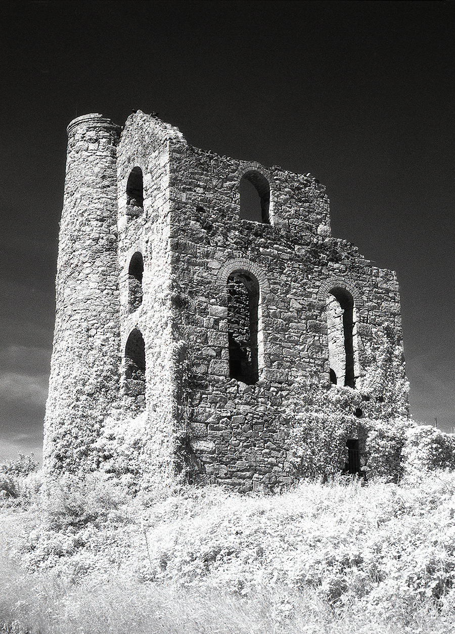

Shot on SFX200 through an IR72 filter. Focussed as normal before adding the filter, with no adjustment made once filter added. F stop of f11 meant focus was pretty good anyway, without having to adjust for the infrared wavelength
