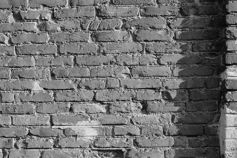

I have started scanning the last test roll (Efke100 + Rodinal 1:50).
The results looks much better than my previous attempt. Here's a sample picture of a brick wall from about 1.5m, with no retouching other than resizing (which has made the image a bit soft). The sun was roughly at 90% with respect to the lens axis. I cannot see any evident flare.
As soon as I have scanned the comparison shots with Jupiter and Industar I will post them here.

Image looks nice, that's a relief.
Don't invest much time with comparisons with the Jupiter and Industar: if they work, they work and take you nowhere. If they don't work, and there is an established and well documented incompatibilty with Leica to explain it ( close up, and / or maximum aperture is where you'll find it.)
Best thing to do is assume the Elmar is fine, and shoot a couple rolls to learn what it likes. And to figure out what went wrong with your first shot.
I don't know what your ambitions are for your IIIf, but the Elmar should be splendid. The camera itself will be fun, and useful, to shoot for a long time. And if you want contemporary image quality as an alternative to the mid '50s excellence of the Elmar, C-V lenses are quite good and a real value.
