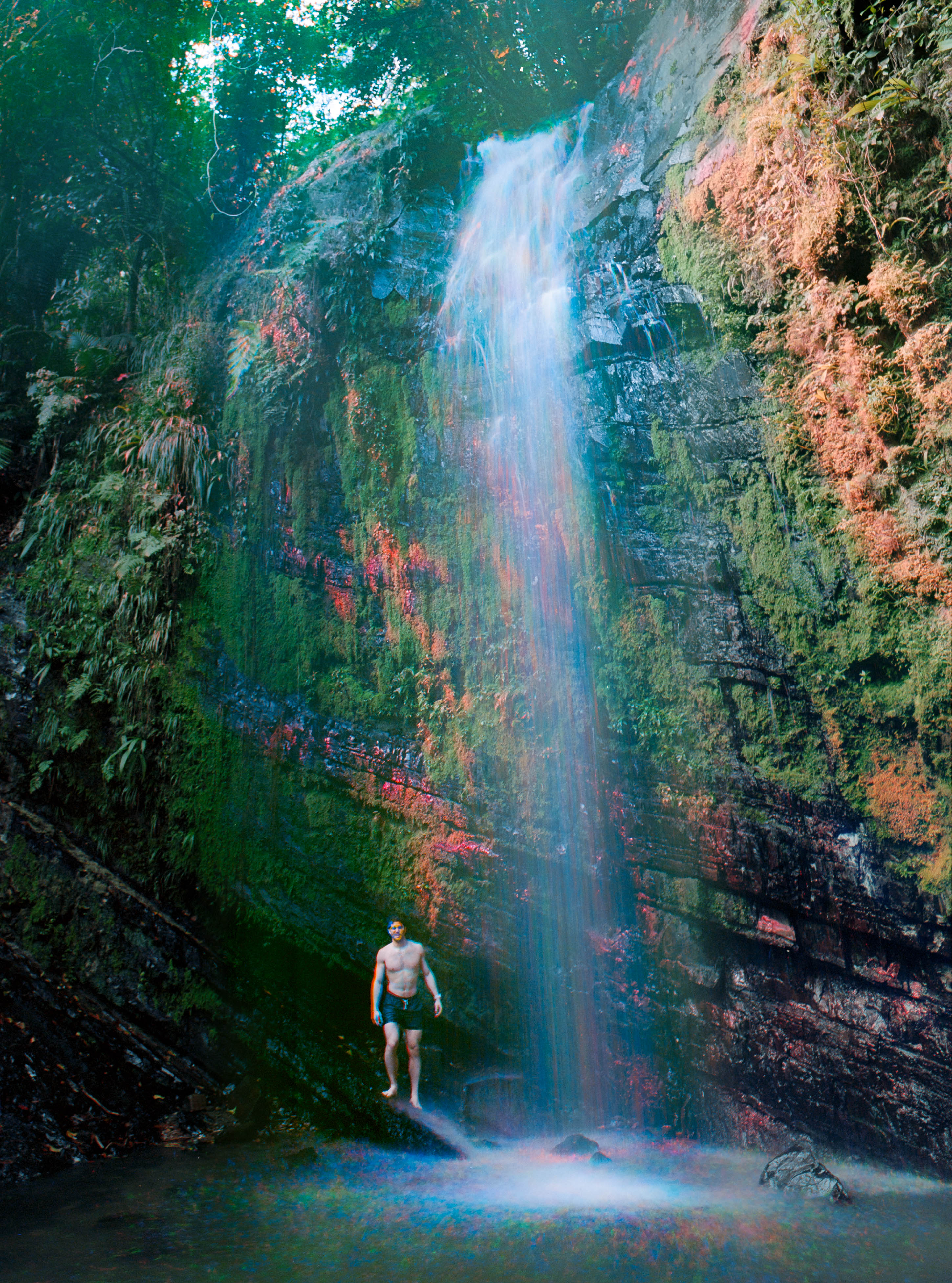

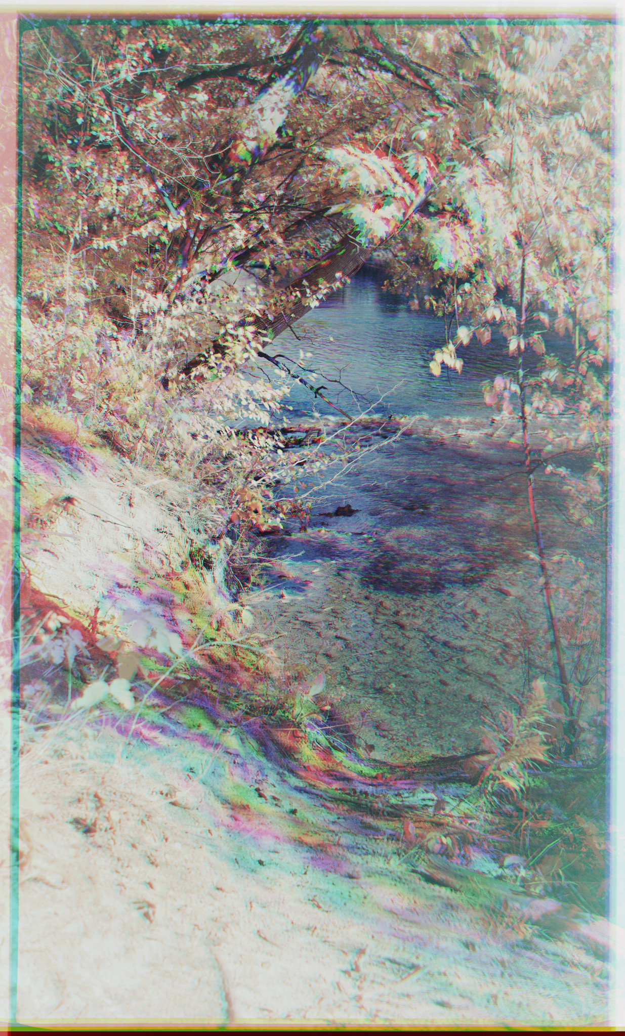

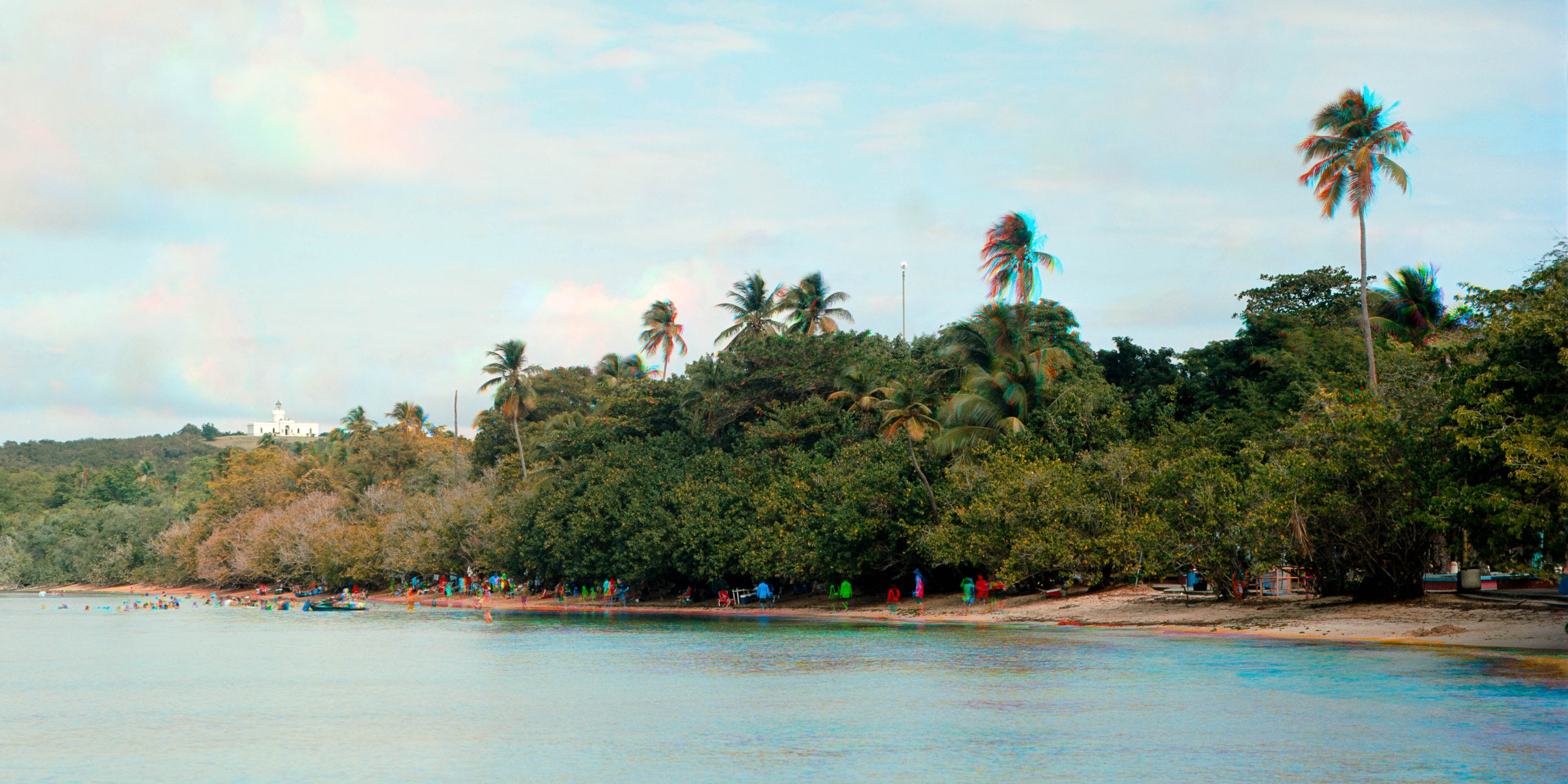

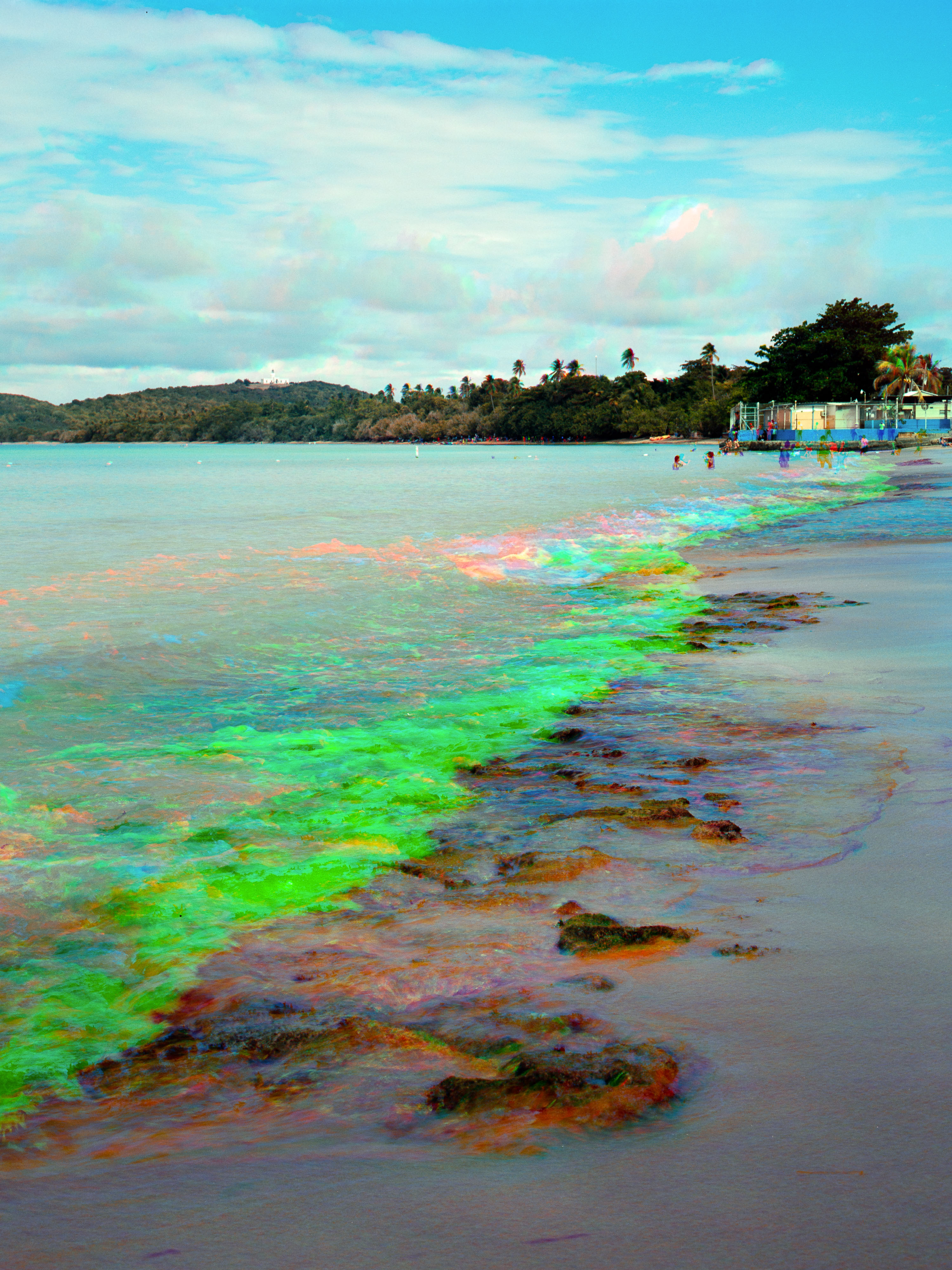

Hey everyone,
I’ve been experimenting with trichrome photography for a while now, usually using three separate black and white negatives through RGB filters and recombining them digitally.
On a recent trip, I decided to try a different approach and shoot trichromes directly onto color negative film as in-camera triple exposures. The goal was to see how viable this is outside of controlled conditions, dealing with movement, changing light, and alignment while traveling.
These were shot on a Mamiya 645 Pro on Ektar 100. As expected, subjects like water, foliage, and people moving between exposures introduce noticeable color separation artifacts. I did have a few frames with registration issues, but overall I was surprised by how workable the results were, especially given the constraints.
I’m curious how others here think about trichrome or color separation work in general, particularly when done in the field or while traveling. And if anyone has tried similar work on color film specifically, I’d be interested to hear how it went.
I also put together a short video walking through the process and results in more detail, for anyone interested:
I’ve attached a few representative frames below. Happy to answer any questions about the setup or process.

View attachment 415854View attachment 415853
