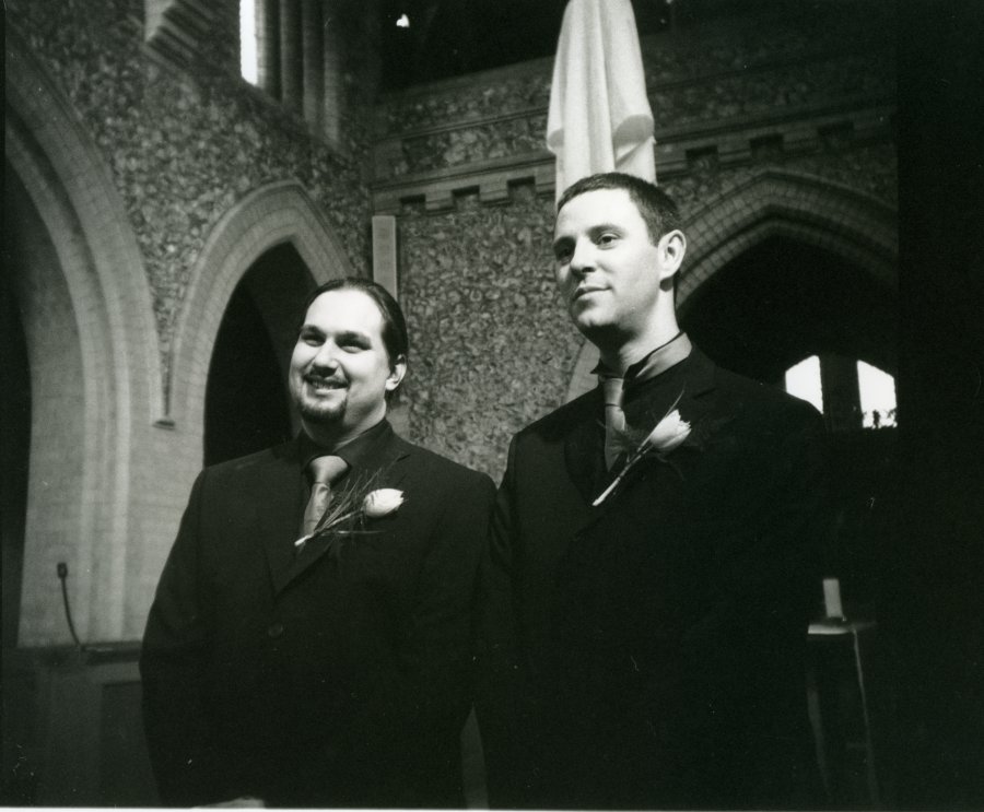

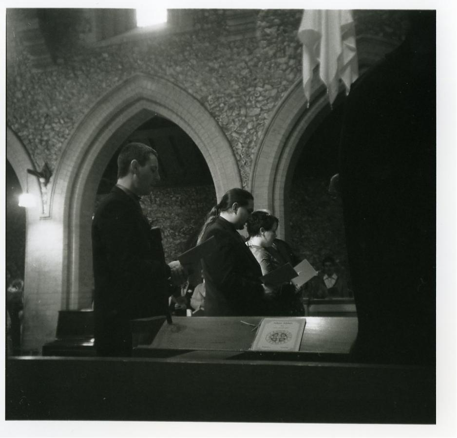

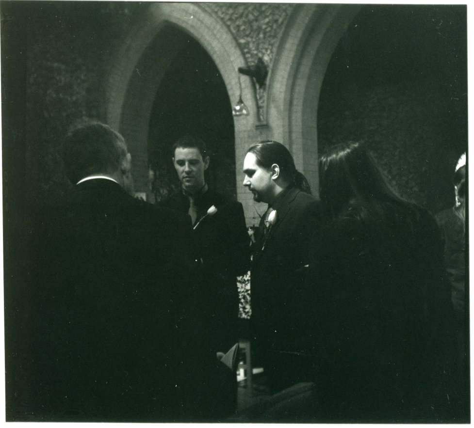

Ah I only did it as a favour for a friend who isn't very picky but just likes my printing/photography. Didn't even know if it was going to work at all, darkest venue ever. Metered it as far as my little light meter could take it (3200) and saw I needed about 1 stop more for it to be within the aperture/shutterspeed range of the sporti so developed it as EI 12500 in microphen (1 stop more than my expected EI of 6400).
I think her requirements was "use those weird cameras you have" and B&W :tongue:
