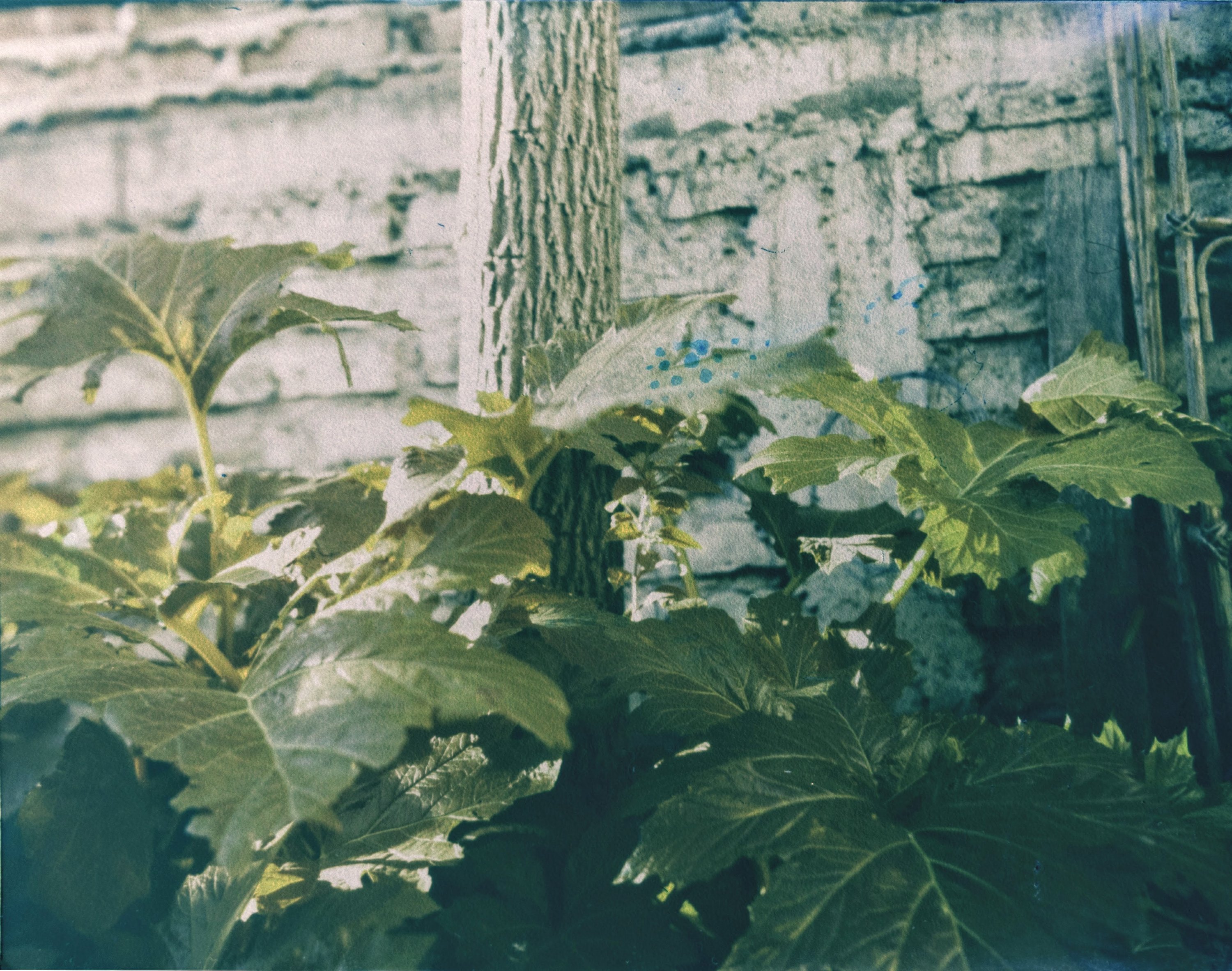

Sorry for my poor English. First at all: Thank you guys for all the kindness and wisdom here, it is certainly a very powerful tool for researchers like me dealing with this fantastic analog world. A ton of my questions will probably be resolved on this forum and it's just time for to find out where it is. So that's my case, I'm starting to shoot Fuji CA II with a Zeiss Ikon Maximar 207/7 (9x12) and I already found here some answers about filtering with satisfactory results (by my standard haha). I tried shooting 5x7 with the same carpet lens (CZJ Tessar 135mm) because 9x12 is too small to enlarge but I have no results, just dark images, I don't know if this is what you call "foggy neg". Anyway, I would like to increase my negatives to these ULF scales: 11x14- 16x20 "that's why I bought an Apo tessar f9 / 600mm (circa 1930). Actually I choose ra4 because c-41film for me is prohibitive and not available in many standards and for Last, but not least, because ra4 for me is a very interesting option to experiment with.

For filtering I just using an Ambico sepia filter (I attached one test). In this old thread this guy called Mark Killmer was working very nice with his combo filters.

[ATTACH = full] 258128 [/ ATTACH]
f 8 - 4 "(con filtro Ambico Sepia)
Papel Fuji Crystal Archive II
Dev con C-41 (1 min)
Blix (2-3 segundos)
