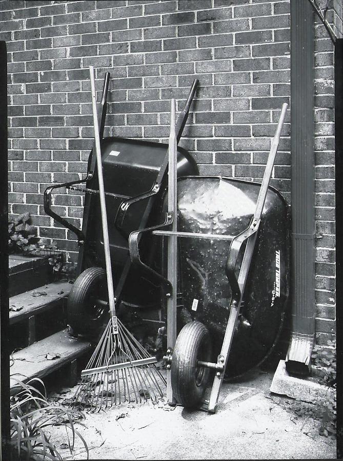

Paper is VERY slow ISO (about ISO 5). I tested my camera with paper and just scanned the negative print and reversed for a digital positive. B&W paper is orthochromatic, so reds render as black. This is a positive from a paper negative. The wheelbarrows are bright red.
