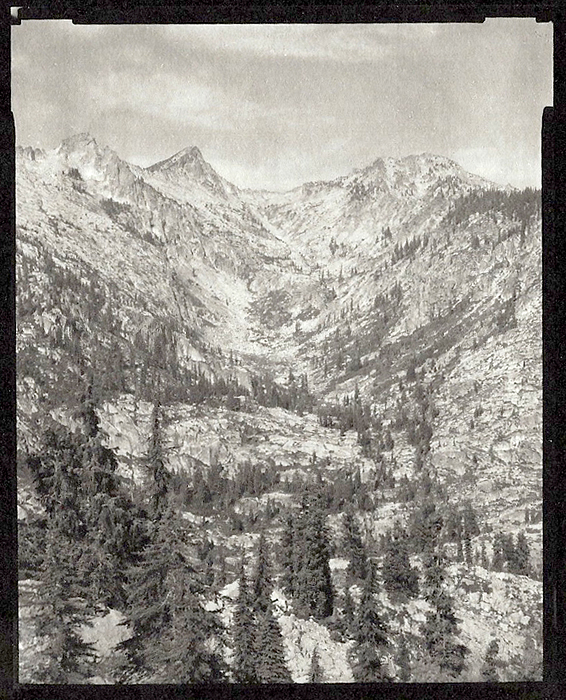

I strapped a hard case with a some sort of 4x5 rail camera in it (belonged to the university) to the top of my Kelty frame pack -- looked like a 6'4" Sherpa -- and hiked 8 miles or so up the trail. Then from camp wandered straight up the mountainsides, etc.
Dang-- to have those legs, lungs and heart again!
A bad reproduction from a dusty neg from the above trip -- learned why changing film under one's sleeping bag can be problematic.
Trinity Alps (Thompson Peak) perhaps 1979. This wilderness has just been closed to hikers until November due to fires and lack of personel to manage the wilderness use.

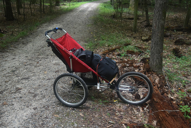

Not monorail, but some in our local group used jogging strollers to haul 7x17" and 8x10" format field cameras.
I use a jogging cart to carry my 4x5, 5x7 or 8x10 gear. Works great as long as you don't try it on very gnarly trails.
Pocahontas Park
by JOHN EARLEY, on Flickr
I had an extra rail for my Toyo 45G that I cut down to 7" and with a good bit of padding I was able to carry the camera in a backpack. I just screw the regular rail onto it and it's ready to go. I normally use my Shen Hao when I'm out and about so this is only used on a rare occasion.
