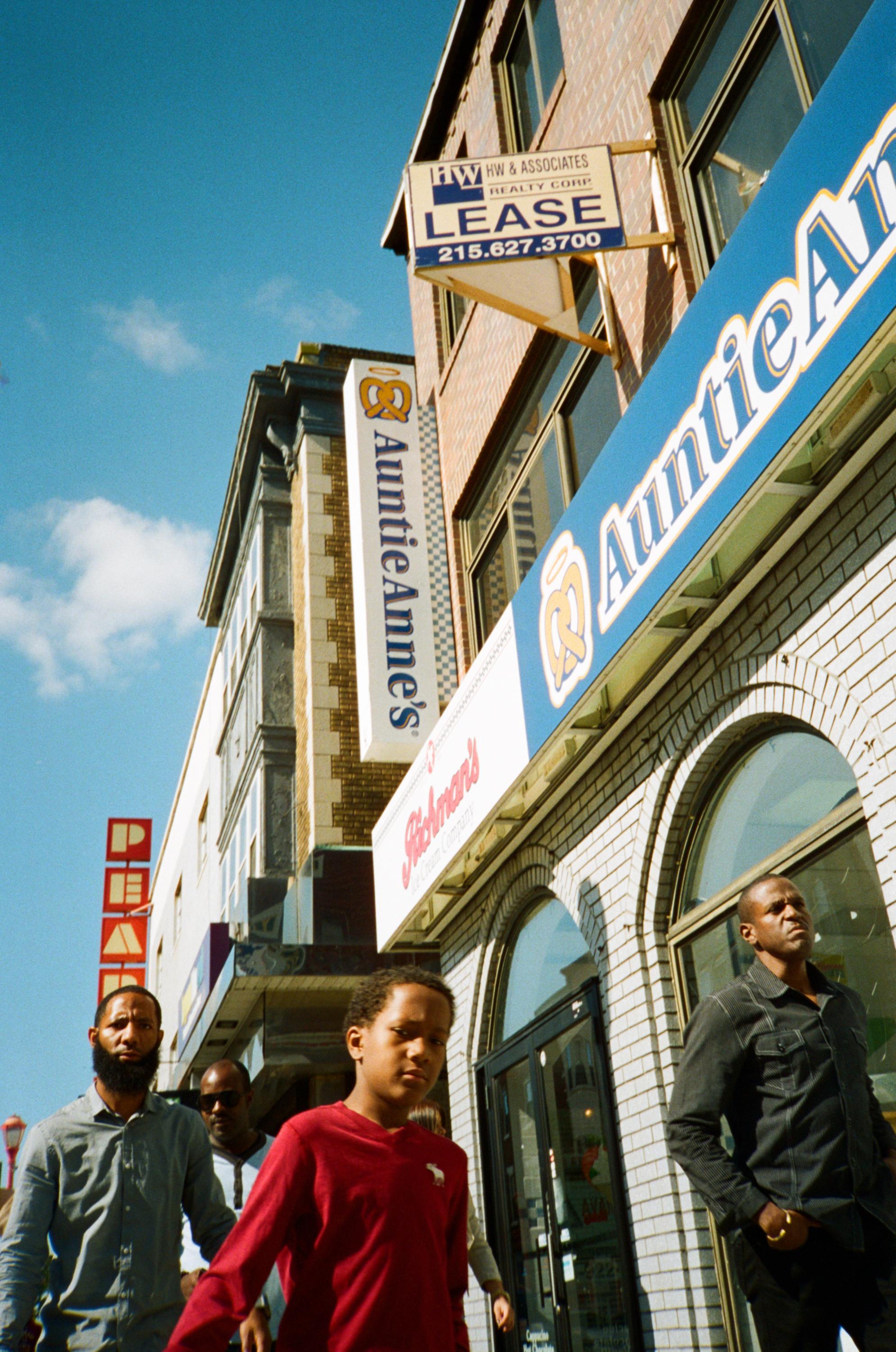

Olympus XA held down at arm's length in my right hand. Been working on this this Fall, with mostly fails but I'm getting better.

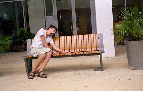

I try 'shooting from the Hip' when out and have some success -- I used my 1966 Carl Zeiss Werramatic loaded with outdated Agfa 200 film rated at 100 ASA for this and did a 16x12" Competition print for my Club but the judge said it was 'not straight' -- but I LIKE it still!
Yawn by pentaxpete, on Flickr
