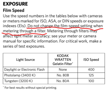

I have been shooting Portra 400 under tungsten lights and the spec sheet states that under 3200K lighting I should use an 80A filter and an ISO of 100, but I'm not exactly sure what to make of that statement.
When I have shot Portra 400 under tungsten without the filter I have set my ISO to 100 to account for the diminished sensitivity of the film and the photos came out properly exposed but very warm, though it was possible to correct the scans of my negatives in photoshop.
Does that mean that if I use the 80A filter I will lose an additional 2 stops of light to the filter factor and have to meter at ISO 25? Or does the color balancing effect of the filter mean that I can rate the film at 400 and account for the 2 stops of filter factor allowing me to meter at ISO 100 but with the color corrected in camera?

If you check on the number of stops that an 80A needs and that is 2 then I'd assume that the statement you mention indicates that EI 100 accounts for the two stops. So this part of your quote is correct " Or does the color balancing effect of the filter mean that I can rate the film at 400 and account for the 2 stops of filter factor allowing me to meter at ISO 100 but with the color corrected in camera?"
So if your camera's meter corrects accurately for the 80A and you can easily check this by looking at the meter before and after attaching the 80A then do nothing more
If it increases the exposure by less than 2 stops you might want to adjust your ISO dial slightly
That's my assumption anyway but others will reply as well so wait and see what a few people say

The spec sheet can be believed.
Brian is correct.
But note the "Do not change" wording.
Historically, these sorts of approaches were used a lot with cameras that did not offer through the lens metering.
I think I understand now that I am correct in assuming that the statement on the spec sheet accounts for the filter factor and that I don’t have to meter at ISO 25.
Just so I’m clear: I’m talking about metering with a handheld meter, not through the filter but rather accounting for the filter factor in my calculations based on the reflective readings. So by setting my meter to the spec sheet suggested ISO of 100 with the 80A filter fixed to the camera lens, but not my meter, that should take care of all.
Correct!

There is always a risk metering through a filter, since their own spectral sensitivities are not necessarily all the same. It's better to simply apply the recommended filter factor (2 stops in the case of an 80A with 3200 K lighting).
