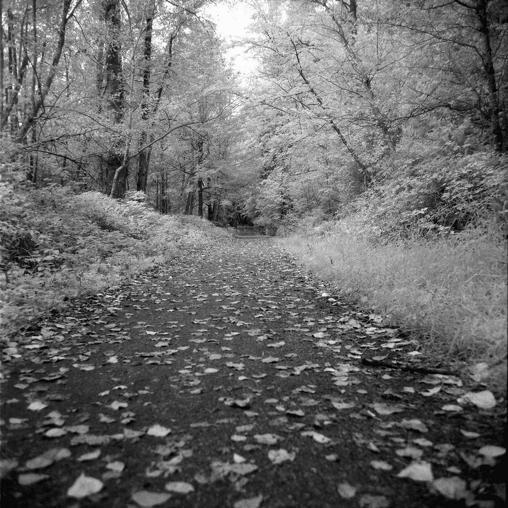

October, in the Pacific Northwest, using Ilford SFX:

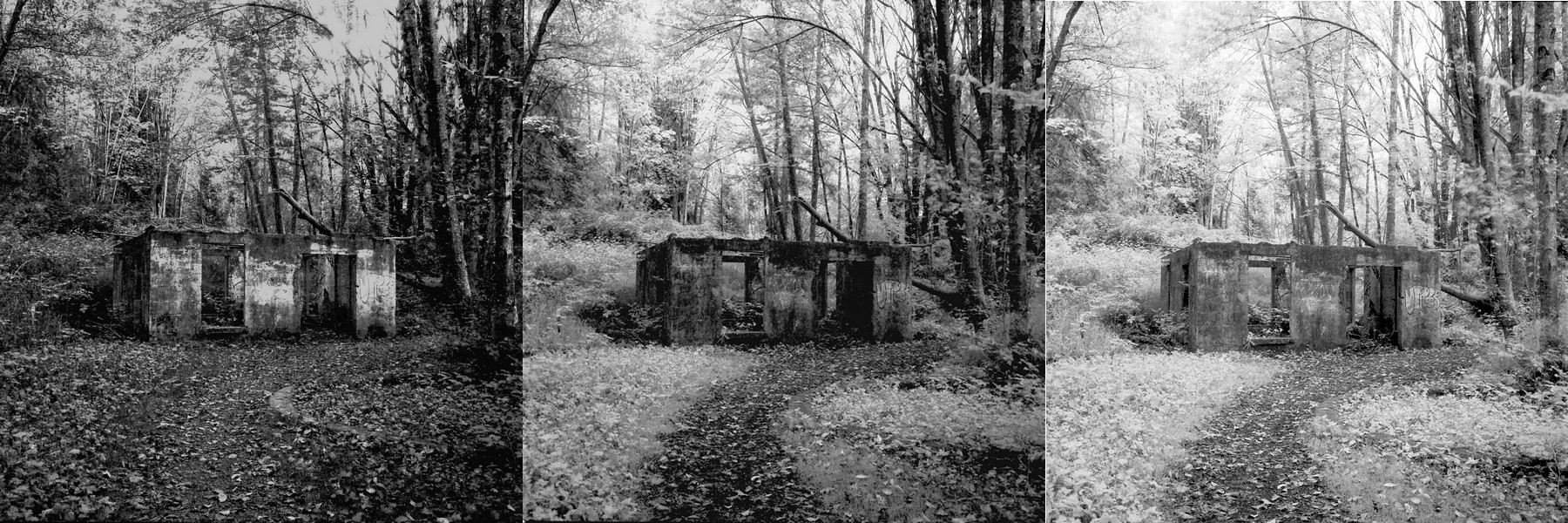

And on the same roll, from the same day, a Triptych comparing the results from three different exposure/filter options:

I don't have much experience with using it at the coldest part of winter, but it certainly doesn't require the heat of summer.
Don't you think telling us the exposure/filter options you used might be helpful?
I have shared it in other threads - it is actually part of a longer article.
I'll see if I can find the earlier threads, and link to them. The article itself is too large to be an attachment.
Surprisingly, I was able to find it quickly. This is from a post in 2010:
From a presentation I put together a few years ago, using Ilford SFX as an example:

Depending on the desired IR intensity I use, in increase Wood Effect and darker skies, Red23, Red25, Red27, Red29 and 720 [aka 72] filters.
