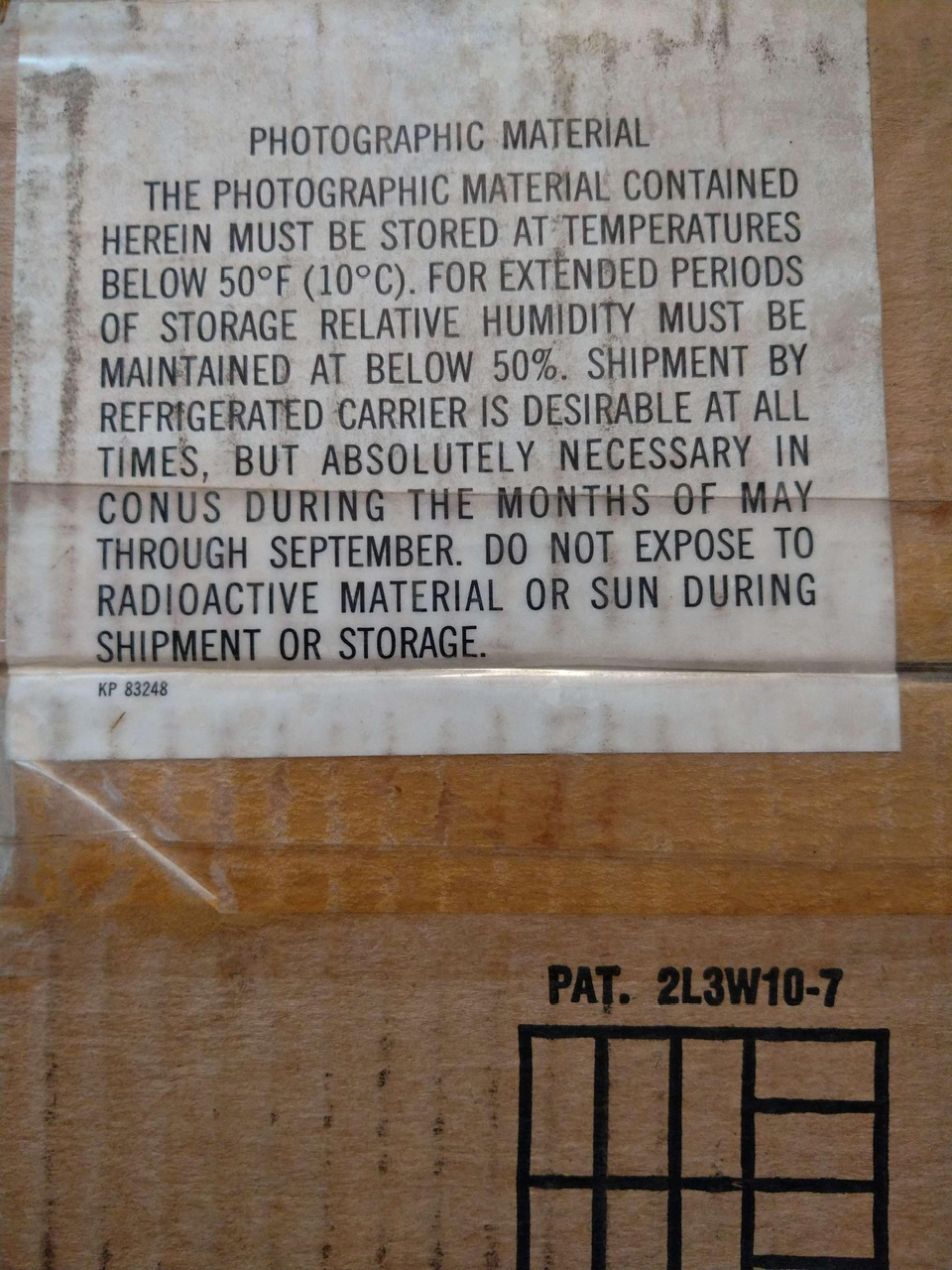

FWIW Kodak did absolutely say shipping some films with refrigeration was a requirement. This label was on the 2-roll case of 2465 that me and my friend split.
