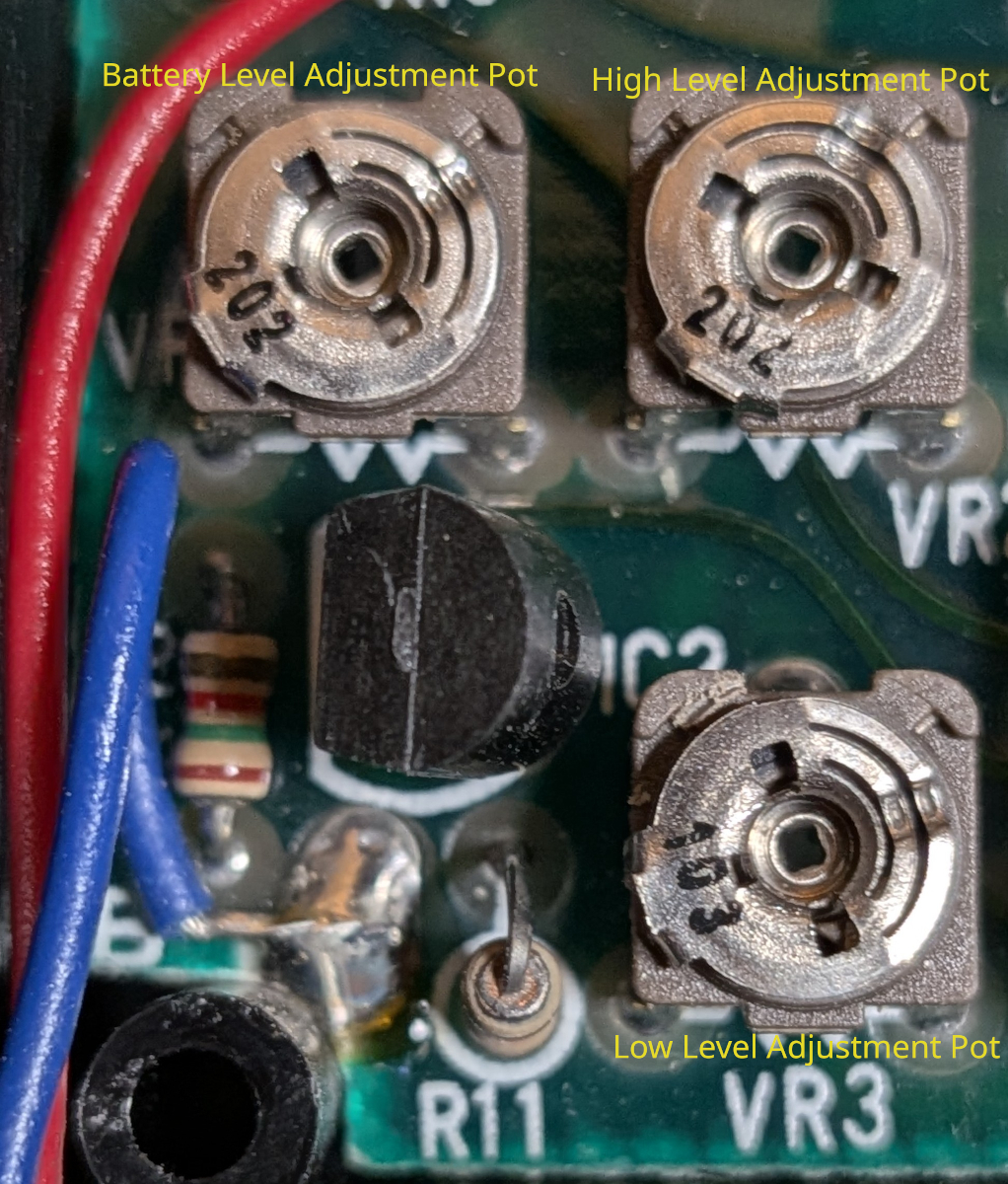

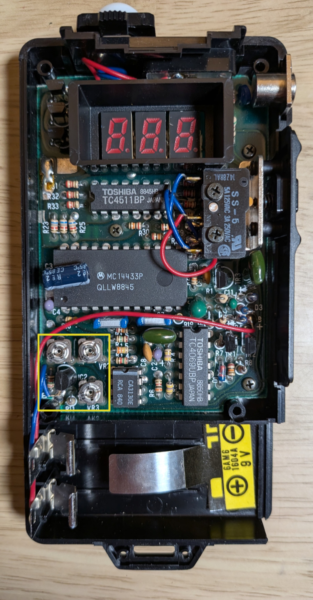

I must preface the calibration instructions with this important information. The instructions I found on Flickr stated that the top two pots were for adjusting for bright light, but this wasn't quite the case. I tried adjusting them but every time I measured the light it was still off. It wasn't until the low battery warning LED's started flashing in the digital display that I realised what was going on. I first checked the battery but it was reading 7.98V. When I adjusted the top left pot (VR1) to the right the lights stopped flashing. When I adjusted the pot back the flashing LED's came back on. Pot VR1 appears to be for adjusting the battery check level. It does have an effect on the calibration of the meter though so if this pot is adjusted you will have to calibrate the meter again. I'm not sure what the level is set to but, I would guess about 6V. I put the pot back to where I thought it was before I started and then left it. So there are two things I would advise before making any adjustments. One, is to mark the pots before you make any adjustments so that you can go back to where you started if need be. Two, I would not move pot VR1 at all. It shouldn't be necessary anyway, and it will make calibrating the meter a lot easier.

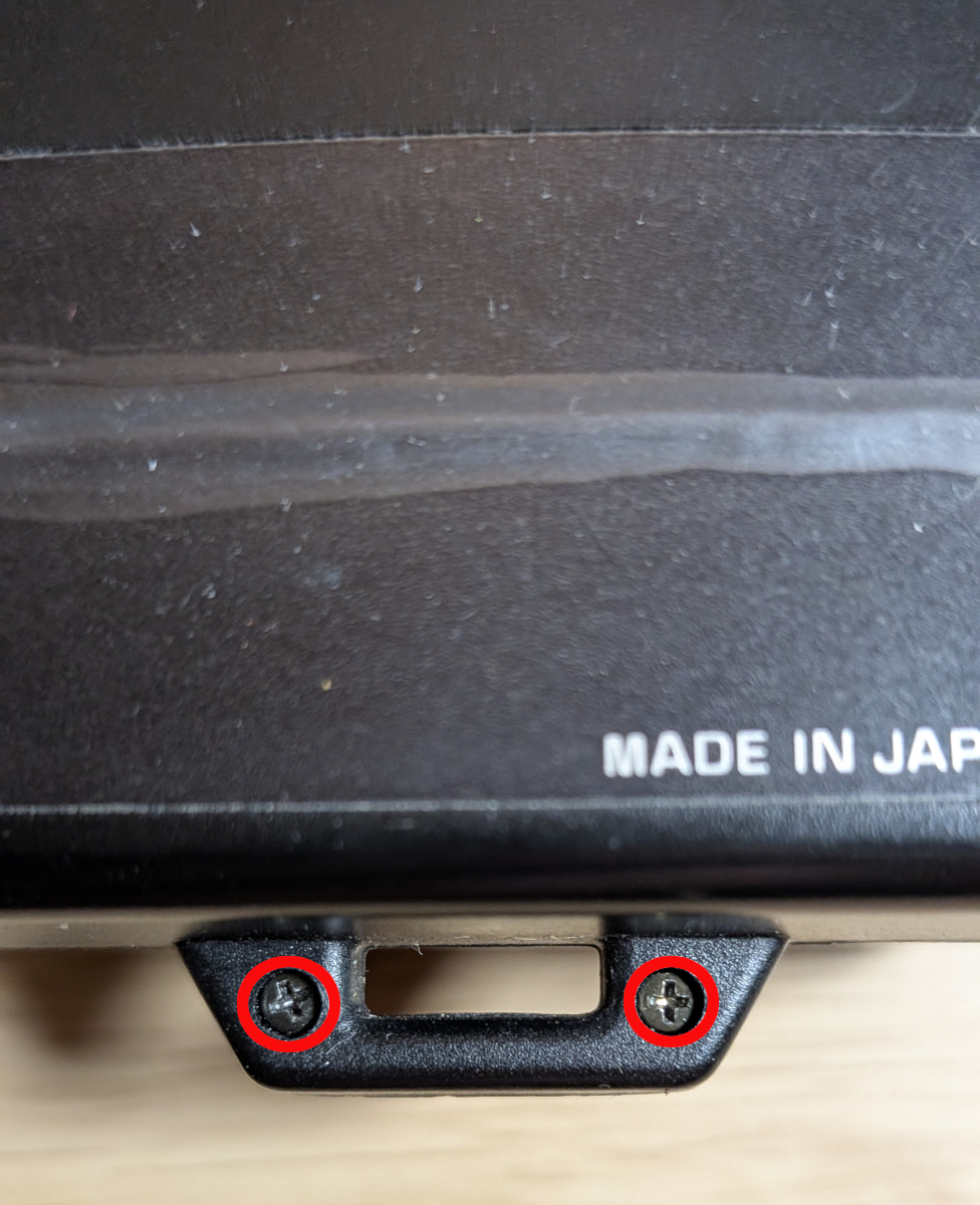

Once you have checked the meter it is time to open it up for adjustment. Start by removing the battery cover and battery then using your JIS screwdriver to remove the four screws in the back of the meter. I have highlighted them in the first photo. Next remove the two screws in the bottom of the meter where the strap attaches (see second photo). Once you have removed these screws the front will come off. The metal screw for attachments might come out but it isn't attached to anything and just slots into a space above the metering button. I was putting the case front on every time I was taking a measurement and then removing it to make adjustments (just holding it together, I wasn't putting the screws back in). However, I think the silicon metering cell is contained within its own light-tight housing, so you could just leave the front off and make the adjustments. The front of the meter doesn't need to be attached to use the computer dials. You would need to fix the battery in place with some masking tape or something though. Whichever way you choose to do it, you could also leave out the metal screw attachment and the lumisphere until you are done.
As I measured the low light level first I need to adjust the bottom right pot (VR3). If I recall correctly in order to get the meter value to go higher you adjust the pots to the right and adjust it to the left to make the value come down. Use the slotted screwdriver to make the adjustments. Turn the pot in small increments only and then take meter readings again with both the Gossen and the Shepherd from the same position. If it's worse then you will have to adjust the pot in the opposite direction. If it isn't quite right yet then just keep on adjusting and checking until it is correct.
Next we will do the exact same thing but adjusting for a high light level so set the light panel to full brightness. Take your measurements again and then this time you are going to make adjustments to the top right pot (VR2). Again just adjust in small increments and then check until it is correct. Once you have done this you will have to go back to the low light level and check again and adjust as required; adjusting the opposite end of the scale can have an effect. It is necessary to keep going back and forth in this manner until both the high light level and the low light level are metering correctly. It took me about half an hour (once I figured out that adjusting pot VR1 was throwing everything off each time!). When you have each end of the scale corrected I would check the meter against your calibrated meter at different light levels (I changed the brightness level of the Viltrox light and metered at 1%, 25%, 50% and 75%) and also check it in incident metering mode (using the lumisphere).
