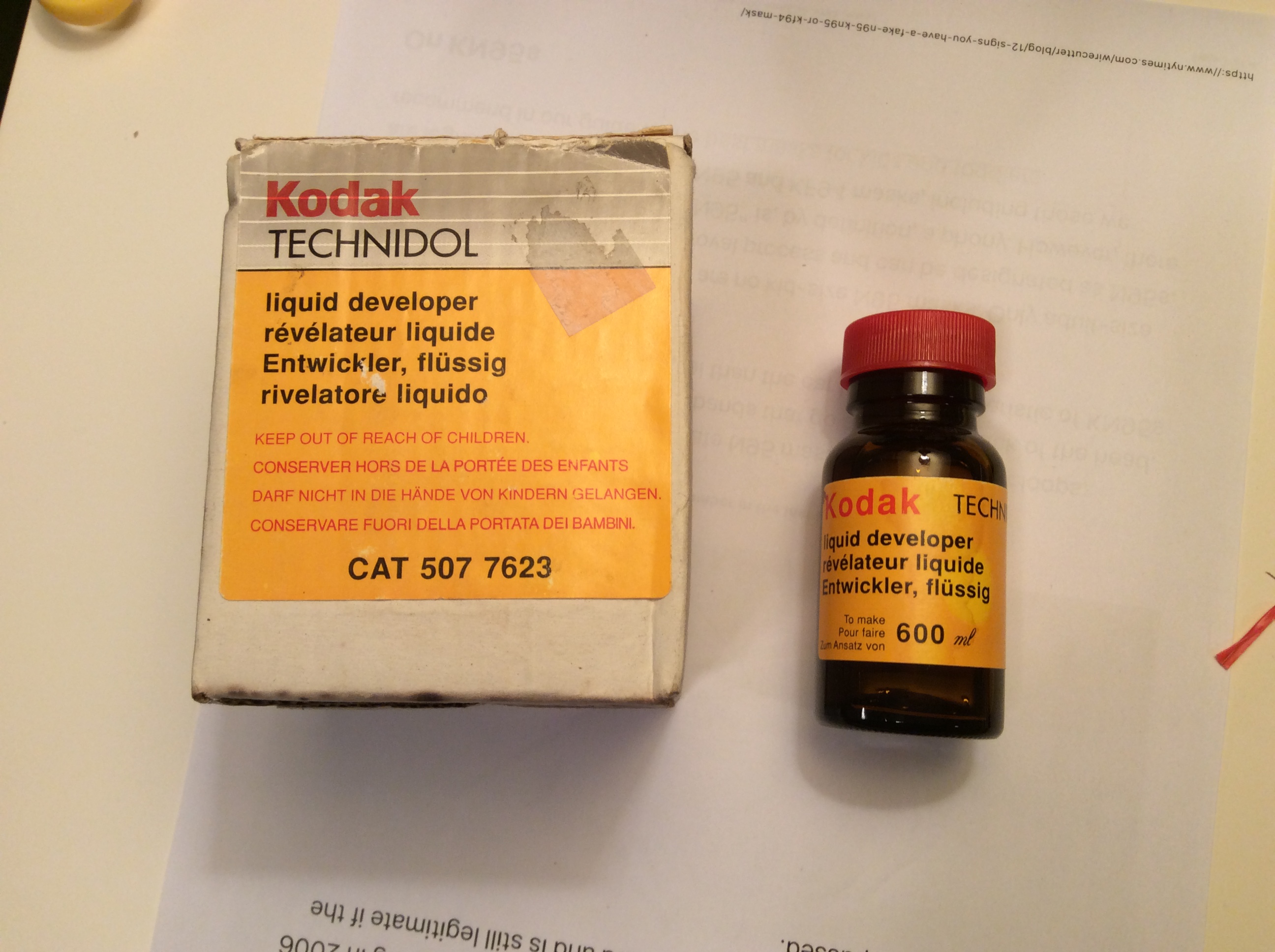

I have several glass bottles of Technidol, which worked just fine the last time I used some several years ago — see photo of bottle and box attached. That longevity is due, I understand, to the fact that the solution is made with glycol, not water, so greatly reduced oxidation. The solution in the bottles is clear. Mine was made in France by Kodak-Pathé, and I have no idea if the glass bottles might have been a Europe-only thing, with plastic bottles being used at other manufacturing sites.
