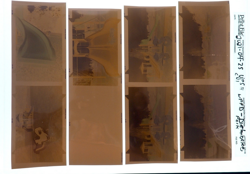

From an old roll of VPS - probably 25 - 35 years old before exposure.
Not properly stored.
Developed normally, after exposure in a pinhole camera.
The negatives (note the fog):
One of the pinhole images (after a bit of digital wizardry)
