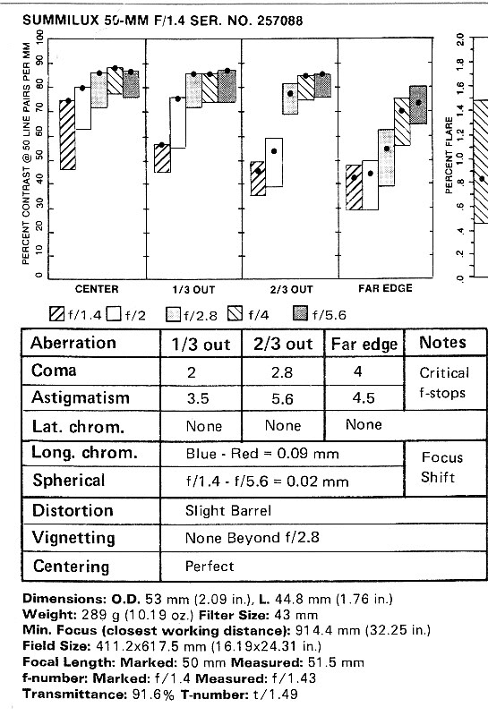

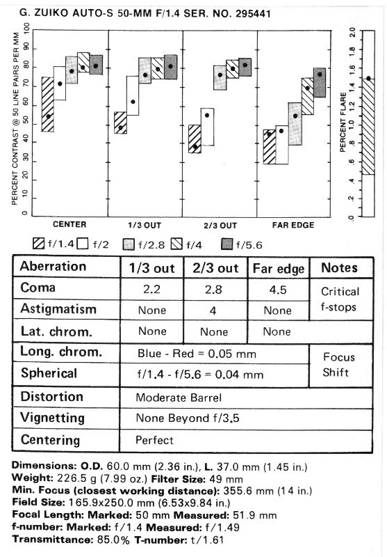

Wide open: Center and 1/3 out the sharpest tested by Modern Photography was the Summilux 50 1.4. However, at 2/3 out and far edge, the Leca falls behind the competition. For example this Zuiko 1.4 is sharper at the far edge and had less overall astigmatism.
