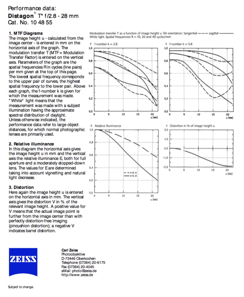

Not all 'name brand' 35mm format, wide angle, retrofocus lenses are sharp at the far area of coverage. Look at this Zeiss 28mm 2.8 MTF. In fact if you like 28mm lens on a 35mm camera, finding a good lens could take years. I used the Zeiss 28mm f2.0 (not the MTF posted) for years then switched to the Nikkor 28 f1.8, which is the best I have used to date. The manual focus Nikkor 28 F2 fared well in tests but I have never used one.
