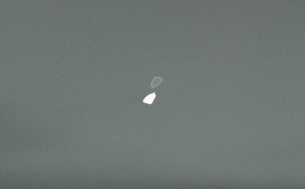

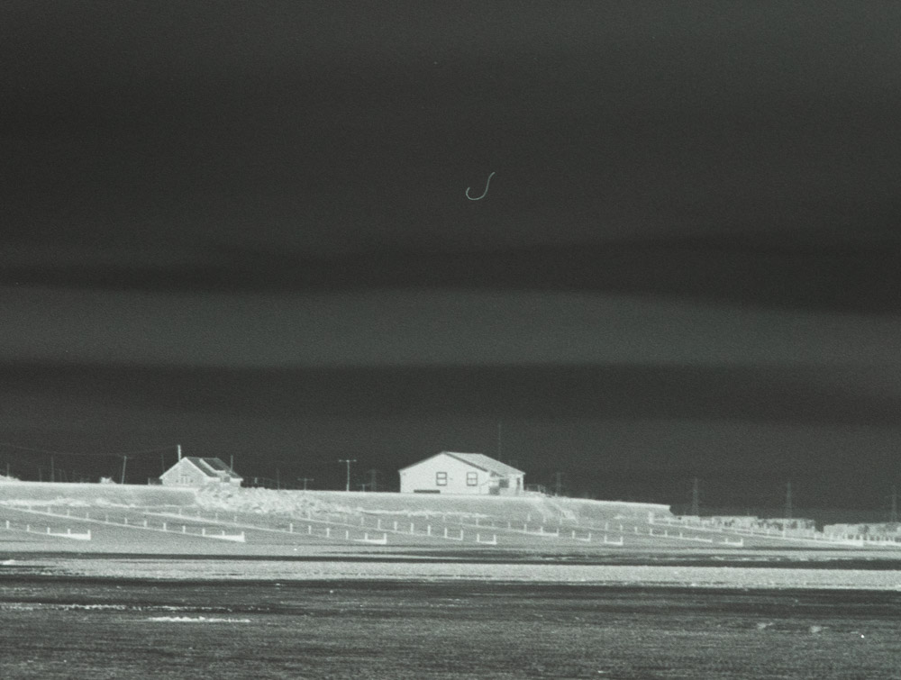

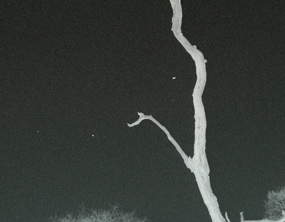

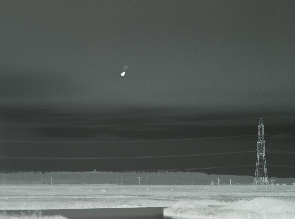

Here are some scans which might, perhaps, shed a little more light on the issue.
Clean out your camera and backs. You have muck floating around in your system that finds its way onto the film, sitting there while you expose the frames, resulting in unexposed 'shadows' of particulate matter.
Have done that several times now and will run a film through to see if any better. Thanks.
Try a distilled water stop instead of stop bath this time, or at least mix your stop bath with distilled water to see if there is a change.
@Kino While acid stop has been known to cause pinholes after a carbonate alkali developer, those are invariably round, with a "halo" of increased density around each mark where the gelatin has shrunk away from the hole and taken the image silver with it. Those look nothing like these irregular, sharp-edged marks, which are very typical of dust on the film at the time of exposure.
It is making me think it is a dust/exposure issue and have since used a hand blower, brush and compressed air while the mirror's locked up.
Check the darkslide slot.
The dust hides in there until you pull the slide out, and then it jumps out and flies around like a puppy looking for treats!
Thanks. Being light-tight how do you suggest I check and clean? Any tips?
Find out (from the manual or Hasselblad owners here) how to remove the dark slide with the back off the camera, and then inspect for debris, including particularly degraded light seals.
I'm guessing that you need new seals - something that needs to be done as part of regular maintenance.
Thank you for your suggestion.
Suggest very thorough inspection of the auxiliary shutter next to the film gate. A lot of air is moved during operation. Maybe even some antireflective treatment flaking has been reported on late model Hasselblads.
Thank you. I have given it a thorough clean with compressed air (held at a distance) and blower as well as using de-ionised water for ALL steps including filtering (twice through cotton wool pads) the fix. First signs are positive where, previously, I have had spots on nearly all images but now on only 2 or 3. The goal, of course, is to completely eradicate the issue (if that's possible) and so will begin a process of elimination by taking out steps to pinpoint where the problem comes from.
That you're only seeing this with your b/w film suggests to me its a processing issue, and not camera related. if it was equipment, then your slides would exhibit these issues as well. so now wondering how clean your tank loading room is. I don't know if dust would stick to the emulsion when the developer hits it, but I can't think of anything else.
It's actually very difficult to tell on transparency since static draws any dust onto the sleeves during inspection and what I am
looking for are tiny black dots so they may well be on there, too. With a B&W neg it stands out like the proverbial! Everything during development is spotless. One way to test would be for me to send a B&W film to a lab and see how it comes back.
