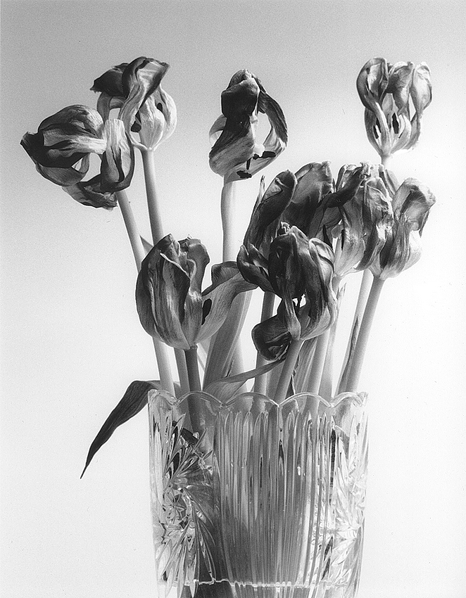

Ilford SFX is relatively grainy when exposed normally - without an IR filter.
IIRC, this was developed in HC-110, and scanned from a print:
