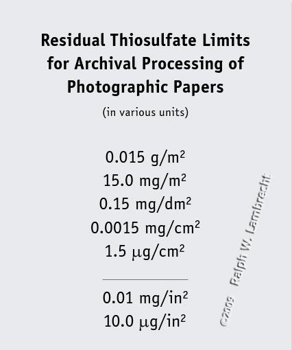

dancqu
Sep 7, 2002
3,649
Willamette V
mg? Have You Got That Right?
I use a Fixer Bath Test Strip
(http://www.silverprint.co.uk/ProductByGroup.asp?PrGrp=523)
to give me the Silver content.
I use 2mg for Paper & 4mg for Film as the limit ... Martin
I suppose that mg might be used but the dimensions
usually employed are grams and liters; eg, grams/
liter. See Ralph's following post.
I know those figures don't mean anything to me and
doubt they mean anything to Ralph. Dan
RalphLambrecht
Sep 19, 2003
14,658
K,Germany
Well, I stumbled over that one a bit too, but in the end, I decided to let it go. Any fixer contamination must be stated as mass per volume, grams/liter (g/l) works, so does milligrams/milliliter (mg/ml). So, using mg was not wrong per say, it was just missing the respective unit of volume. There are many ways to skin a cat:
