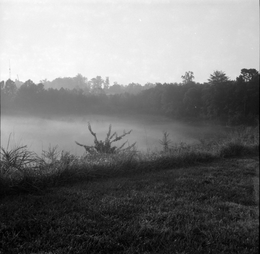

So I keep hearing -- yet after fourteen rolls, my negatives haven't changed from the first tank I did with freshly mixed tank solution. I haven't changed times, still using Massive Dev Chart times for box speed in Xtol Stock. For .EDU Ultra 400 (= Fomapan 400) I give 7 minutes, corrected for temperature, with agitation continuous first minute, then five inversions in 10-11 seconds each minute. Temperature typically runs 17-19C (the darkroom captures a lot of the central air). As an additional "howzat?!", I made a minor mistake making up the Xtol to volume (only had a 4 liter mixing vessel, so had to add more water as I bottled), and wound up with 3 liters of 10% under strength replenisher, for which I have not been compensating (figuring it was too little to matter in the negatives).
.EDU Ultra 400, Xtol Stock (one of two rolls, first in the newly mixed stock solution, 6/28/2020, newly exposed that week)
.EDU Ultra 400, Xtol-R (one of two rolls in my most recent tank, 9/20/2020, exposed, best I can tell, around 2010 -- actual count, those were rolls 13 and 14)
Scans with Vuescan, "auto levels", which will smooth out some variation, but the histogram also hasn't changed.

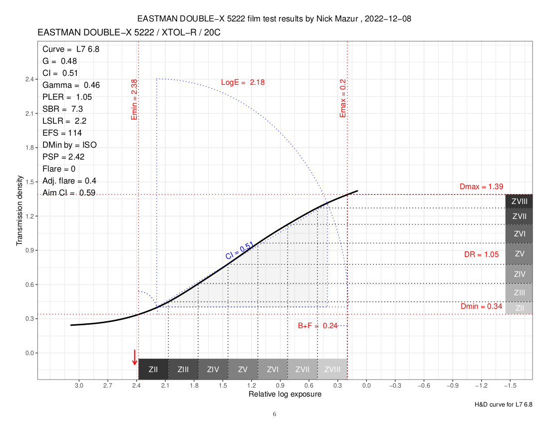

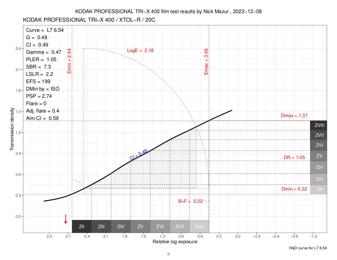

I have preliminary times for KODAK TRI-X 400 and EASTMAN DOUBLE−X 5222 in XTOL-R in a Jobo (1540) at 20C. These are hypothetical curves for the "normal" LSLR=2.2, and they are 6.54 (EI125) and 6.8 (EI 200) minutes, respectively. That's without accounting for lens flare. Depending on your lens, if you include lens flare, you'd have to extend development time up to about 8 minutes. Given how close these two films are, I would not hesitate to develop them in the same tank, if I happened to have both at hand.
kodakXXXCombinedraw_dataPlots.pdfrelativeDescending_finalNormal.pngkodakXXCombinedraw_dataPlots.pdfrelativeDescending_finalNormal.png

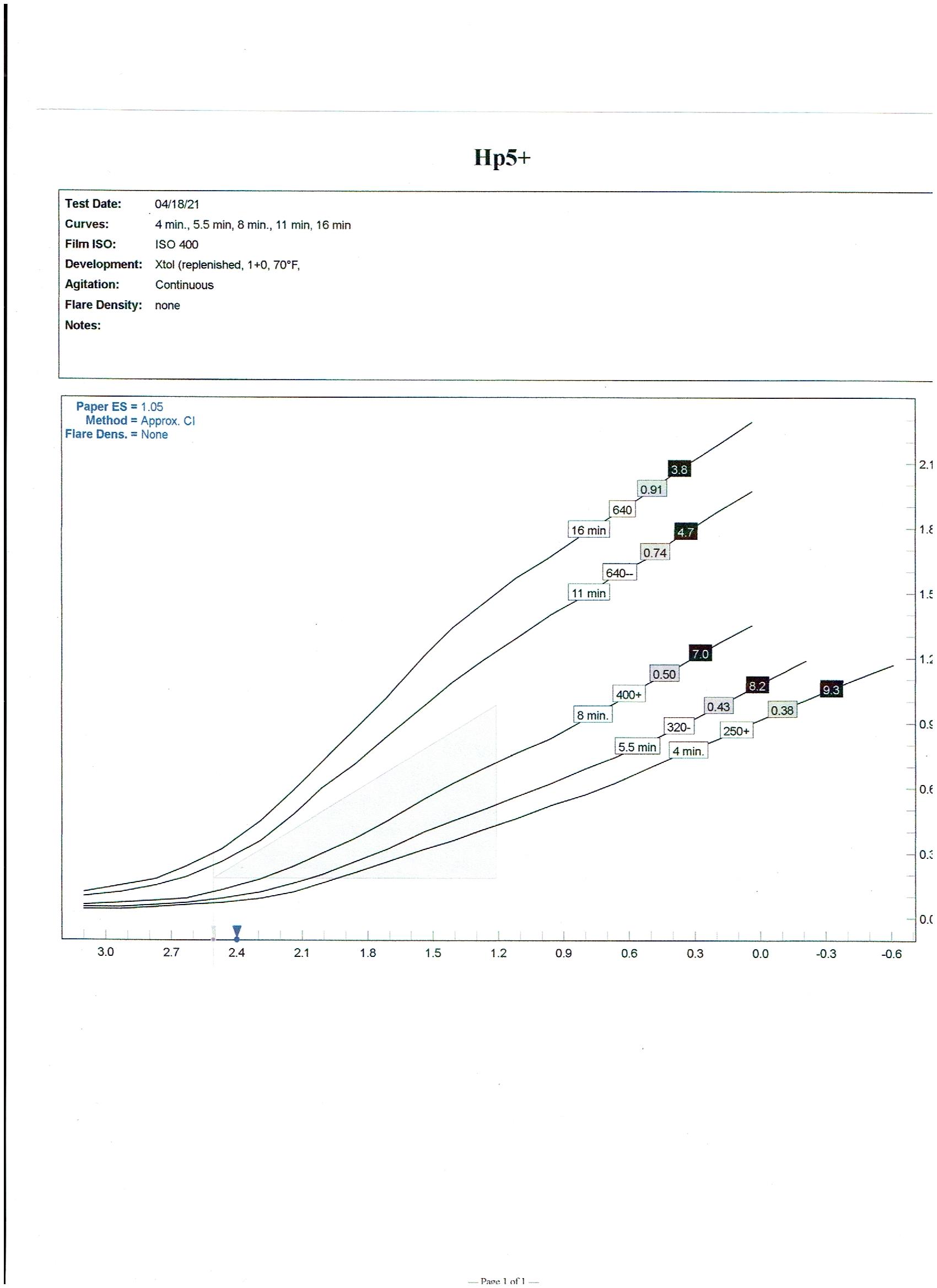

I have done all the densitromety for HP5 and my replenished time in a jobo at 20°C is 9:30, with as aim point contrast index of 0.62.
Here is my developing chart:

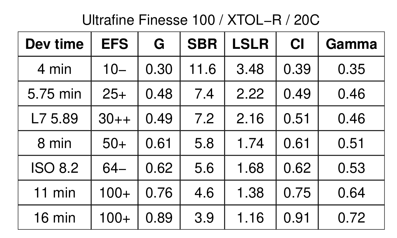

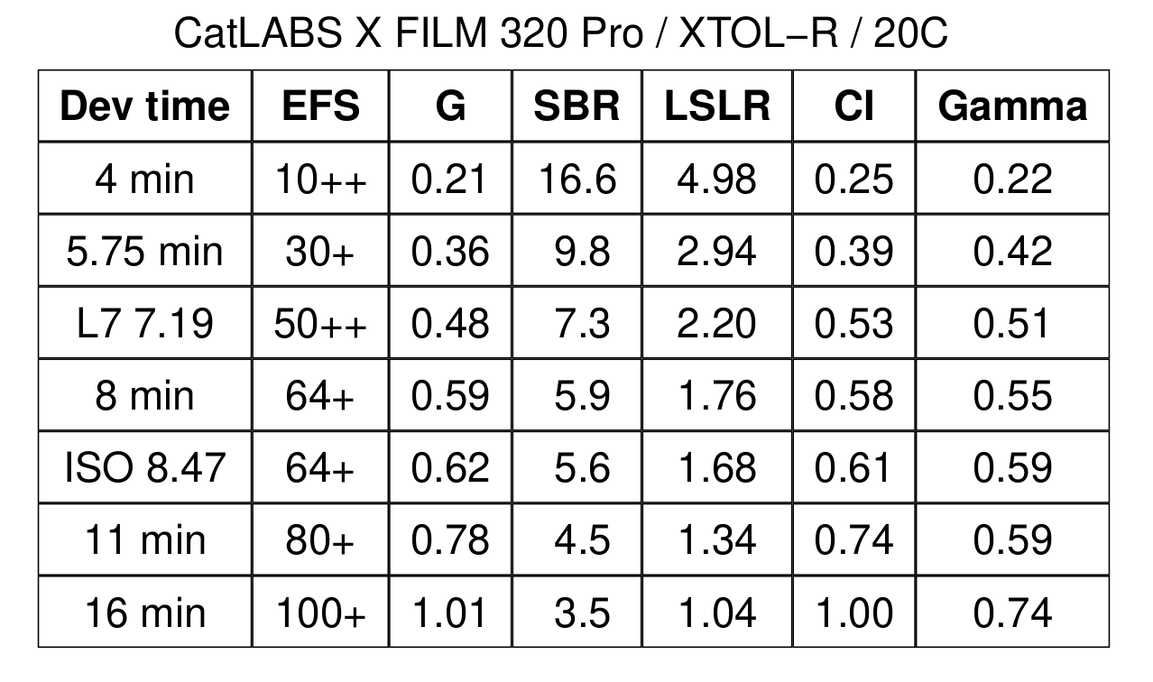

I found two more development data tables for Ultrafine Finesse 100 and CatLABS X FILM 320 Pro in XTOL-R. The CatLABS film data should be applicable to Rollei Superpan 200 and other films based on the Aviphot 200 emulsion. The Finesse 100 is a bit of a mystery. It is a surprisingly nice film, especially in XTOL-R. I have been enjoying it very much. For "normal" scenes, locate the row marked L7. To predict CI with flare, simply pick the next row - the eight-minute curve. It's not exact, but will get you in the ballpark. If you're interested in more details, let me know. I have pages and pages of data on these films :smile:.
catlabs320XTOLCombinedraw_dataPlots.pdfabsolute_final.pngultrafineFinesse100XTOLCombinedraw_dataPlots.pdfabsolute_final.png
