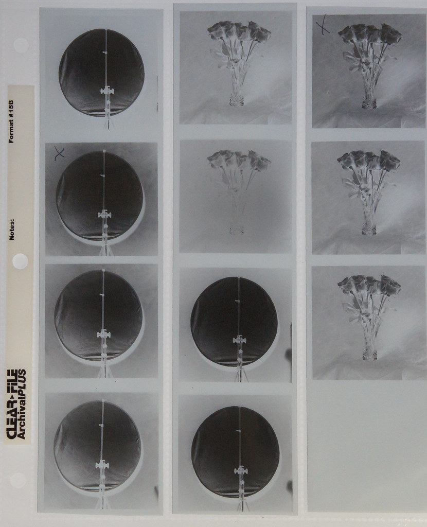

Shanghai 220 in D23 one to one by Nokton48, on Flickr
  • Testing the new Shanghai 220 emulsion. Some flash on camera my old wedding flash Vivitar 283 various settings to see how it responds. Also a still life (Valentine Roses) using 250W modeling light in Broncolor C171 Monolight with 80x80cm Pulso Softbox. Silver fill on right side. Exposures ran very long out to 30 seconds.
What are these photographs suppose to show?
In the left photos I'm testing aperture settings with a portable strobe. In the right tests I exposed progressively longer exposures out to 30 seconds. Wanted to see how it responds to long exposures. Finally, I wanted to know if I was going to get surface defects. Which I dd not. I agree ISO 50 is about right for my upcoming uses. It responds to longer exposures very well!

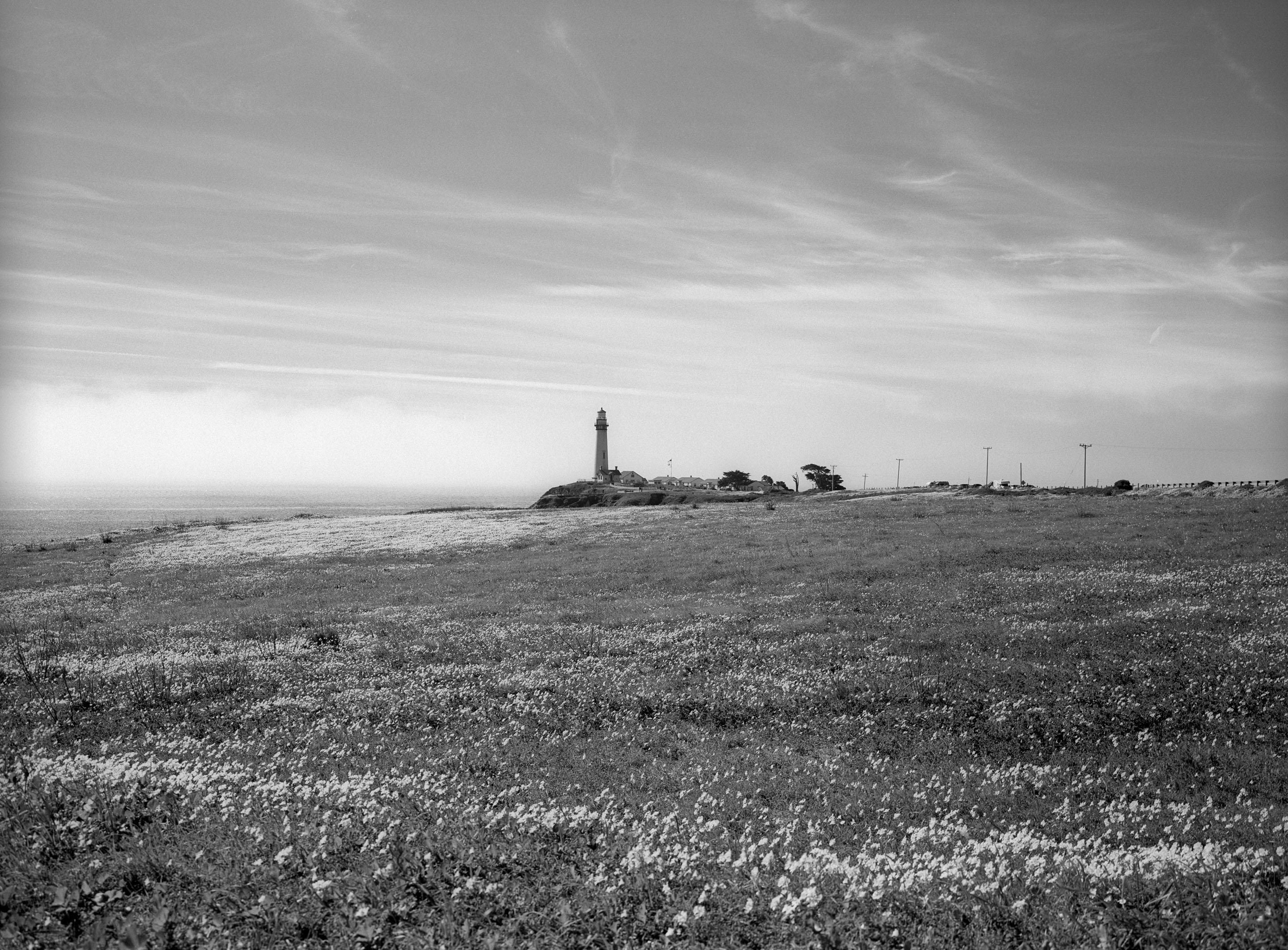

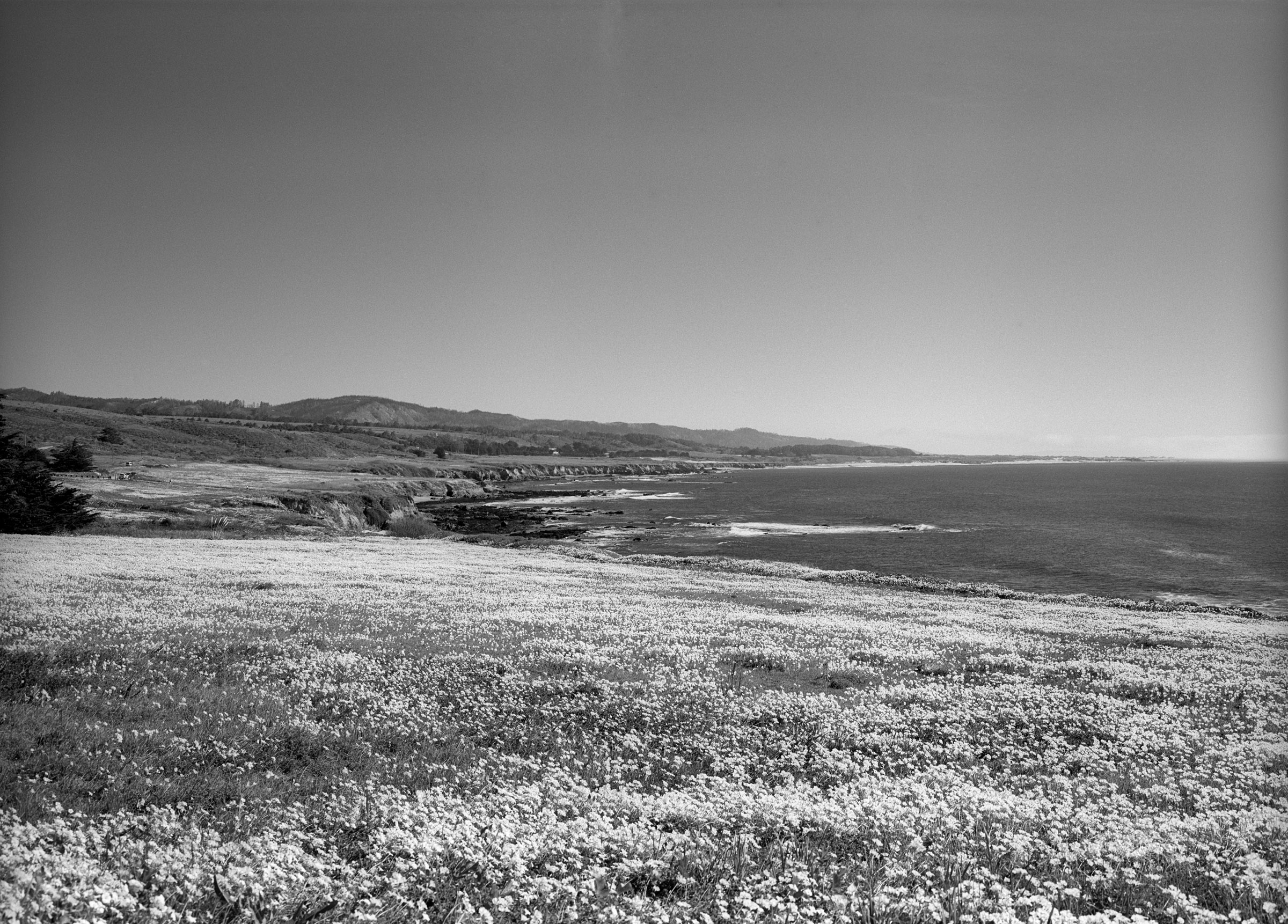

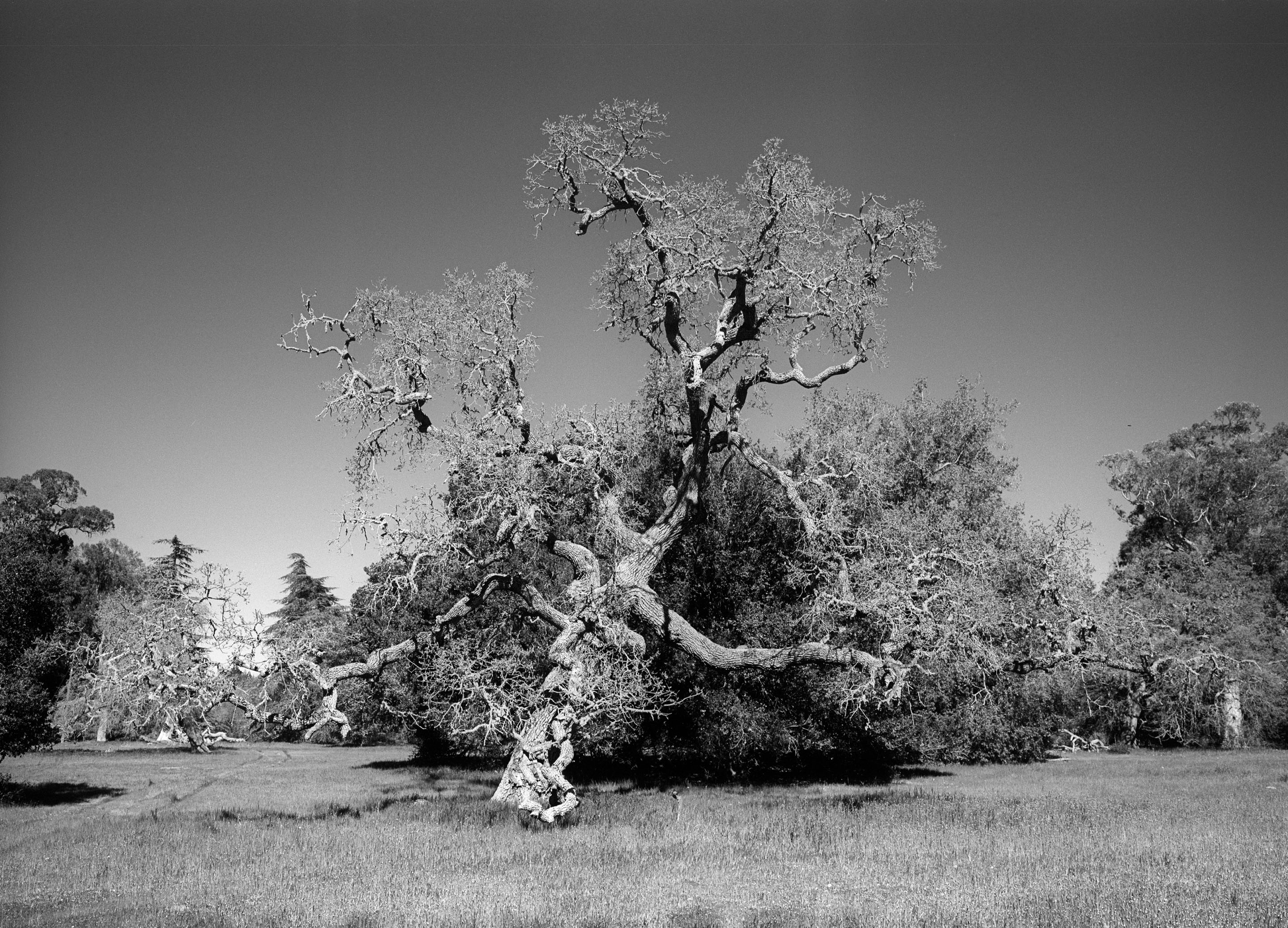

here are 3 more examples. all shot at 100 with an orange B+W filter developed in pyro-m. lots of contrast and black blacks. shot with a fuji GSW 680iii. pigeon point lighthouse one facing and the other turned around 180 degrees. the mustard flowers are out in full bloom all along HWY 1. the fog was really coming in fast and the wind really picked up, so forced to shoot almost wide open to keep the flowers from looking like a mess. I have yet to develop the velvia film yet but looking forward to it. the oak tree is just one on my daily walk that I have been shooting off and on for 20+ years.
Beautiful! And at ISO 100, go figure..
John,
These older style emulsions do work very nicely with Pyro developers. Your shots here prove it. I have two boxes of 4x5 in the freezer, but will be picking up a few rolls of 120 for some shooting in Spring. JohnW
the reason i posted the above shots was just to show that box speed was fine with this film. I have shot this in 120 using 50 and also got great results. but with the wind I needed all the speed I could get and wanted the filter to bring out the yellow flowers. sometimes testing and geeking out can be fun, educational and motivating. but in this case, it was just geting out and enjoy the strange warm weather and shoot a few shots while i was there.

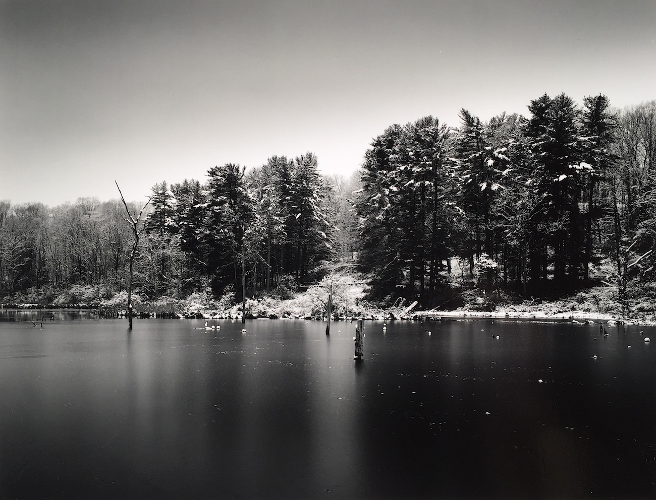

I tend to downplay film type in creating my images in the darkroom, but in the case of Shanghai your images reminded me of prints I have been making from Shanghai 8x10 negatives like below.
