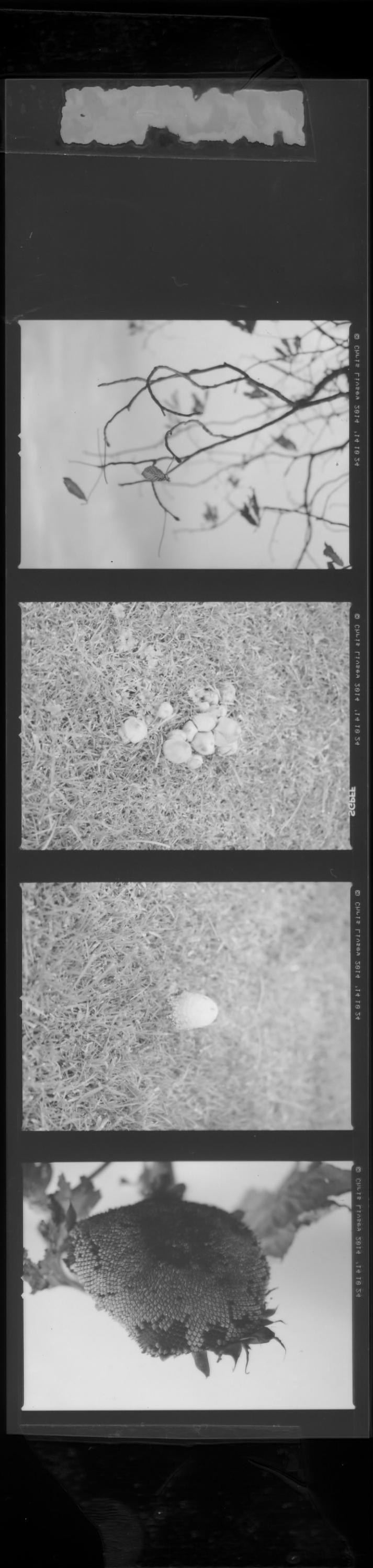

Quick update, test roll in Pyrocat HD 15 mins semi-stand, still drying but shows good contrast and two clear frames mid-roll (deliberate) are clear of any backing paper print through it appears. Closer check when dried. I see what is meant by the film inprint it is just on the edge of the frame (6x4.5) very annoying if you like to scan including frame margins. The Hasselblad H1 inprint is well inside it !!
Looks like previous observations on base density are correct, very low visually. A reversal candidate!!

Just on the document scanner/printer as my flatbed is O/S, maybe a new 850 lies in my future?
Shows the print down RHS, as viewed with logo impinging on the frame in the second frame down.
