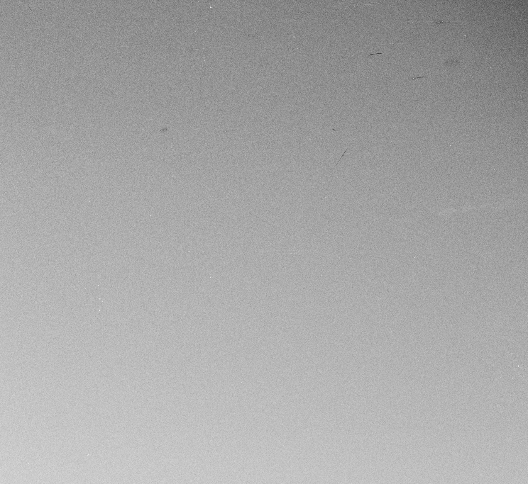

there are a few of what appear to be emulsion defects. a few zits or the like and a few scratches which I sometimes get in 220 B&W films. if the uploaded images need to be larger so better view them i can try to upload larger jpegs. Im not sure how i feel about the emulsion issues. while there are not many, if i was going to wet print them it could be an issue. scanning, would take a few minutes in photoshop to clean them up, but i always want a neg I can wet print.

now the images. Im limited to the size that can be uploaded to the site. I hope they are good enough. the last image is a crop of the sky with some of the black zits i talked about. hard to see them on this small a file

@destroya, thanks for the review! Even though there are some "black zits," in the sky, the quality is better than I expected, based upon previously reported issues with Shanghai film.
Very nice! Looks like they fixed a lot of the quality issues.
