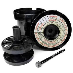

Have taken it apart for a thorough scrub and find I truly have not even been taking enough notice of it to get the brand right. Been using it without a second thought - one of those things that 'just works'.
It's a battered Johnson/Nebro 'Universal' film tank. Like this picture, but without the shine. Like the Paterson 'Major'. Has the nice spring in the bottom and side spout is handy.
Science museum says it's 1959 at the latest 😳.
Perhaps it's time to send it into retirement as a plant pot. Think I've thrown the box away already (could no longer stand the smell ).
