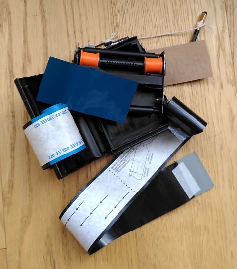

So this was a surprise - and darkroom surprises are not my favourite kind.
Either the longer 200 film builds too much friction in my old Paterson reel - entirely possible as it is no longer very smooth - OR 220 film is too long for the reel 🥺. I ended up cutting off the first 6" 😕. Sadly there may have been an image in that first frame but was not sure I could face unreeling it all to start again. Particularly because I was still uncertain about which side was emulsion and it is very curly, presumably because it is wrapped so tight to get it on the reel.
Next surprise - the film support on Shanghai GP3 stock is blue! I'm sure the non-emulsion side of film can be any number of colours and this one is blue. It feels a bit different too. Will be developed in Caffenol later this week so we'll see what comes out.
For now I'm relieved to have got most of it into the tank more-or-less safely; snakes in a darkroom!
Grateful to Nik and Trick and GP3 Offical Account for the chance to try this. If it works well I'm sure I'll get more practiced at handling it.

I've just developed and printed a roll of Shanghai GP-3 220 roll film and it does not look like the film the OP encountered.
My film went perfectly on a Paterson reel, not too short or long, and developed nicely in replenished Xtol. The film base was clear not blue.
The backing paper was black both sides with the leader reading "120 film start" and the tailer reading "120 film exposed". The little white gummed tape that held the roll closed read "GP3 100 220 film".
Curiously the film itself has no maker's name or frame numbers, just all blank.

the blue is proably the anti-halo dye which disolves or become colourless in the developer. this is why some times you get brightly coloured developer when you empty a tank
The anti halination dyes add color and excitement to home development. No harm, no foul.

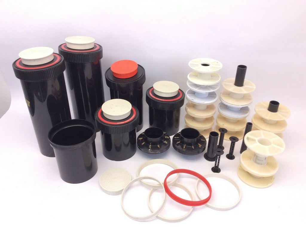

I started out on older Paterson tanks when I started developing-- the experience drove me to vintage Nikor metal tanks and reels. That twist agitation would always extrude film, I think because it was the same motion one loaded them with. And loading was kind of a crapshoot anyway-- after 8 years I do now own a couple metal reels that are as hard to load as the Patersons were, but it took that long. If you've gotten good results from Patersons before this 220 imbroglio, you're a better person than me!
I grew up with this Paterson tank (literally) and I'm used to it, but I more often use an even older, simpler, Nebro nowadays. I find the Nebro loads 120 easily, despite having no back-and-forth option. It's also smaller and so uses less chemicals.
Picked up the Paterson this time because I assumed the larger reel might be better for the longer film. Once this first 220 film is developed I shall measure it against both reels, including the few inches I cut off!
I've seen the vintage Nikor tanks for sale too and will now take a closer look, so thank you for the recommendation 😀.

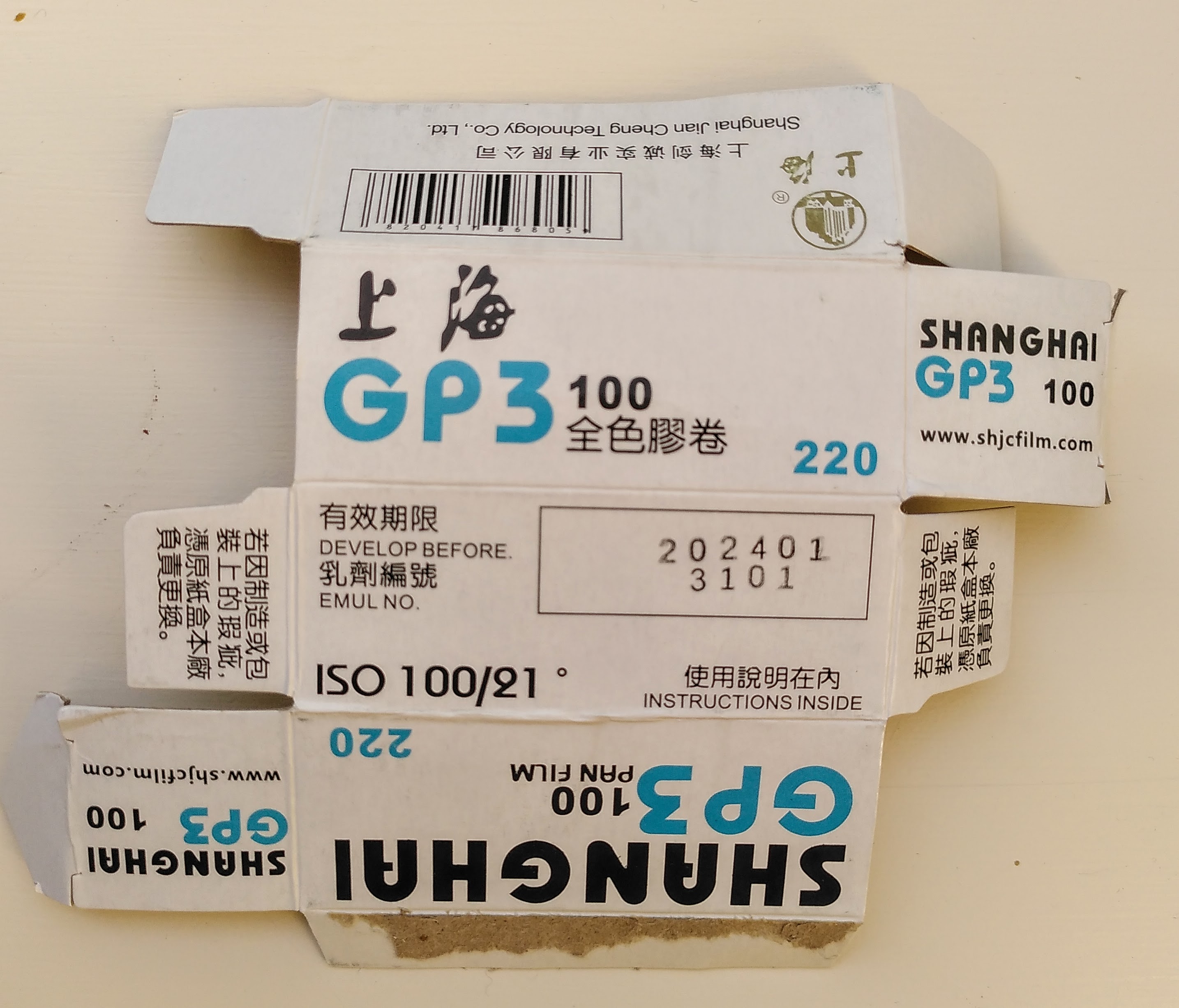

Because it was my first Shanghai 220 film I did a series of bracketed exposure tests. With my Sekonic L-758D meter and my usual metering method to support Zone III shadow detail I had to set an E.I. = 25 without a filter and E.I. = 3 with a #25 red filter. The slower speed was a surprise but not a problem because I shoot everything off a tripod anyway.
There is surely more than one version of Shanghai 220 film out there. My film came in a white box with Shanghai Jian Cheng Technology Co., Ltd as the maker.
Should have included the box in my picture. I'll hunt it out later. Thank you for sharing your exposure experiments. I always use a tripod too and I'm tending to longer exposures while I learn the ins-and-outs of my big reflex camera. More data always helps 🙂.

Any modern Paterson reel should take 220, assuming it's not more than a few centimeters longer than twice a 120 roll. I routinely load two 120 rolls in mine (randomly choosing from seven reels), one after the other. If you don't process 220 much, there may be residue in the grooves; after you unload, pull the reel apart and go over the groove side of the plates with a toothbrush under warm running water, rinse fully, and air dry. Some folks then run a soft pencil along the grooves to add a little lubrication, but I've never done this.

Paterson (and Paterson clones like those sold by Freestyle) are made to accept 135-36 and 220, as far as I know. The design of the reel plates hasn't changed since 220 was widely available. If a 220 roll hangs before it's all the way in, it's very likely a 135-36 will as well. My Paterson reels accept overlength bulk loaded 35 mm up to about 40 frames, anyway -- that'd be 144 cm plus any leader that gets left on.
If 220 won't go all the way in, it's probably due to residue built up in the grooves near the core.
