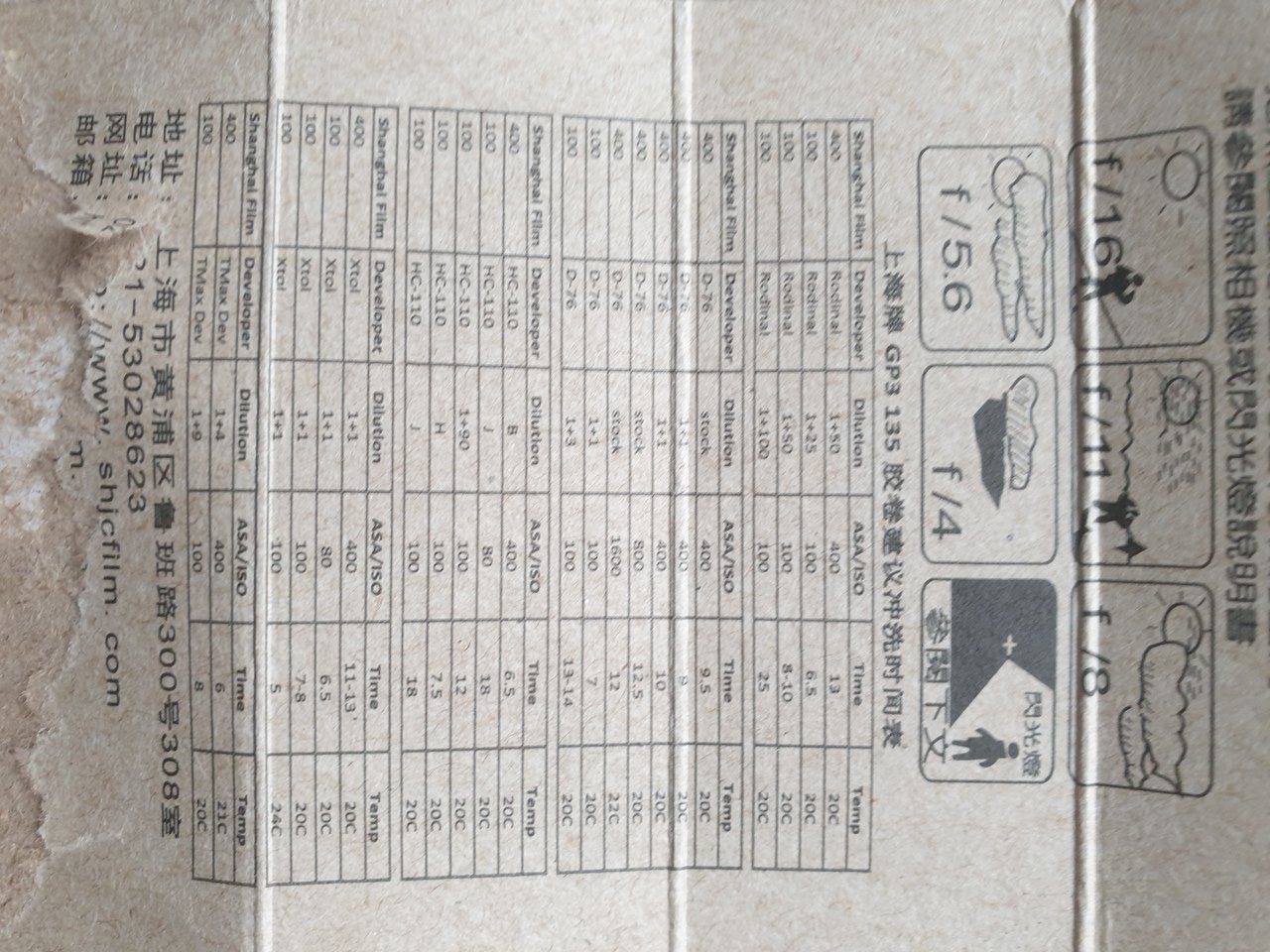

Ah, yes. I hadn't opened the box yet. Inside are times for D-76, 7min in dilution 1:1. I'm going to use that.
Can you post the times here? or the table? So we have the official source.
Thanks for the sacrifice you did in the name of us Apuggers.

Here you are:

Here you are:
Your kindness is getting legendary proportions.
D76 1+1 is 7 minutes, much more reasonable.
Massive dev chart says 14 minutes. Once again, MDC is full of 'it...
I thought massive development chart used a very specific development process.... the one i found on there site for film is NOT the same as what is written on the inside of the foma 120 roll i opened up this afternoon... and the process difference resulted in like 2 minutes of difference between the two methods.
