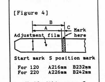

Yes, but it appears you could use the 120 start mark as well. From bronica ETRSi back service manual, the adjustment of the start mark position section; i infer the position is more or less similar.
It all turns on where you end the leader and attach the film. I believe that you will need to use a slightly different position for the tape that attaches the film to the leader in order to re-use the Start mark.
