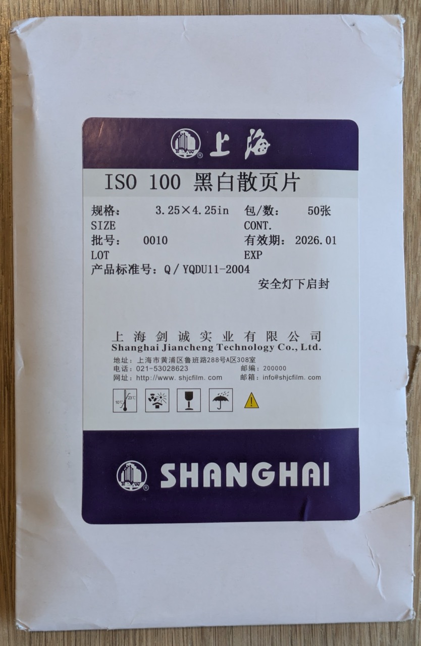

I received a fresh Shanghai GP3 3.25x4.25 50 sheet pack today (bought from eBay seller mytongguy), and they load without any problem to original Graflex double-side film holders. This pack shows batch number 10, so I guess the factory might have improved since. I'm not associated with the manufacturer nor eBay seller, just sharing the information for other 3x4 photographers.
I'm curious what the actual measurements are after you develop it.
The Shanghai GP3 100 film from factory batch 4 has the following dimensions: 82 x 108mm (or 3 3/16 x 4 1/4).
It barely works with Mod54, but there is risk of popping out if the agitation is less than gentle. On the other hand, 9x12 film works totally fine with Mod54.
I probably under-exposed and under-developed the film ( I was using Clayton's F76+ 1+9, 7 min at 68F), so I'm having some strange mottling issues with image. I will do a bit more test before jumping into conclusions.
