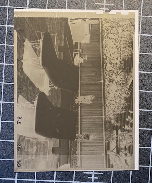

I think this was a bit more than an approximation error.

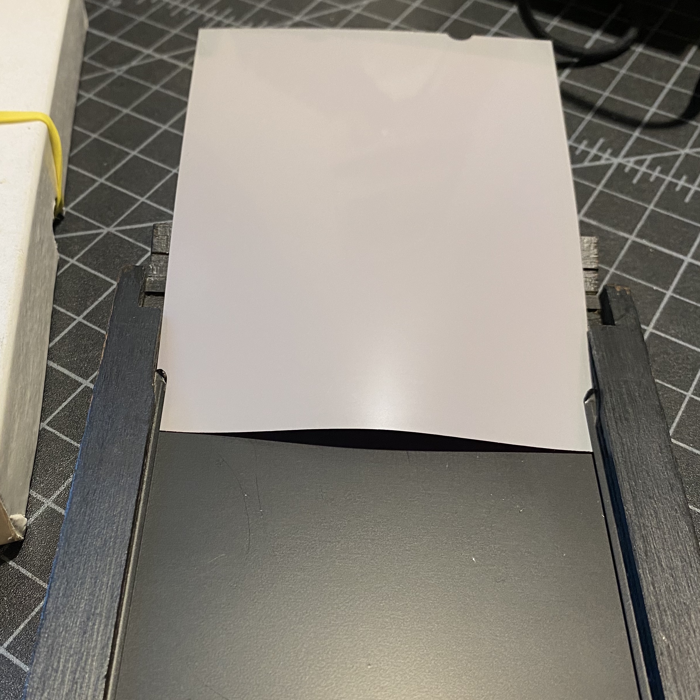

I’ve been going back and forth with the seller about this, they seem convinced that it’s the correct size. This was the response.
I just asked the agency, the size of the films is 3.25x4.25 inches, it's not wrong,It's the true 3.25x4.25 inches.
You need to insert the film through the gaps on both sides, please try again.
I also pointed out that 4x5 film is actually 3-15/16”x4-15/16”.

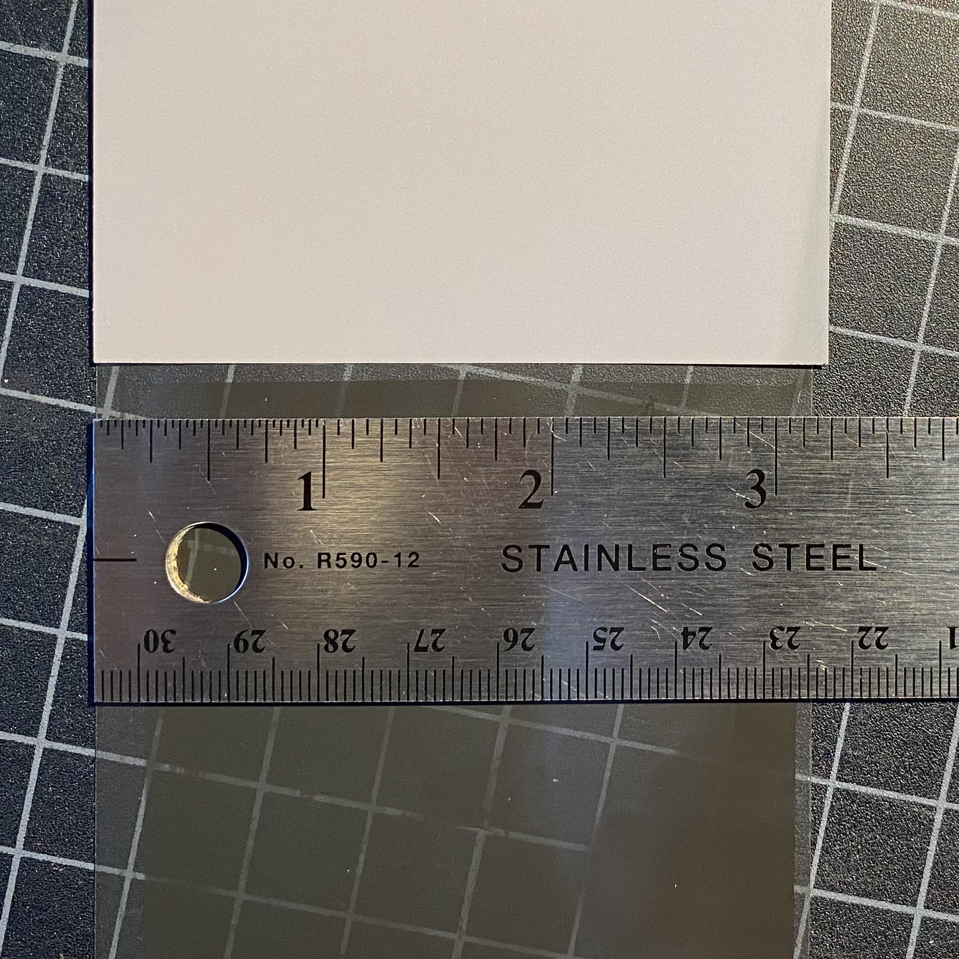

The photo below shows GAF Versapan 3.25x4.25 film on top of Shanghai GP3 film to illustrate the size difference.

I have 12 Graflex holders, I just checked it with 10 of them, both sides (2 have film loaded), the Shanghai film didn’t fit in any. Can you measure the width of your Shanghai film?

They misquoted that thread in their latest response.
Dear customer,
Our film sizes are correct, 3.25x4.25 film is actually 3.25x4.25 inches, Kodak's 3.25x4.25 film is also 3.25x4.25, our films conform to Kodak standard and industry standard, please see the link:
You can see your photo, width is 3.24-3.25inch, about 3.24inch, a little smaller,
Shanghai boss said they've sold so many, and no one has ever commented that they don't fit, and we have sold a lot of this item on the platform, but no buyer has reported a problem like yours. Hope you can understanding.
If this is too big for your film holder, you can cut the excess inside the darkroom. Hope can you help you.
