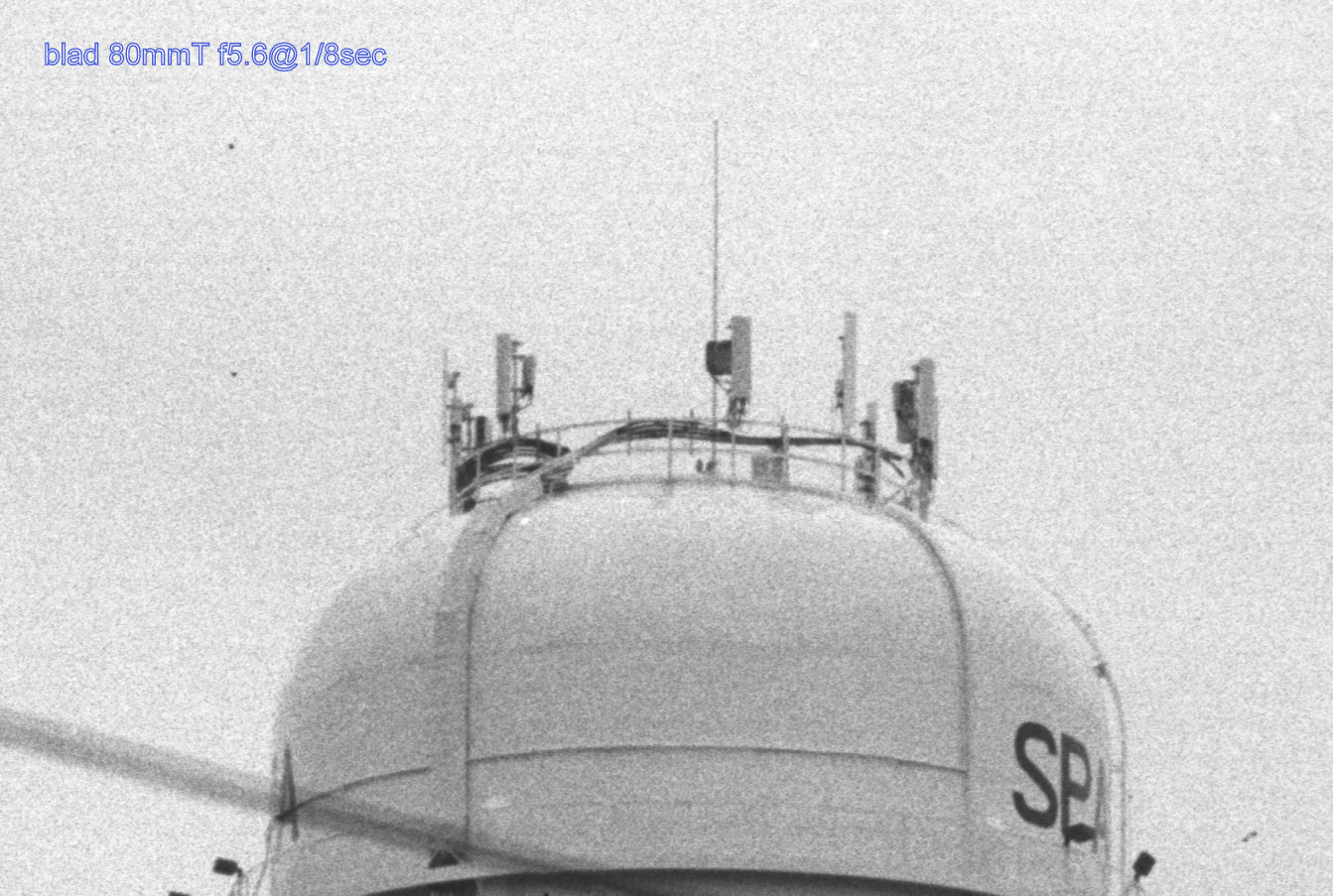

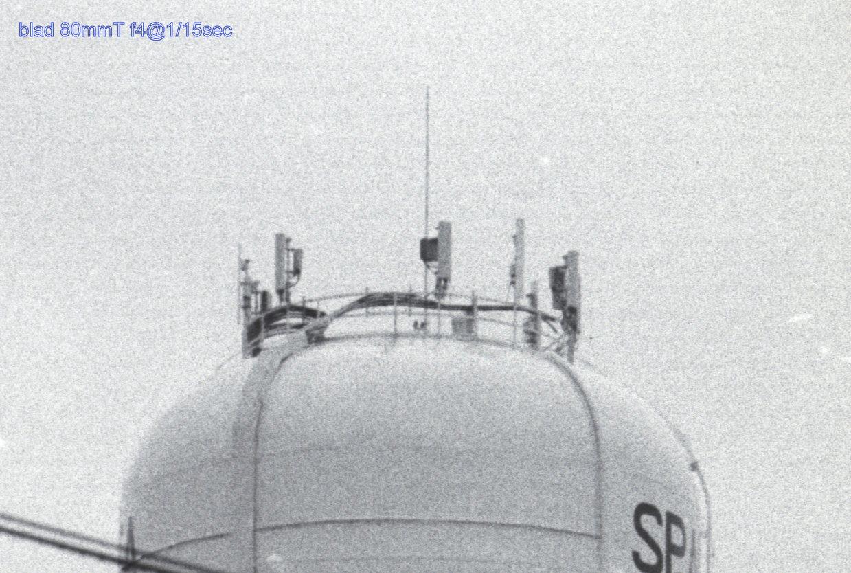

Make sure you keep us informed. I just ran some through my old 500C with 80mm 2.8 *T* lens and souped it in Pyrocat-MC semi-stand and they are super. I've only scanned them so far, but they sure look like they print just fine. I'm going to load a back with GP3 and a back with Ultrafine-Xtreme 120 ISO100 and do both in Pyrocat_MC. I'll scan and post a couple of shots to compare each and post them. John W

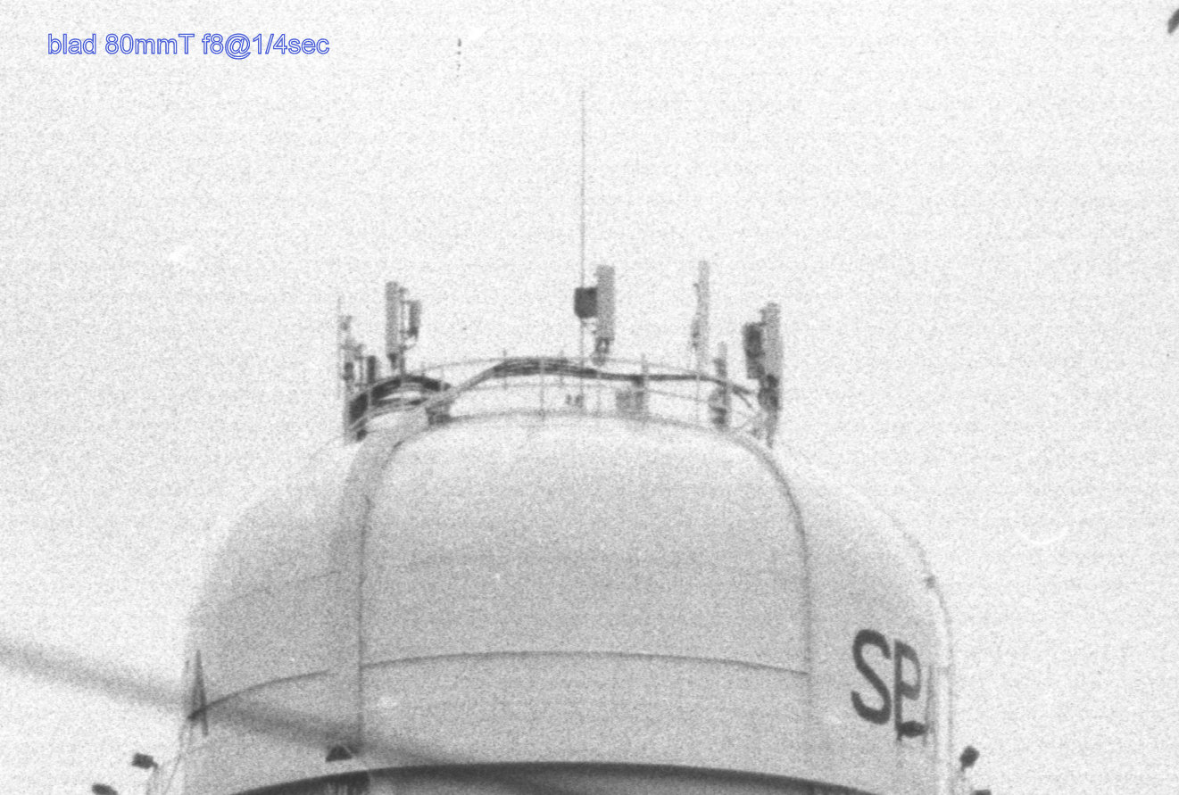

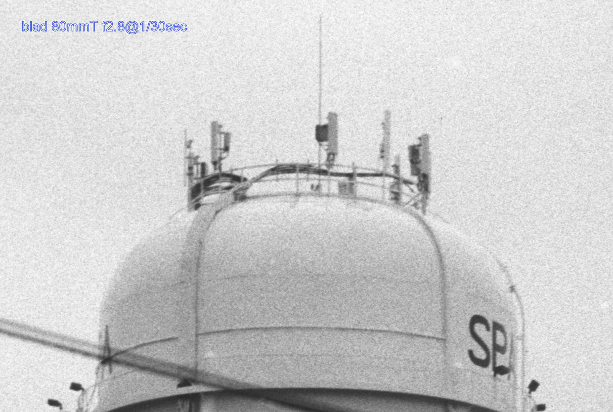

I haven't had issues with latest GP3. I also really like how GP3 looks, having scanned both on a Flextight 949, it appears that GP3 on my Sekor C 90mm actually resolves better than FP4+ with a higher resolving len in 35mm fwiw (in terms of lp/mm), but that's not my reason for shooting it.
I know I always post this sample, I need to go out and take some new stuff with it this weekend :smile:
What EI was working for you with Pyrocat-MC? What was your semi-stand routine? I bought some GP3 this week and will be using it to test some odds and ends systems and Pyrocat-MC is my main soup these days.

I used an incident reading set on EI 80, but conditions were not that great for shooting. It was raining lightly and dark enough out that the cars had their headlights on, but the shots still came out very good I think. For the development I used Pyrocat-MC 1.5 parts A, 1 part B to 150 distilled water with a 5 min. presoak at 68 degrees for 45 minutes. Agitated 1 minute at the start and the two more times evenly divided. I'm going to refine this a little more when I shoot an average scene. I'm also going to try a roll with normal development in Pyrocat-MC to see how that goes. I'll add some shots of the scene and some 100% blowups scanned straight with no sharpening or curves added a little later. John W
