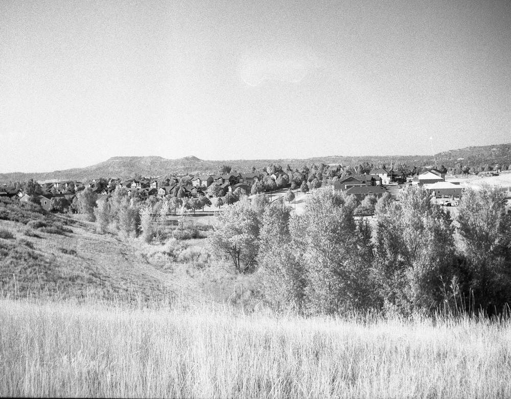

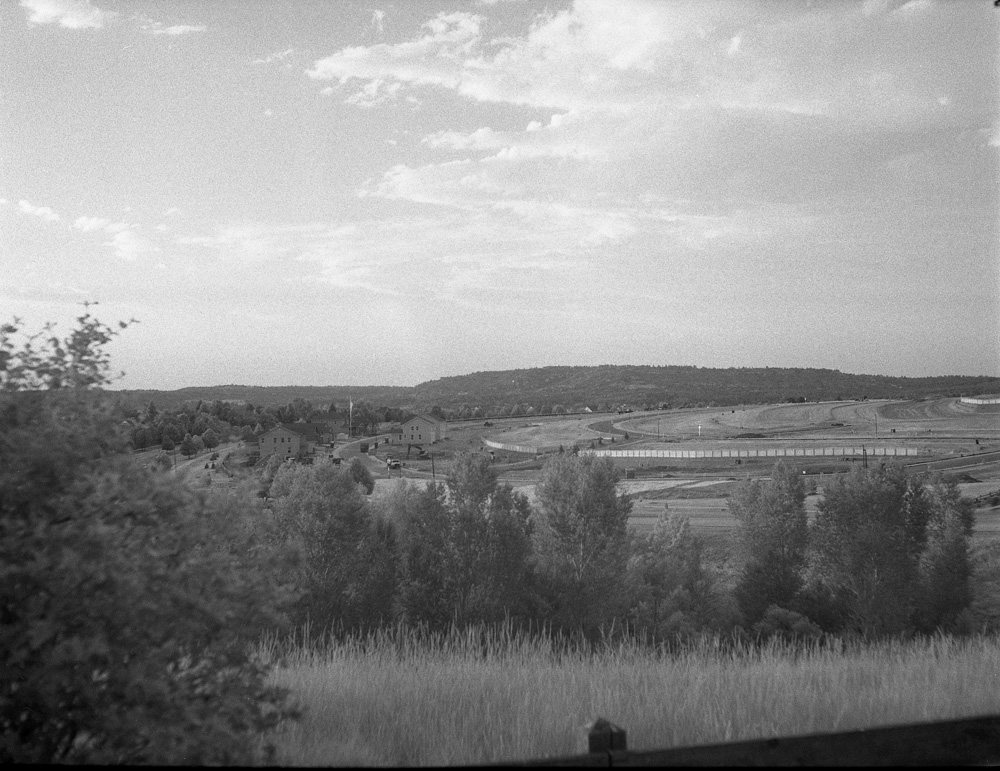

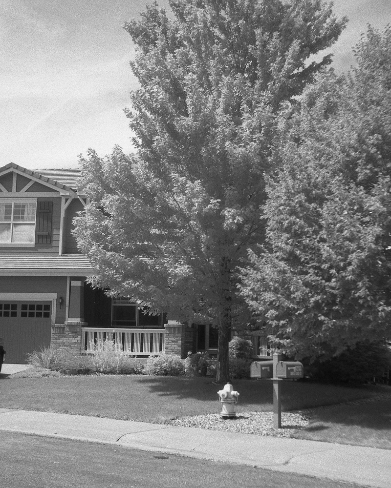

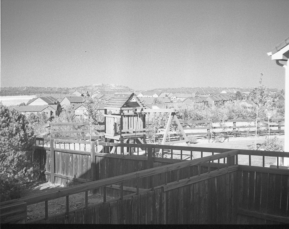

To hopefully rescue this thread from my own hand, here are some shots from my 2nd roll. It's from a different camera, but was processed along with the roll that came out so badly. 1937 Zeiss 531 tessar 6x4.5, D-76 1:1 at 60F.
Out our bedroom window:
It can be milder and have a lot less grain. Next door neighbor's maple tree:
Somebody mentioned it loves lots of sunlight:
Nearly the same scene with more clouds:

Very pretty but the IR effect is subtle if present at all. Love the Tessar!
