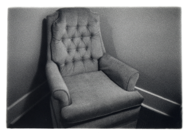

Just, as an illustration, two immages : SFX 200 in X-TOL and APX 400 in Rodinal 1+50.
