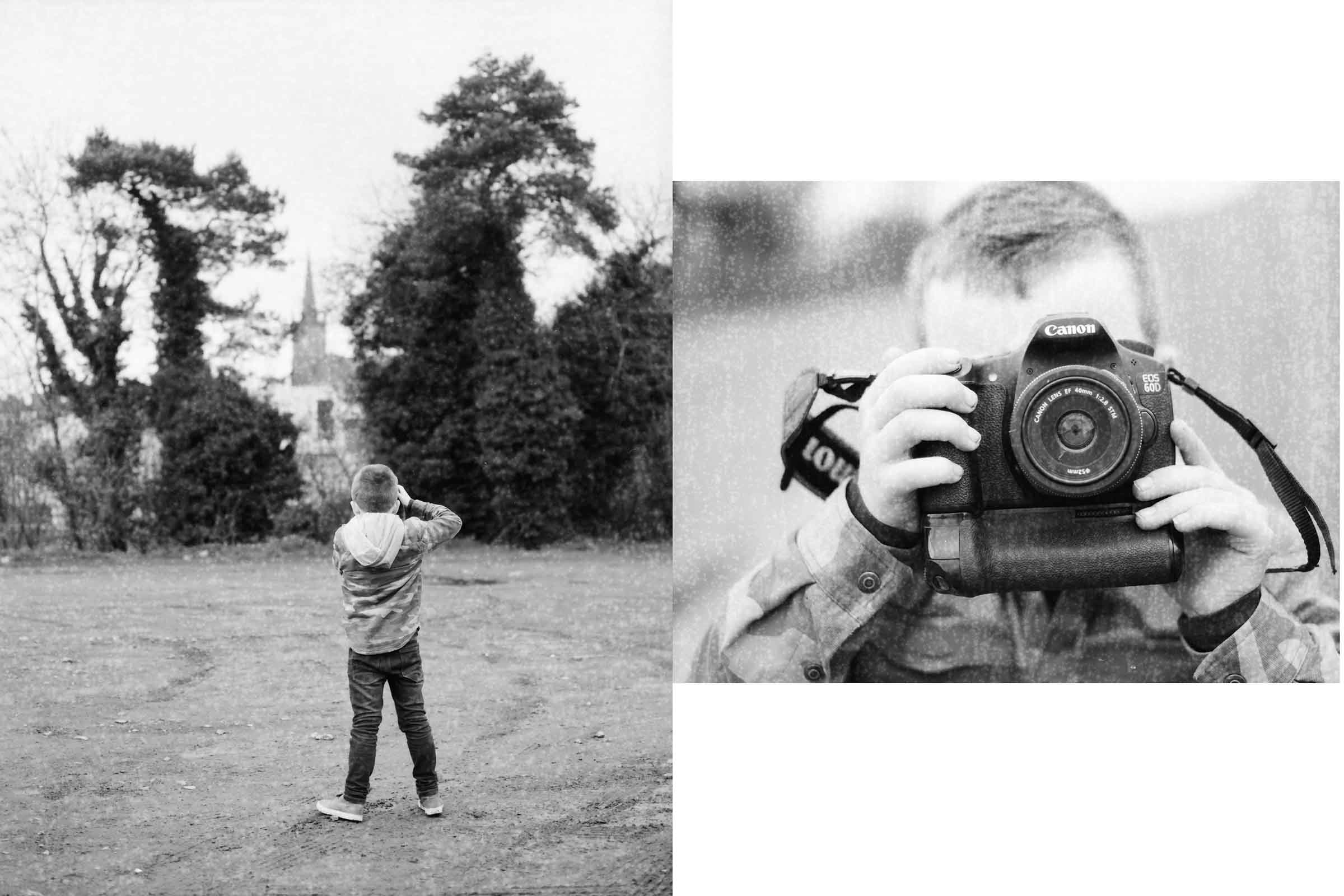

Hi Guys,
Ilford SFX 200.
Fist post for me, thanks for accepting me.
The attached image was shot on a hasselblad H1 and developed in 1D-11 for 10mins as suggested. Rinsed as per normal in tap water..fixed in ilford Fix and washed in photoflo using distilled water.
Any advice on what happened?
Thanks

Poor storage - likely from refrigeration or freezing & defrosting improperly. Has caused backing paper to stick to the film. Operator error in other words.

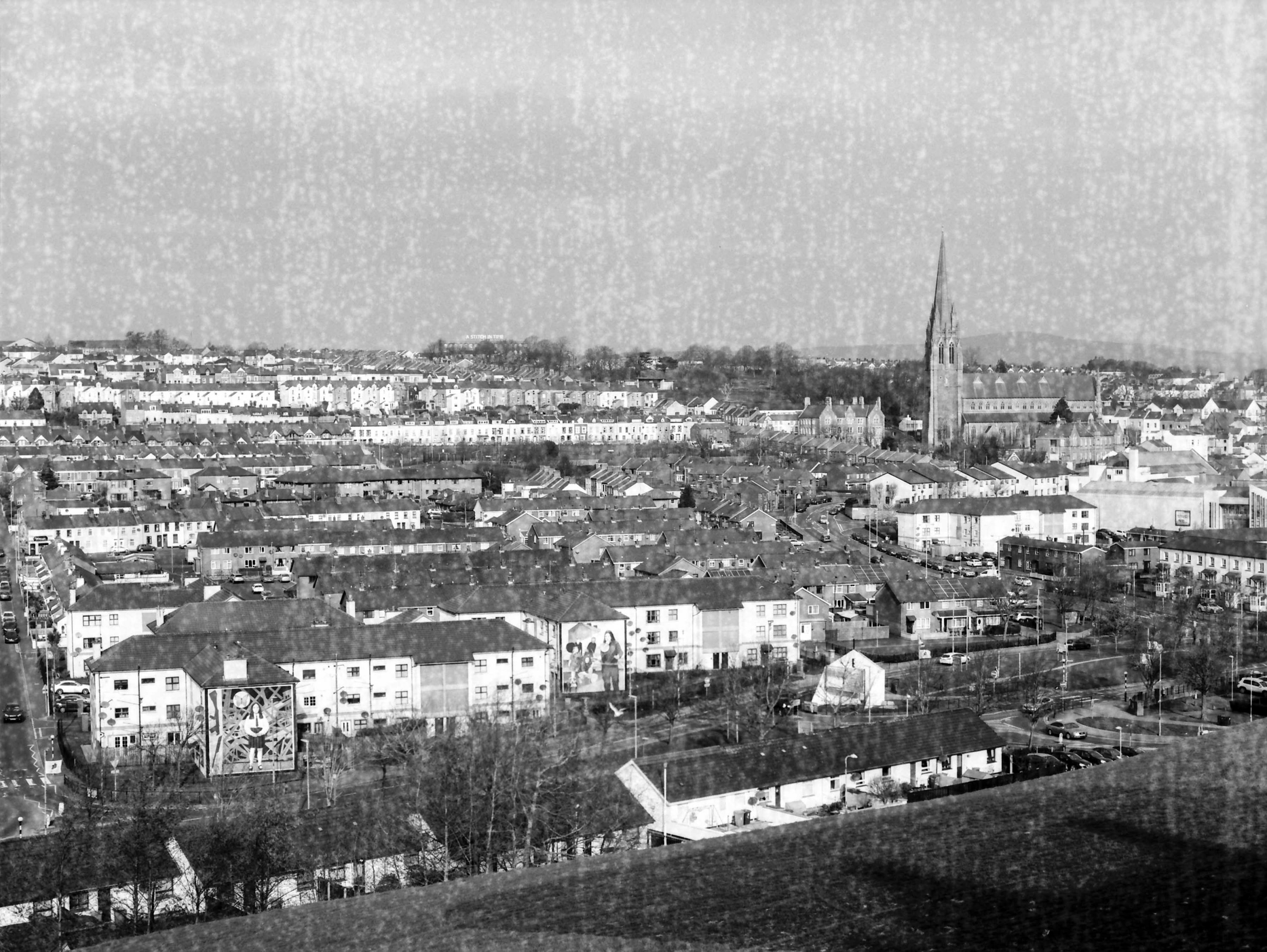

I bought this stock (10 rolls) off a supplier i have been using for a while. He stores his stock correctly and up to now iv had zero problems, This was never frozen or in fridge.All wrapping was intact and as it should be. Iv shot another roll from same batch with no issues, although i DID use Xtol for it. Both of these shots were 30mins apart one on the left looks considerably less noisy...

The mottling is present in both shots. It's visible in the sky in the left one, just not as obvious.

I have to ask. Can you see this on the film directly with a glass? Any chance this is from scanning?
Hi, no iv scanned loads since and before on this machine and no issues. Im scanning a few 35mm frames now that has been developed in the same ID-11 as the problem roll...will post results soon.
