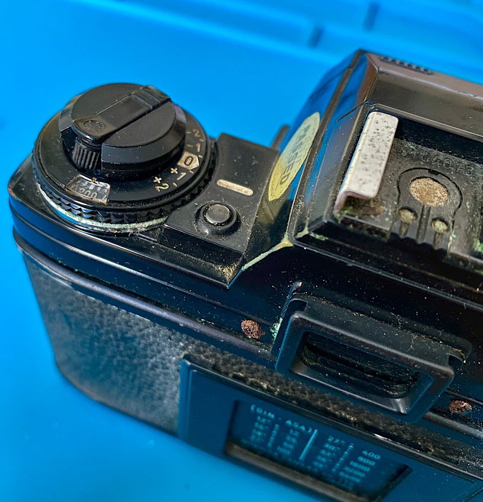

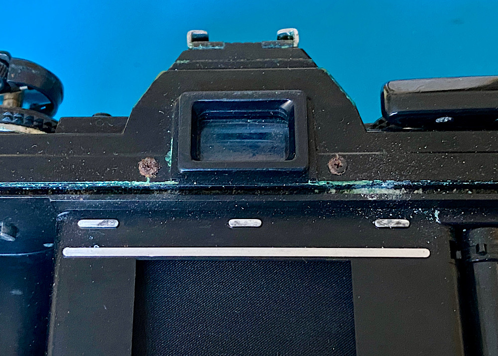

This is my Minolta X-700 that I recently restored. And the first camera on which I detected fungus.
If you look at the condition of the camera, this is not surprising; it was obviously stored in a damp place:
The fungus is on the mirror and was quickly removed.
I now understand why you suggest not discussing any further.
Bye.
Bye.
