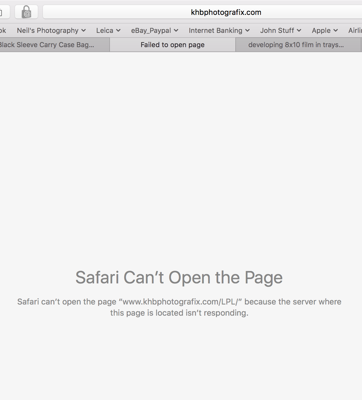

Matt
There website must be down as I keep getting this
MattKing
Apr 24, 2005
55,104
Delta, BC Canada
Try the home page: http://www.khbphotografix.com/
Also, try entering their address manually into your browser, because APUG has a built in link processor that sometimes acts up.
EDIT: both addresses work for me in both Chrome and Opera, but they may be well and truly cached on my system.
