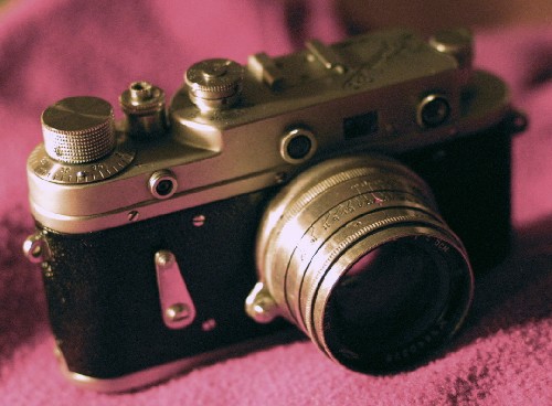

Just received my first forray into FSU rangefinderography. It's christmas in April!
I got a very shiny, excellent condition, Zorki-2S and a Jupiter-8 made in '56 and '58 respectively. (digicam snap attached)
I'm slowly trying to learn the technique of loading the camera, and doing so without having to re-cut the leader. I think I've got the concept right in my head, I just have to translate that to my fingers.
After loading the camera, though, I'm a bit at a loss as to how I'm supposed to set the film counter to zero, or 38 or something that will put me at 1 after I advance the film 2-3 frames.
Sage advice from fellow travelers on the FSU rangefinder highway?

Boy, do I feel like an idiot.
THere are two tiny stubbs on the numbered counter ring around the film advance knob. Those are for rotating the counter ring to point to the desired number.
yeesh. :smile:
