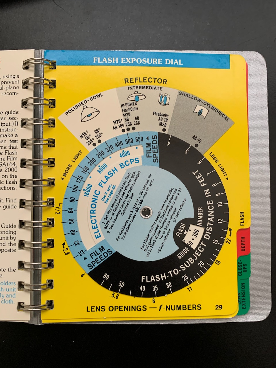

One of the best tools for using flash bulbs is the calculator dial in older Kodak Master Photoguides. I think the 1981 edition may have been the last to include bulbs. And it only includes blue bulbs so to use a plain bulb a 1-stop compensation must be used.

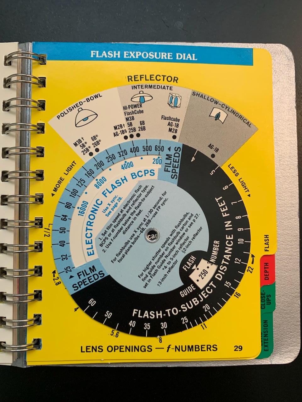

Assuming that you are using a plain (not blue) bulb and a Graflite 4-inch reflector… read the black part of this calculator (flash to subject distance) to get an idea of an appropriate aperture. This is not compensated for faster shutter speed so use 1/50 or slower.

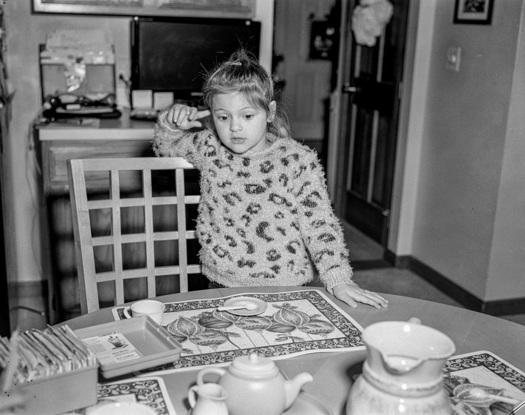

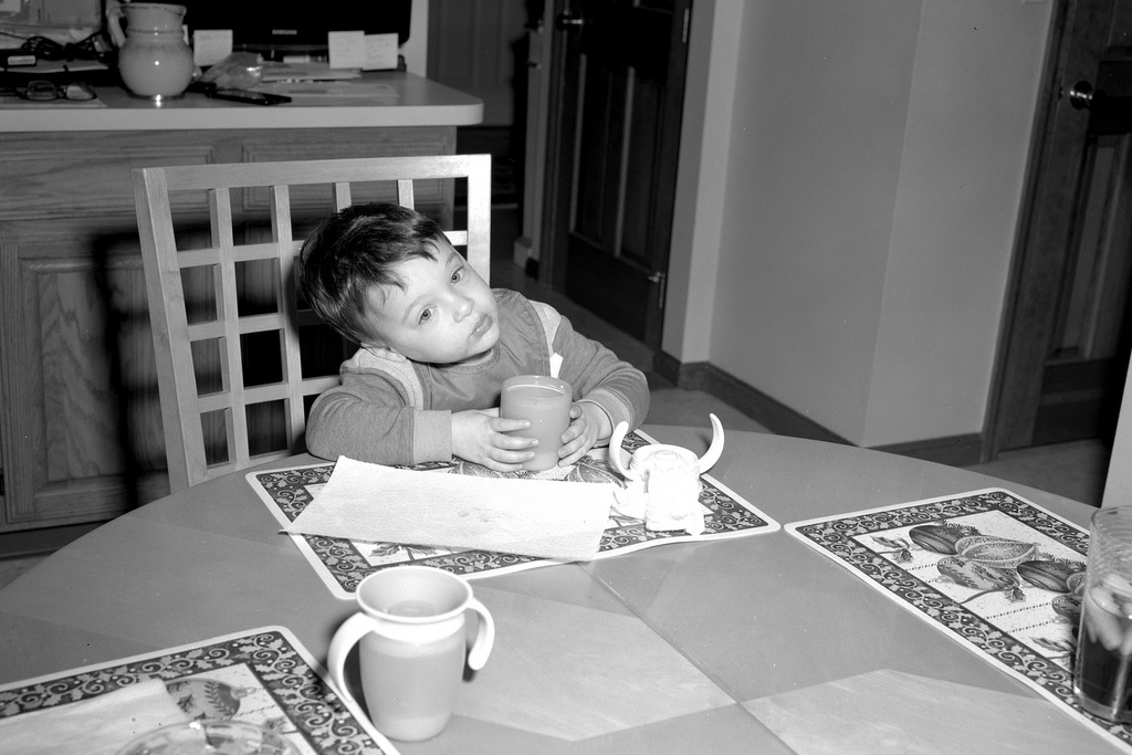

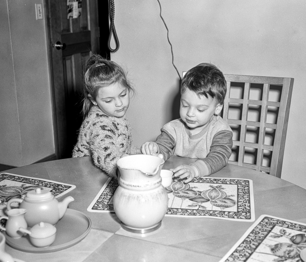

Here are the results. Quick edits which I am not that great at. Shot at f11,16 and 22. I believe the first one is at f11. All shot about 5 feet at 1/100th.
Well I'm surprised. Those are pretty good. I was expecting them to be exceedingly overexposed.
Cute children!
HP5 can take a lot of extra exposure. Those would probably take a while to print under the enlarger, but they're still on the straight-line part of the curve, it seems.
